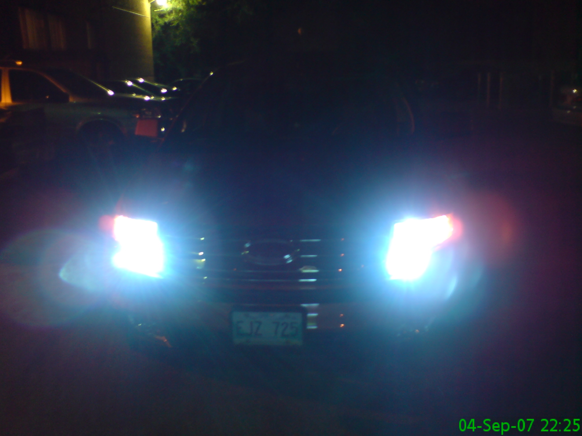

PrinzII Posted August 6, 2009 Report Share Posted August 6, 2009 Hi guys:Is anyone can give me some idea about install Hid Xenon headlight for Edge? Is that will cuz any problem for warranty? I want to change low beam and high beam,are these will cuz any problem with battery, alternator or other things? Thanks! Fly, I'll let the pictures do the talking.... If you decide to get a kit, make sure the ballasts are digital. Vendor on this forum: http://www.fordedgeforum.com/index.php?sho...amp;hl=HID+Kits Quote Link to comment Share on other sites More sharing options...

PrinzII Posted September 2, 2009 Report Share Posted September 2, 2009 Prinz , Any flicker or bow issues? Negative on both counts. I have had them on mine since March of 2008 and no vehicle related issues whatsoever. However, I did my homework on this forum before pulling the trigger on this modification because I did not want any warranty issues. As long as the ballasts are digital (mine are), you should not have any flickering. there is a vendor on this forum which sells a kit with a digital ballast for a pretty reasonable price. I believe it's Resto Solutions. Quote Link to comment Share on other sites More sharing options...
PrinzII Posted September 2, 2009 Report Share Posted September 2, 2009 Just curious, what are 'bow' issues?I have a set installed for low beams. Is there any point to doing high beams? Most of the time I have to turn them on and off quite a bit due to oncoming traffic. Not good for the ballasts and often times, they wouldn't even have time to charge up to full brightness. How does one get around that? That's a tradeoff. I had to learn not to use them for that anymore because I did not want to wreck my bulbs and/or ballast. However, it's a tradeoff I can live with because I have much better visibility on dark AZ roads. Quote Link to comment Share on other sites More sharing options...
