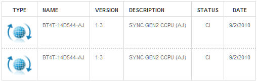

francois.nc Posted November 2, 2010 Report Share Posted November 2, 2010 A few weeks ago, SyncMyRide had the software available for me to load it onto a USB drive. I used it twice to "update" my system. They have since taken it down and now they have what they call "status checker". I've installed that once (and uploaded the results). I wonder if the process of installing the software from a USB is in essence rebooting the system. It's sure a bunch easier than pulling the fuse. Have you looked at you sync install history lately? I wonder if the dealership's update shows up. Attached is what my history shows. I installed the status checker on 10/19 and the car was built 9/8 Wilson you mention you updated twice, however it doesn't appear in your sync history does it? Here is mine, I know I tried the Status Checker, it must of been on the 21st, I took delivery on the 16th. Quote Link to comment Share on other sites More sharing options...
wilsons66604 Posted November 2, 2010 Report Share Posted November 2, 2010 (edited) Wilson you mention you updated twice, however it doesn't appear in your sync history does it? Right. My first two updates would not allow me to upload the status to SyncMyRide. Since then, they replaced the 1.3 software with this status checker. Edited November 2, 2010 by wilsons66604 Quote Link to comment Share on other sites More sharing options...
revOevoM Posted November 2, 2010 Report Share Posted November 2, 2010 Only thing in my history is the initial install. Note Edge was built on 9/1. Quote Link to comment Share on other sites More sharing options...
wilsons66604 Posted November 2, 2010 Report Share Posted November 2, 2010 Only thing in my history is the initial install. Note Edge was built on 9/1. Hmmm. I wonder if the dealer just pulled Fuse 29? I guess Sync would be one of the last things to install thus the 9/1 9/2 dates. Quote Link to comment Share on other sites More sharing options...
revOevoM Posted November 2, 2010 Report Share Posted November 2, 2010 Hmmm. I wonder if the dealer just pulled Fuse 29? I guess Sync would be one of the last things to install thus the 9/1 9/2 dates. I'm pretty sure he didn't just pull the fuse. I mentioned that. He suggested to try this: disconnect the battery cable. While disconnected, turn on the lights or some other electrical function. That'll drain everything currently residing in the system. Reconnect and see if that remedies the issue. Interesting. Basically may be a "Fuse 29 + all the rest" reset. Quote Link to comment Share on other sites More sharing options...
