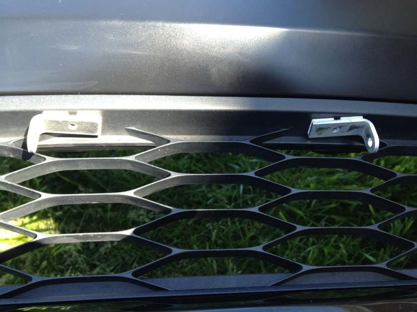

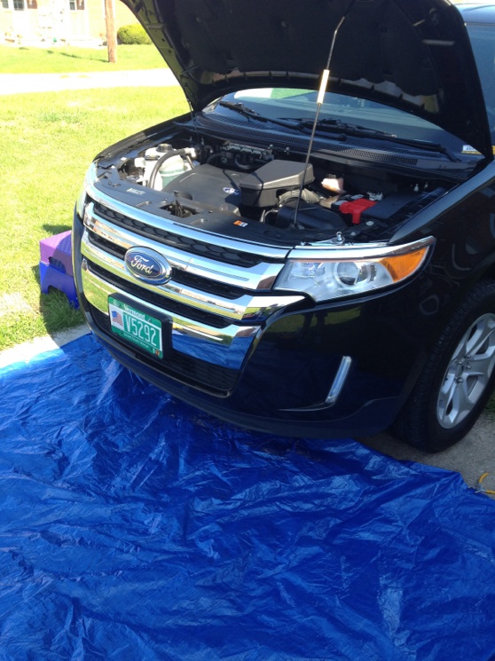

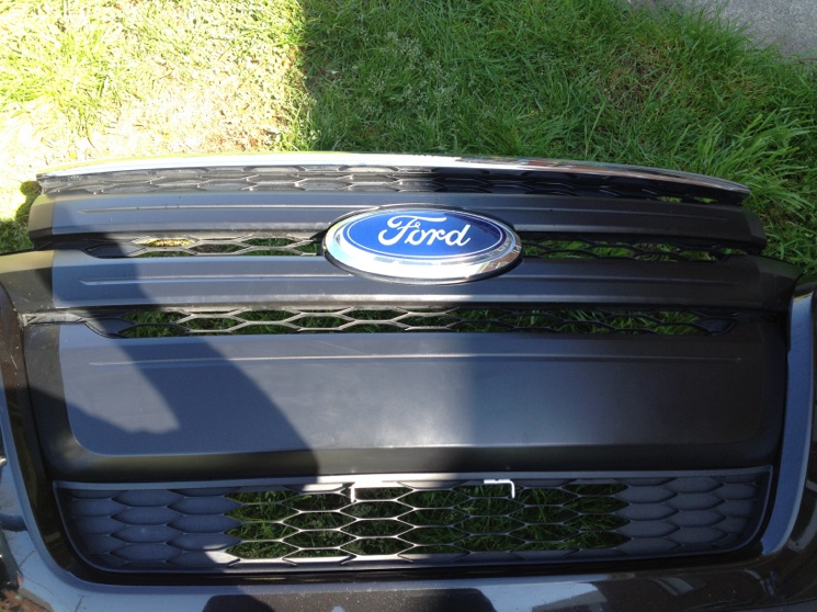

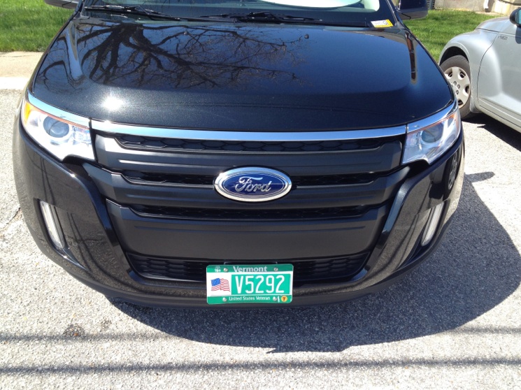

lightning4eva Posted March 19, 2012 Report Share Posted March 19, 2012 First real post besides saying what I paid for my Edge. Not a fan of a lot of Chrome so I got the grill from partscheap.com. I'd hate to ruin a perfectly good bumper in case I ever moved to a state where the front license plate is not required. So here are a few pics of my morning. Getting the front bumper was pretty easy once you found all the screws that needed to come off. Also not forgetting to disconnect the "fog light" wire. I would recommend undoing the 7 (?) screws under the bumber first, the 3 in each wheel well, then to the top where there are 4 plastic screws and 2 (10mm) bolts. Then just be gentle and pull forward a little at a time. 2 hours total from start to finish to include taking my time with the license plate bracket which I got from http://skenedesign.com for $50 Enjoy 3 Quote Link to comment Share on other sites More sharing options...

MickeyCondon Posted April 6, 2012 Report Share Posted April 6, 2012 UPDATE: Had the new grill on for about 1600 miles w/OUT painting it (as is from partscheap.com) and there are no issues to speak of. I was worried about bugs being on the grill for a few days after the fiances trip north till the time I had to wash the car. No issues what so ever. Thinking about vinyling the top piece of chrome at the moment and if I do I might do the inner door handles. Thinking about the plastidip for the exterior door handles and the badges. Quote Link to comment Share on other sites More sharing options...
