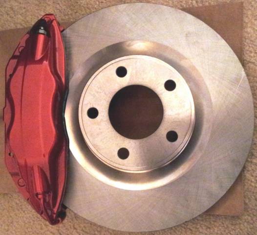

Sam I Am Posted March 24, 2012 Report Share Posted March 24, 2012 Picked up the calipers from the powder coaters today and man do I love the way they came out. I had them color matched to the Copper of the Edge and he did a wonderful job on them. I also think I have picked out the new wheels I am going to use. I test fit the AWD rotor today and it was too small, where the Shelby rotor was a hair too large. We are back to test fitting other rotors. I am planning on spending more time on it this weekend. Here are some of the pictures. He did an awesome job with the powdercoat, wheels look great too. I hope you finally find the right rotor to get it to work. Quote Link to comment Share on other sites More sharing options...
livinonthedge Posted March 25, 2012 Author Report Share Posted March 25, 2012 After trial and error after trial and error we stepped back from this project and are going after it a different way. The Stock EVO rotor is 320mm as is the stock Edge AWD rotor. So in using that number we are going to stay with the Edge AWD Caliper and cnc a special bracket to relocate the caliper. We were so stoked about the caliper lining right up with the stock spindle that we closed our minds to other options, and its a lot less expensive and time consuming to go this route. I am fabbing up a template to have machined this week. Lets see how that goes. Here is what the stock AWD rotor and the caliper looks like while its sitting the way it is intended. Quote Link to comment Share on other sites More sharing options...
