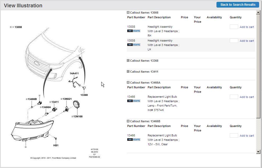

Sade2000 Posted February 28, 2012 Report Share Posted February 28, 2012 (edited) Hi out there, while preparing the registration of my new 2012 here in Germany, I found out that there ´re different headlamps avaible vor the 2011/2012 Ford Edge. I have to make sure that the Edge Headlights will meet german regularies (which is nearly impossible) I knew that there ´re three different types of headlights avaible: Halogen "standard" Halogen "Sport" HID I also read in this forum, that the halogen and HID headlights seem to be the same (Ford part numbers), but are at least different in the projector, so that you re not able to put a halogen bulb in the HID housing (correct me if I´m wrong ´cause this is very important for my registration) Now i found another headlight called "Level 3 Headlamp" at the Ford Website for the 2012 Ford Edge Limited (see attached file) You can purchase them here: http://www.parts.com/parts/2011/FORD/EDGE/LIMITED/?siteid=2&vehicleid=1446671§ion=ELECTRICAL&group=CHASSIS%20ELECTRICAL&subgroup=HEADLAMPS Now im totally confused Are this ones only for export, ´cause of the additional third white lamp in the inner housing for use as a parking light? (That is somehting we need here in Germany) Hope someone can bring light into this. :tumbleweed: Thx Edited February 28, 2012 by Sade2000 Quote Link to comment Share on other sites More sharing options...
e350 coupe Posted February 28, 2012 Report Share Posted February 28, 2012 I do not know about the level 3 headlights, but I think the differences are as follows. 1. US model Halogen with no DRL mode. (no extra bulb) 2. Canadian Halogen with DRL as reduced low beam voltage. (no extra bulb) 3. US HID with no DRL (no extra bulb as DRL are not required in US) 4. Canadian HID with DRL which has extra yellow bulb and is used to operate as DRL function as you cannot reduce voltage to HID's as you can with Halogen type bulbs. I think what you are probably looking for is the Canadian HID model as it has the extra yellow bulb which operates as the DRL function in Canada. Quote Link to comment Share on other sites More sharing options...
