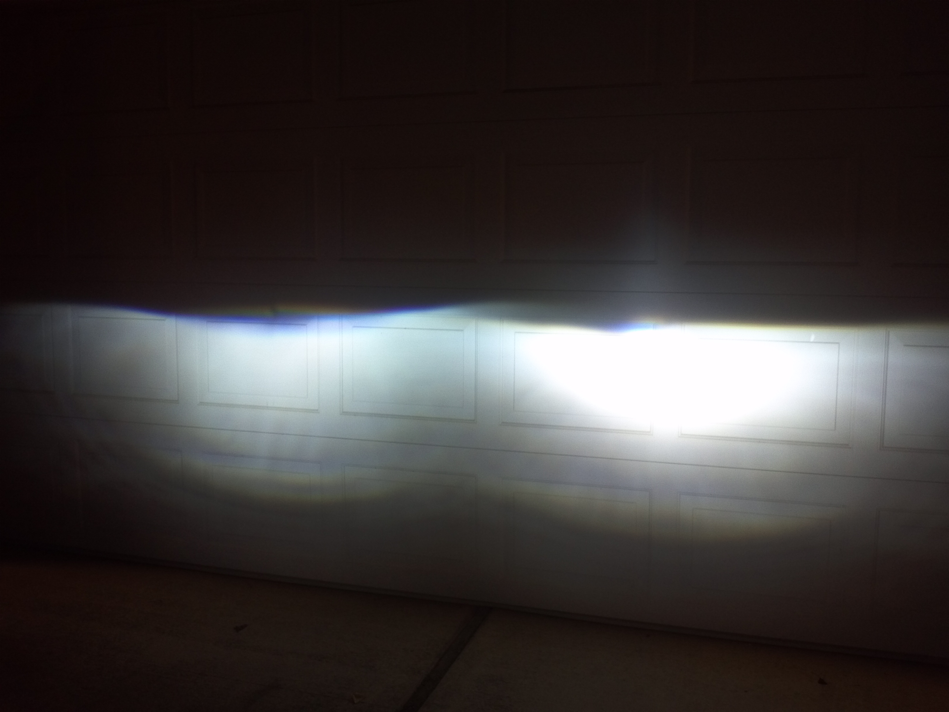

somejohnblaze Posted February 22, 2012 Report Share Posted February 22, 2012 Finally got my hid kit installed. Everything worked great except my beam pattern seems off. It doesn't seem to light up the road quite as much as I thought. Here is a pic of my beam pattern but it is from a slight incline on my drive way. http://36ohk6dgmcd1n-c.c.yom.mail.yahoo.net/om/api/1.0/openmail.app.invoke/36ohk6dgmcd1n/9/1.0.35/us/en-US/view.html/0# Quote Link to comment Share on other sites More sharing options...
somejohnblaze Posted February 22, 2012 Author Report Share Posted February 22, 2012 Here is a pic of my beam pattern. It seems like something is off. It does not seem to light up the road very much. I would appreciate any advice. Thanks. Now this is at a slight incline on a typical driveway. Quote Link to comment Share on other sites More sharing options...
somejohnblaze Posted February 23, 2012 Author Report Share Posted February 23, 2012 Yeah, I will be going out to my parents house this weekend. They have a nice long flat driveway. I will take some more pics and post and try to adjust them then. Quote Link to comment Share on other sites More sharing options...

somejohnblaze Posted February 27, 2012 Author Report Share Posted February 27, 2012 Sam, ok I know exactly what you are talking about the relay harness going to the battery. I did end up getting the beam pattern much better. I just had to keep adjusting the headlights until I could get a good amount of forward lighting with out blinding on coming traffic. I think my beam pattern looks really bad in those pics because I was on an incline. Now that I got everything set correctly they look great. They were still a pain to get in though and the 9006 bulbs were not so easily installed like many members mentioned. Quote Link to comment Share on other sites More sharing options...
