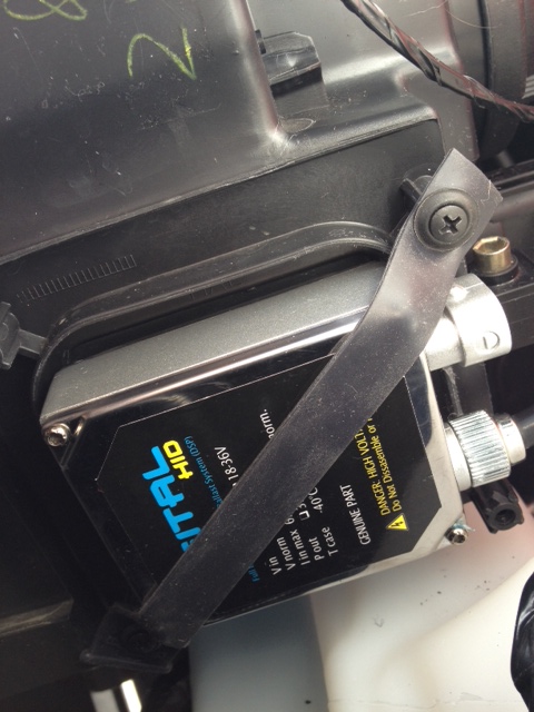

2. I took the advice of one of the other members from another post who suggested mounting the ballasts on the sides of the headlight enclosures where the OEM ballasts would be mounted. They fit nicely with a little bit of Dremel work, sanding down the lip on headlight enclosure side where the ballast plug and wire come from and also sanding down the 2 little nipples in the center of the mounting areas so that the ballasts would lay flush. Then I used industrial strength Velcro to mount them and secured them in by strapping it down with a couple rubber straps taken from Dell laptop power cords that you use to wrap up them up. Attached are some pictures that will help better show the install of the ballasts.

Raider off the top of your head do you know the bolt/screw sizes for the OEM ballasts holes you used for your rubber strops? Or were they just plastic and you re-threaded them. Also the size of the hole to drill into the back of the caps?! Thanks
The OEM mounting points are not threaded, just drilled, so you can just use an appropriate screw to mount the straps.
I think I posted this elsewhere, but here's another easy way to mount the ballasts. Drill a hole through the top and bottom flanges of the OEM HID mount and slip a cable tie through it. Position the ballast and tighten the cable tie around it.
For the caps you will need to drill a 1" hole. The screws I used were from Lowes in the Automotive Screws section of Hardware. The size is #10 x 3/4". You could probably even use #10 x 1/2". And like Dr. Edge stated in his post, these are not threaded so there are a lot of options. I like the the ones I used because they were blak and had that built it washer/head. I hope this helps. Good luck with your install.

Painstakingly went for the factory 5/16" ground screws below each headlight. The drivers side was much easier removing the air box, but the passenger side was a :censored: . Thanks everyone for the help, got the screws at lowes and also got 1/8" rubber sheet to cut strips similar to the Dell strips. Plan on using industrial strength velcro on the backs of the ballasts and strap them in just in case. Everything fired up great and the 5000k looks spot on with the LED bars. Did anyone else has a pain trying to align the bulbs? I compared the stock alignment to the bulbs that came with the kit and had the proper orientation, but man it was a lot harder then I expected. All in all great kit. :rockon:
