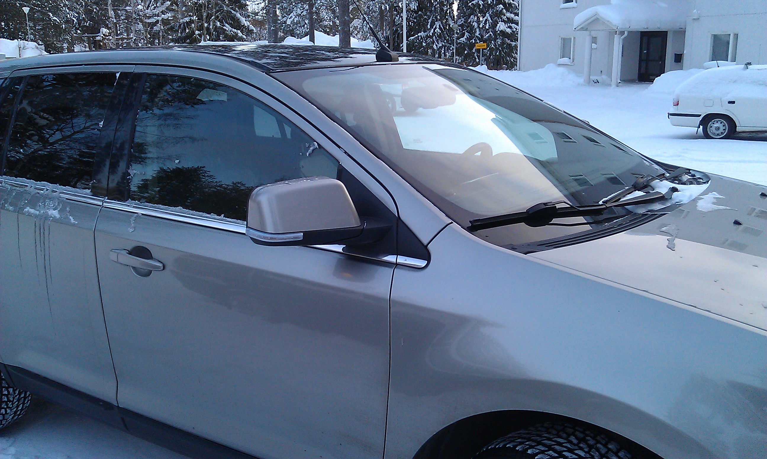

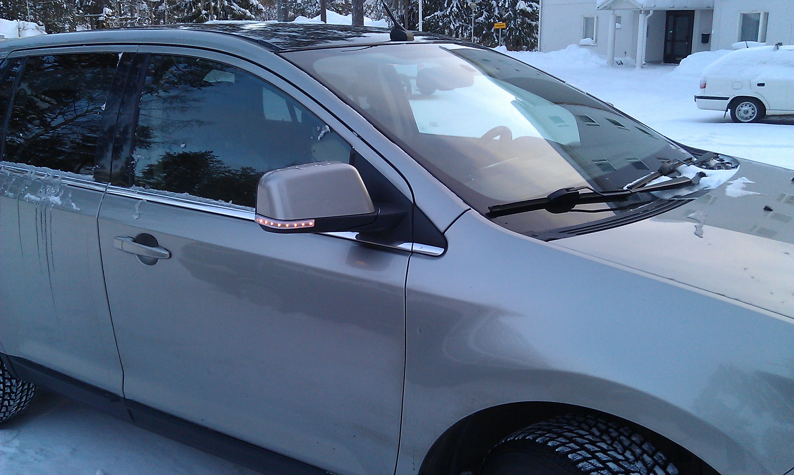

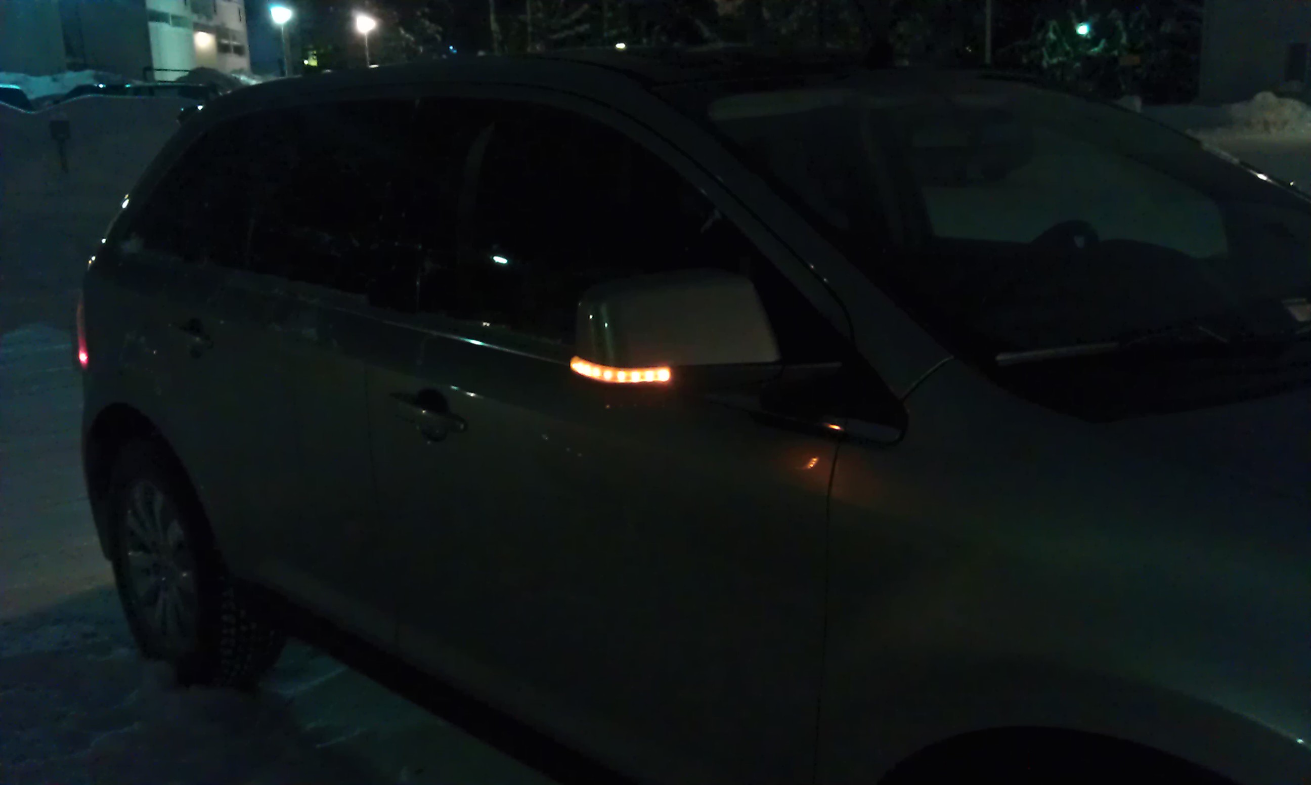

frozennuts Posted February 13, 2012 Report Share Posted February 13, 2012 Here are some pictures of the door mirror lights from http://www.cbsonline.co.uk/product/Stick_On_Amber_LED_Indicator_Pair_LEDA9 I think the 2012 production units are the best choice but this is by far a much cheaper option. 1 Quote Link to comment Share on other sites More sharing options...
JOEHIO Posted February 14, 2012 Report Share Posted February 14, 2012 Hey Frozennuts, they really look great, thanks for posting the pics. will try and order these, as I'm thinking about them for my wife's '09 MKS. Joe Quote Link to comment Share on other sites More sharing options...
