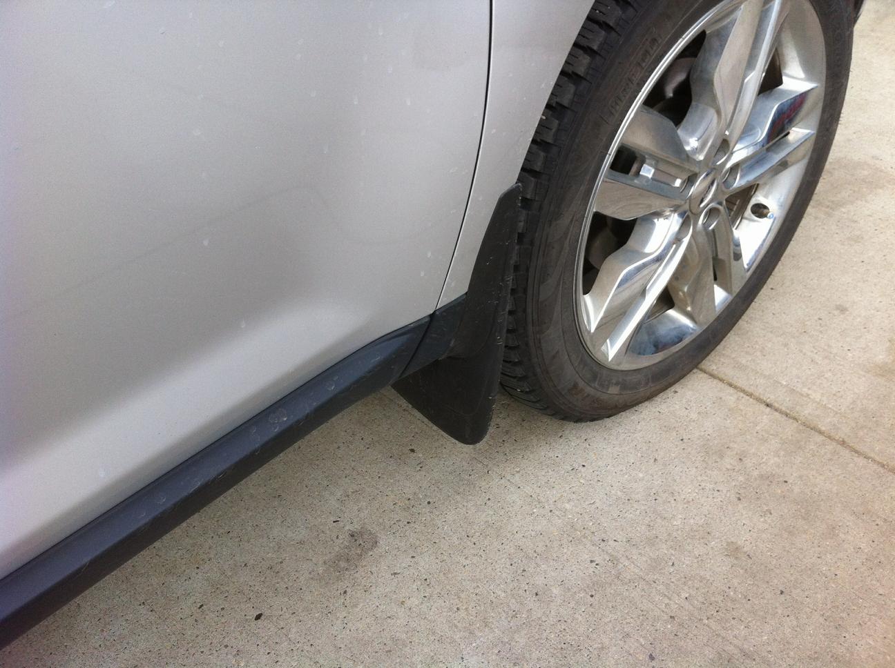

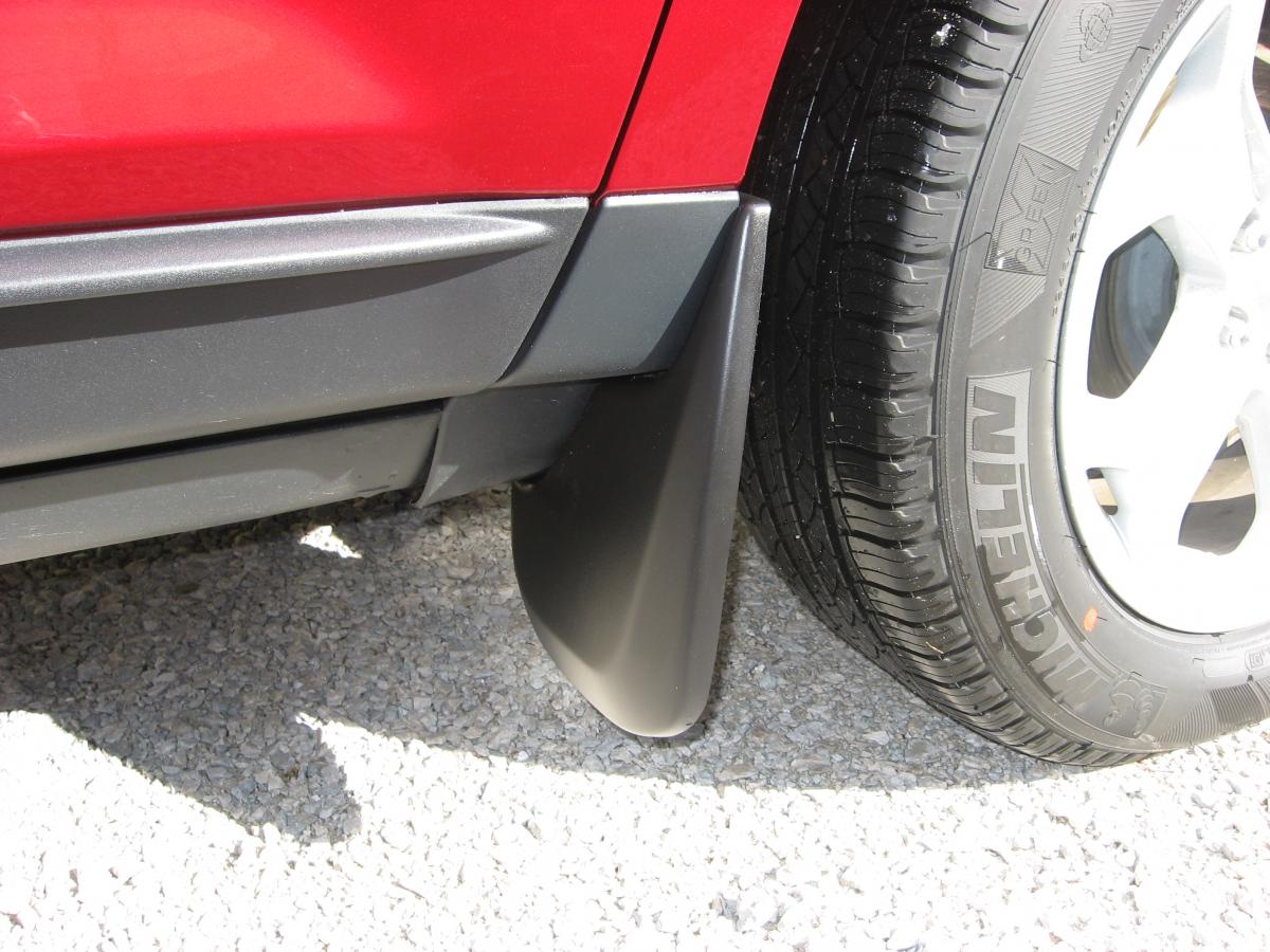

Spaceman Spiff Posted March 16, 2012 Author Report Share Posted March 16, 2012 (edited) Finally got around to installing splash guards. They need minor cutting and one hole drilled. I got them at CDN Tire. Spiff Edited March 16, 2012 by Spaceman Spiff Quote Link to comment Share on other sites More sharing options...
JOEHIO Posted March 16, 2012 Report Share Posted March 16, 2012 Looking good, gotta get me some. Quote Link to comment Share on other sites More sharing options...

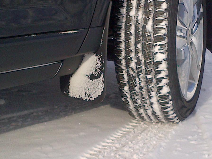

JRR-Edge Posted March 10, 2013 Report Share Posted March 10, 2013 I put on the Ford OEM front splash guards today. I made a few modifications, but they turned out looking great. I made a template out of cardboard, trimming around the wheel well obstacles and utilized the (2) existing screws, the one marked "E" on the instructions and the one secures the rocker panel. Then I only drilled one new hole to secure the upper portion of the splash guard (vs. the (2) per the instructions). Quote Link to comment Share on other sites More sharing options...

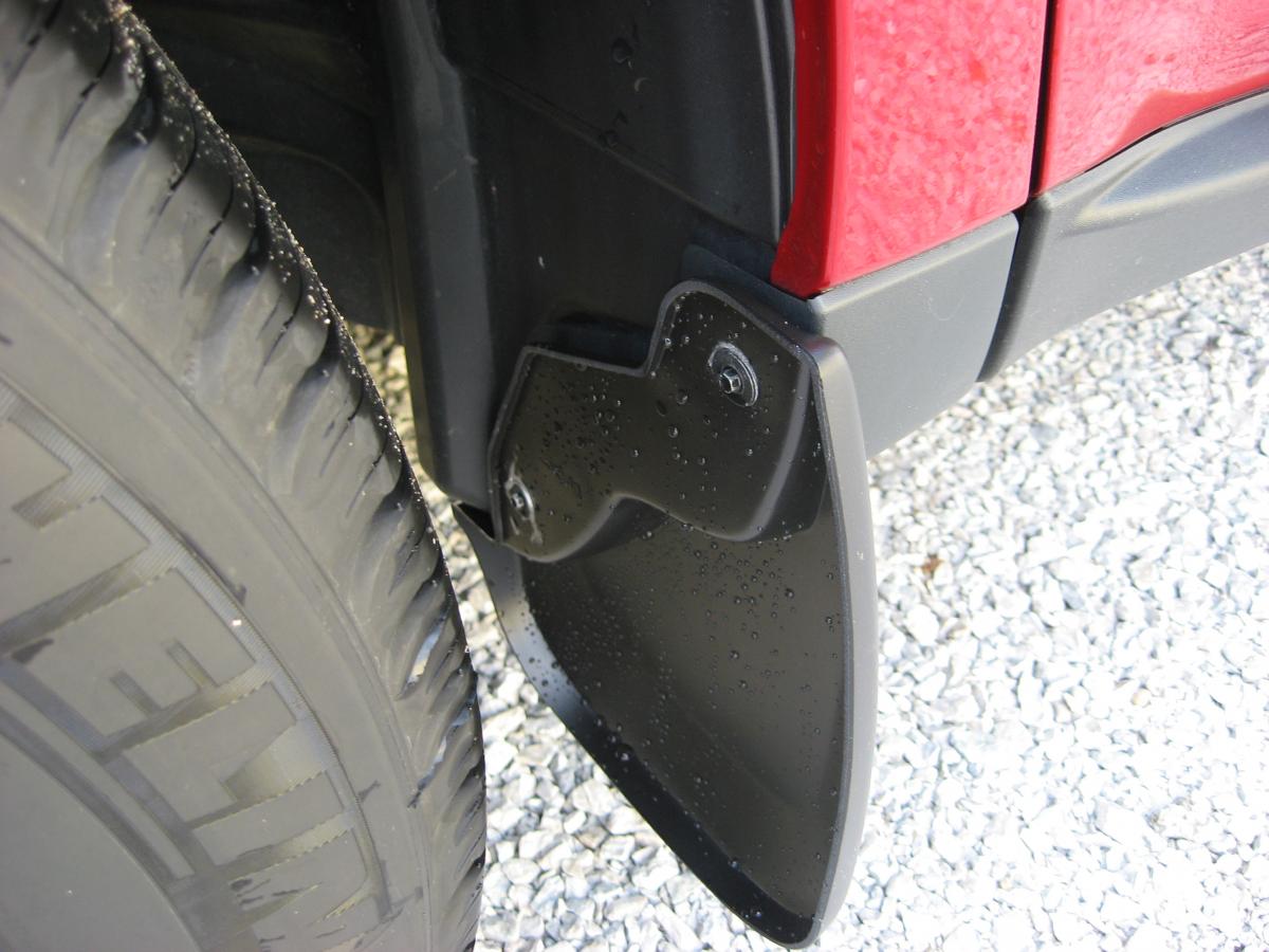

Larry Posted March 22, 2013 Report Share Posted March 22, 2013 I purchased huskyliner brand splashguards. Go to huskyliner.com . Use the existing screws. $40.00 I attached pics of guards installed. Larry Northern,In Quote Link to comment Share on other sites More sharing options...
fishx65 Posted March 22, 2013 Report Share Posted March 22, 2013 The Huskys look good but I'm not to crazy about them sticking out toward the tire on top. The cheap flat ones seem to blend in better and do the same job. I tried two different flat pairs and the Highlands look the best in my opinion. I think they are around $7.00 a pair. Quote Link to comment Share on other sites More sharing options...

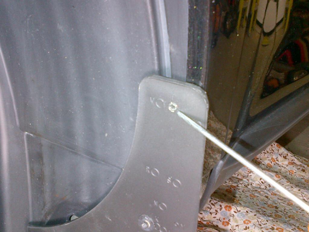

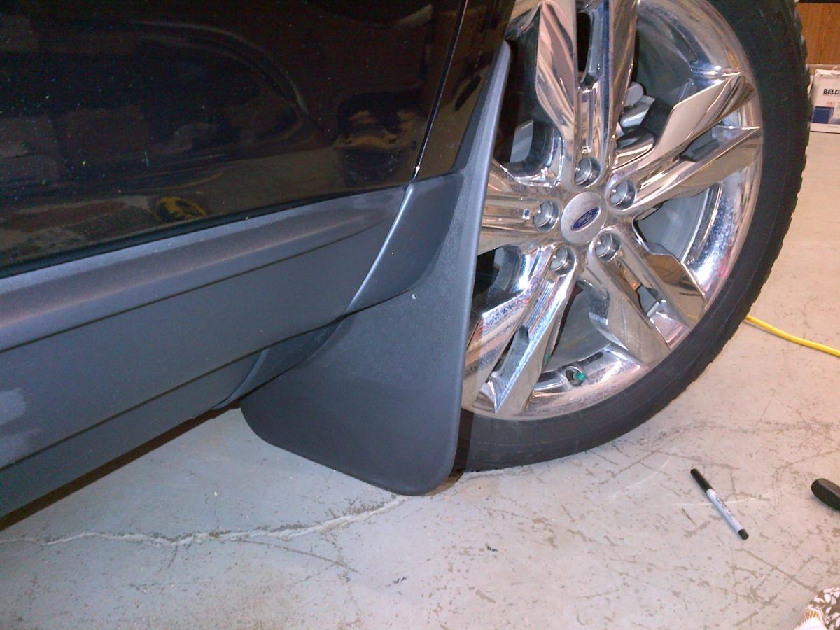

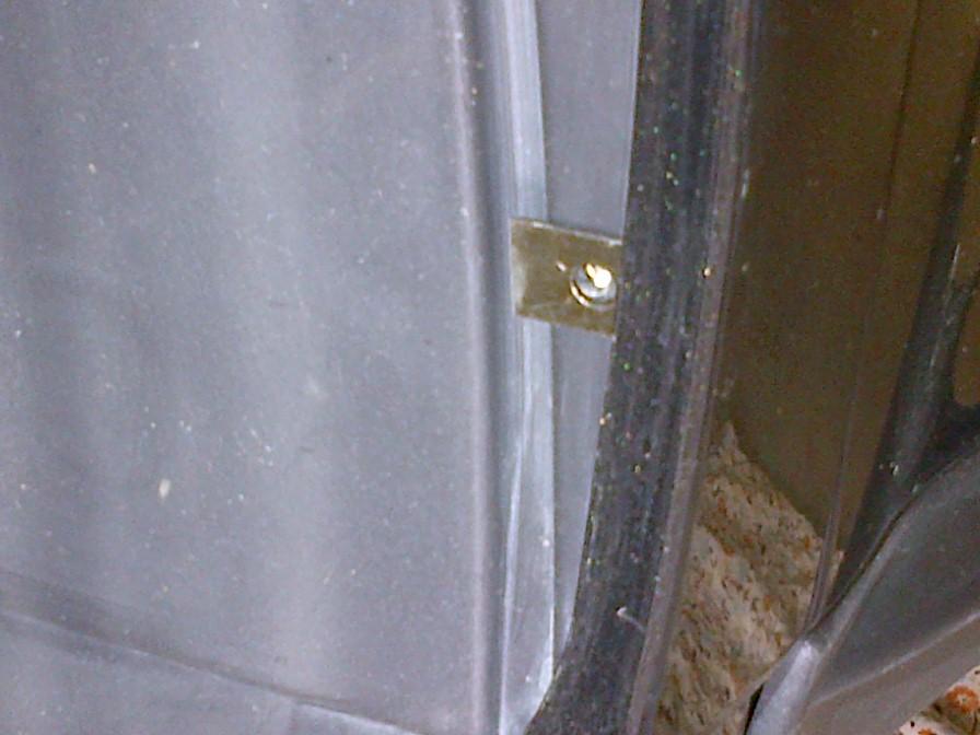

normcloutier Posted March 23, 2013 Report Share Posted March 23, 2013 (edited) I installed the flat Ford ones on my 13 SEL and they look pretty good. I didn't want to drill any holes in the metal so I opened up the wheel well and used one of the extra clips that came with the kit to attach the 3rd screw to the wheel well liner. I also trimmed the guard so it sits flat. Edited March 23, 2013 by normcloutier Quote Link to comment Share on other sites More sharing options...
normcloutier Posted March 23, 2013 Report Share Posted March 23, 2013 Here are some pics. The top screw is attached to a clip installed on the liner, not drilled into metal. 1 Quote Link to comment Share on other sites More sharing options...
