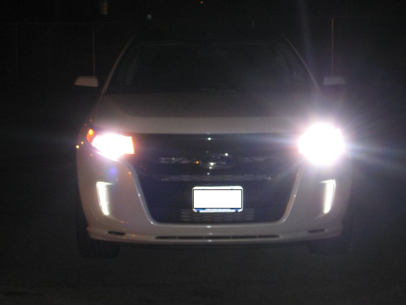

nitrocs Posted January 10, 2012 Author Report Share Posted January 10, 2012 Photos to document the job: DS Ballast - drivers side ballast mounted on OEM intake bolt & relay mounted on adjacent bolt (used an old nut leftover from my 1994 Taurus SHO ironically...) PS Ballast - passenger side ballast mounted on OEM radiator overflow tank bolt Bay - shows non intrusive locations of ballasts Beam - beam pattern from ~10ft Lens - the location of my "light leak" Head on - looking good! Thanks RetroSolutions! Quote Link to comment Share on other sites More sharing options...

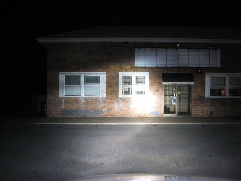

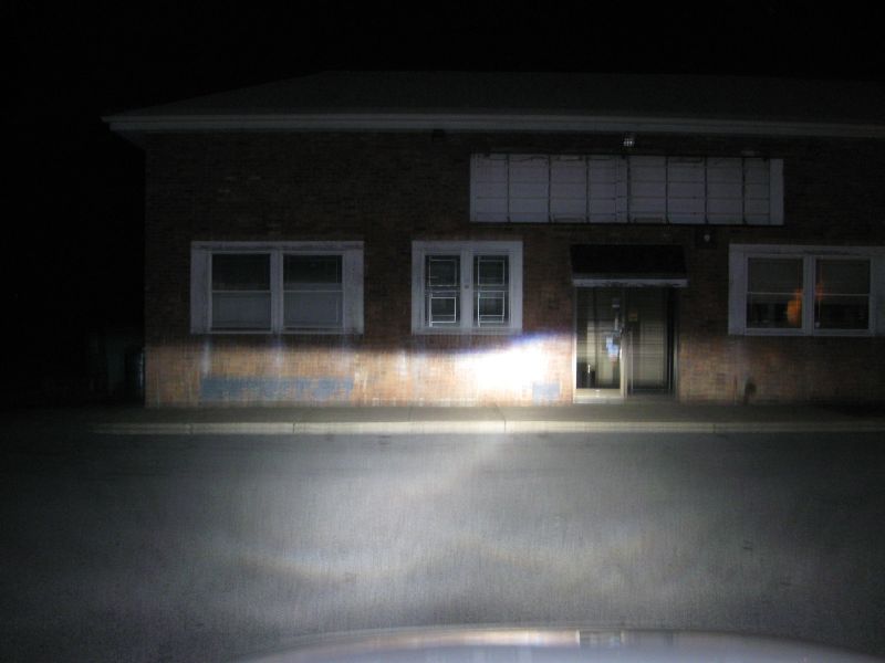

nitrocs Posted January 26, 2012 Author Report Share Posted January 26, 2012 Hi nitrocs, Please could you post some pictures for your new HID light output on the roads (nighttime). Thanks in advance. :D Sorry for taking a while to get these on here....its difficult to take pictures when youre the only one in the car! The first couple are taken at twilight against the side of my house (~25ft away) #4 is with high beams from same position The last is taken while driving at night on a "dark" road LMK if you'd like to see any more Quote Link to comment Share on other sites More sharing options...
