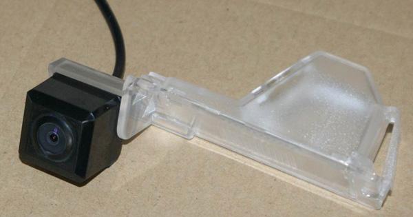

rcbbdl1 Posted December 29, 2011 Report Share Posted December 29, 2011 So after adding a kenwood navigation to the wifes 08 Edge (Garmin is so much better than TomTom, always seems like he wanted me to go through the ghetto) I want to add a rear camera to it now, I would like the one that comes on the 2011's that is mounted above the license plate but I ran across this today on eBay.. It's suppose to replace the right license plate light and add the camera... Opinions please? Quote Link to comment Share on other sites More sharing options...

rcbbdl1 Posted December 30, 2011 Author Report Share Posted December 30, 2011 You say it replaces the light....if this is true you may want to doublecheck your local laws. Some states may require all OE lights to be functional. http://www.ebay.com/itm/260897698498?ssPageName=STRK:MEWAX:IT&_trksid=p3984.m1423.l2649 This will clear that up a little bit the light is replaced with a light that has the camera attached to it, so the light is still fuctional Quote Link to comment Share on other sites More sharing options...

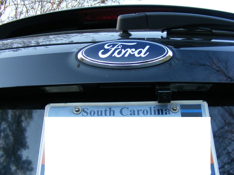

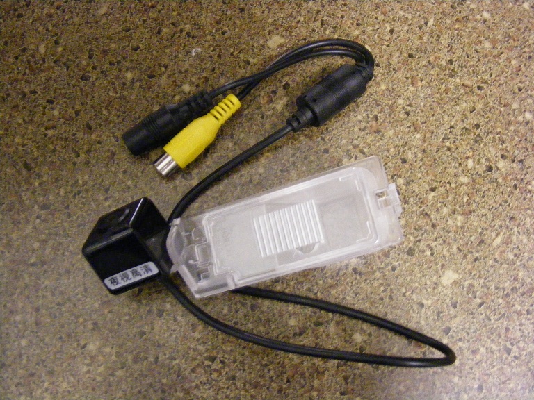

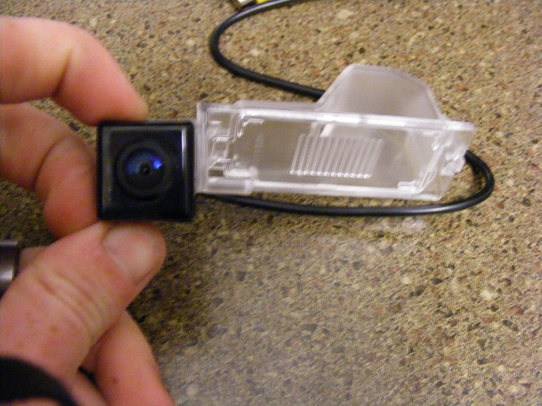

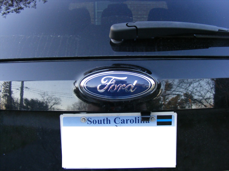

rcbbdl1 Posted January 14, 2012 Author Report Share Posted January 14, 2012 And here are the pics of the unit itself and installed on the vehicle.... Pics to come of the video quality.. Haven't gotten everything hooked up yet... But if anyone knows which wire is needed for the reverse wire hook up at the shifter for the radio signal please chime in! Quote Link to comment Share on other sites More sharing options...
