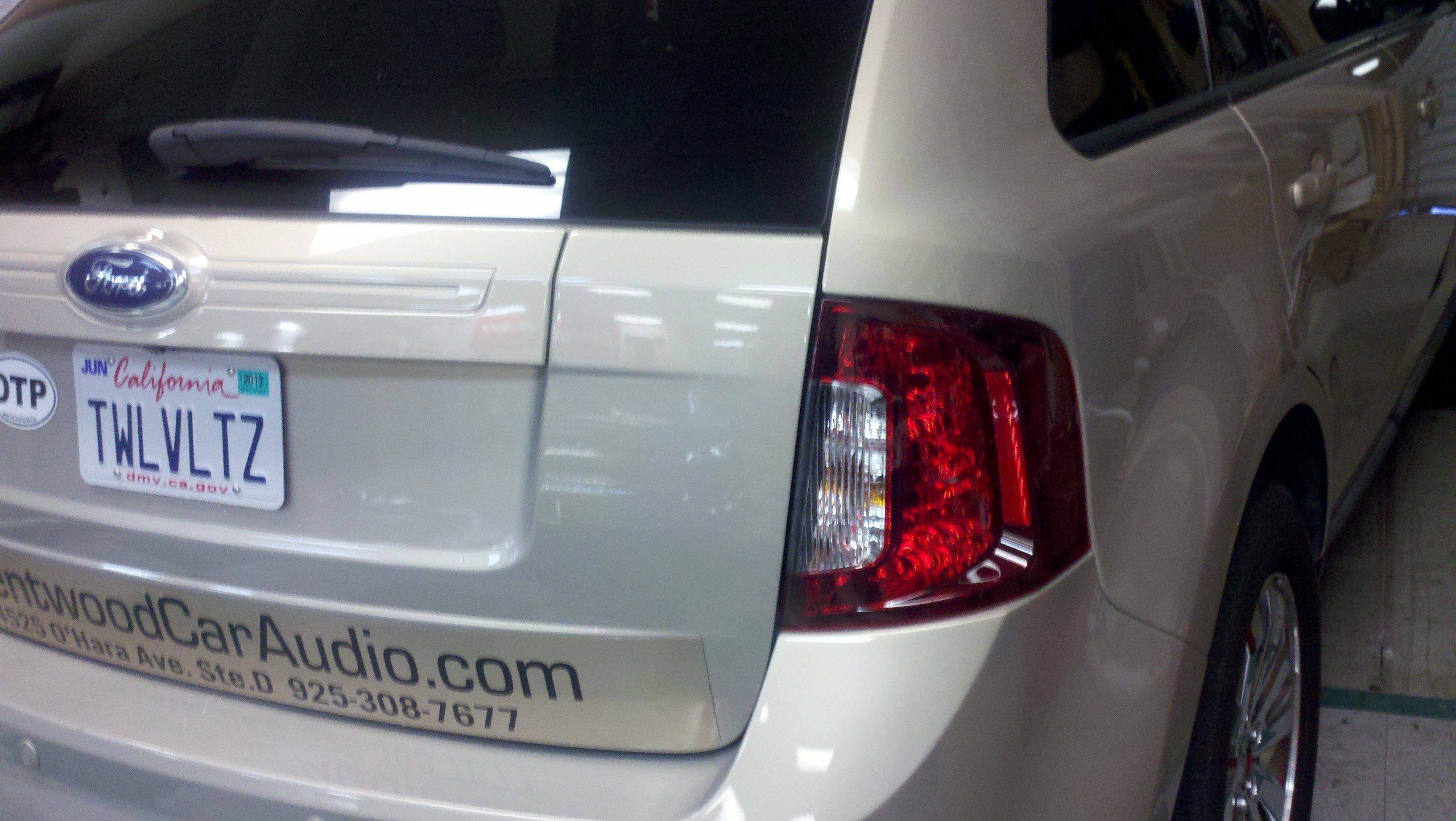

securinu Posted November 9, 2011 Report Share Posted November 9, 2011 So got the new 2011 Edge Sport Tail lights finally installed . Also the new trim for above the license plate also from a 2011 so i can mount my camera like the factory camera. I had the trim panel painted to match . Also moved the tailgate release switch from above the plate to the right of the plate. 1 Quote Link to comment Share on other sites More sharing options...
frozennuts Posted November 9, 2011 Report Share Posted November 9, 2011 (edited) So got the new 2011 Edge Sport Tail lights finally installed . Also the new trim for above the license plate also from a 2011 so i can mount my camera like the factory camera. I had the trim panel painted to match . Also moved the tailgate release switch from above the plate to the right of the plate. I cant understand how they developed this vehicle in the first place with red turn signals, looks good. Can you tell me how you separated the brake and turn feed that comes from a single wire? I know I could take the brake feed from the centre brake but what about the turn signal and affects to bulb failure warning system? Edited November 9, 2011 by frozennuts Quote Link to comment Share on other sites More sharing options...

rcbbdl1 Posted January 20, 2012 Report Share Posted January 20, 2012 Here's how I'm thinkin to do the wiring. Tap into the singal for the front turns to power the rear turns.. Then tap into the 3rd brake light for brakes.. Seems pretty straight forward and easy, no relays, etc. needed... We will find out soon... Any input? Quote Link to comment Share on other sites More sharing options...
rcbbdl1 Posted January 24, 2012 Report Share Posted January 24, 2012 Got my tails in.. Installed... For now I simpply hooked them up the same way as the old tails I used the brake/turn together.. Not using the separate turn signal in the new tails. I will work that out this weekend. Just couldn't wait to get them in a hooked up for now. I do have a small problem with turn signals. R side will blink fast and the L side does 2 quick blinks then a slow one then 2 quick then 1 slow... not sure about this but will work the bugs out and post it up... Quote Link to comment Share on other sites More sharing options...
