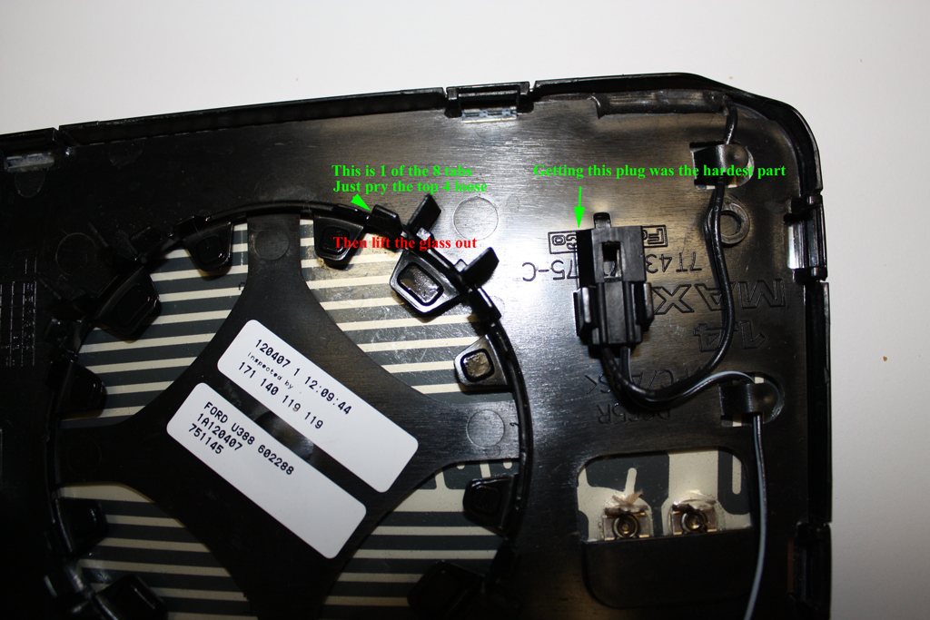

ablb Posted November 2, 2011 Report Share Posted November 2, 2011 Easy DIY Try ebay, call salvage yards. Take your vin # if you go to a dealer. They need it to look up the correct mirror! You’ll need 2 small flat bladed screwdrivers. This was a HOT topic in 08, here’s a link. Post # 65 has a good picture and instructions. http://www.fordedgeforum.com/index.php?/topic/2759-integrated-blind-spot-mirrors/page__hl__blind__st__60 Here’s a pic from our 08 MKX. ab Quote Link to comment Share on other sites More sharing options...
