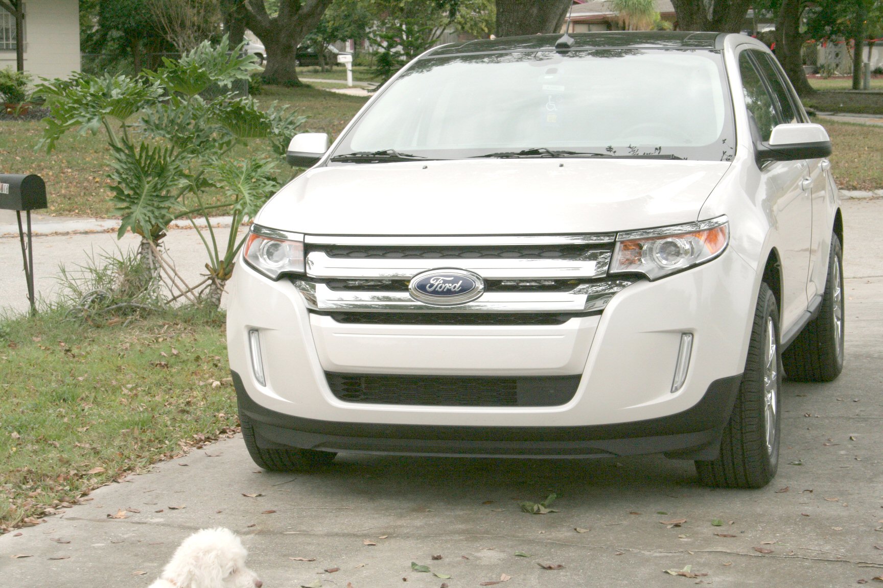

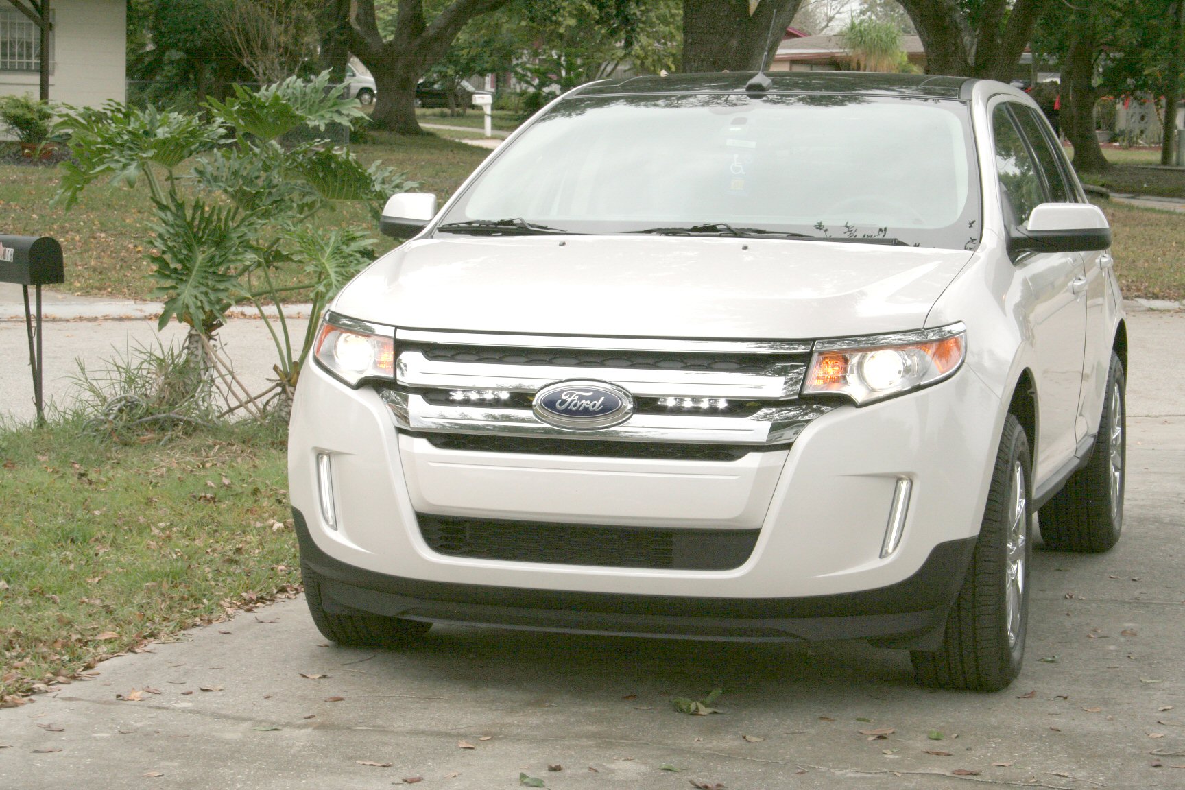

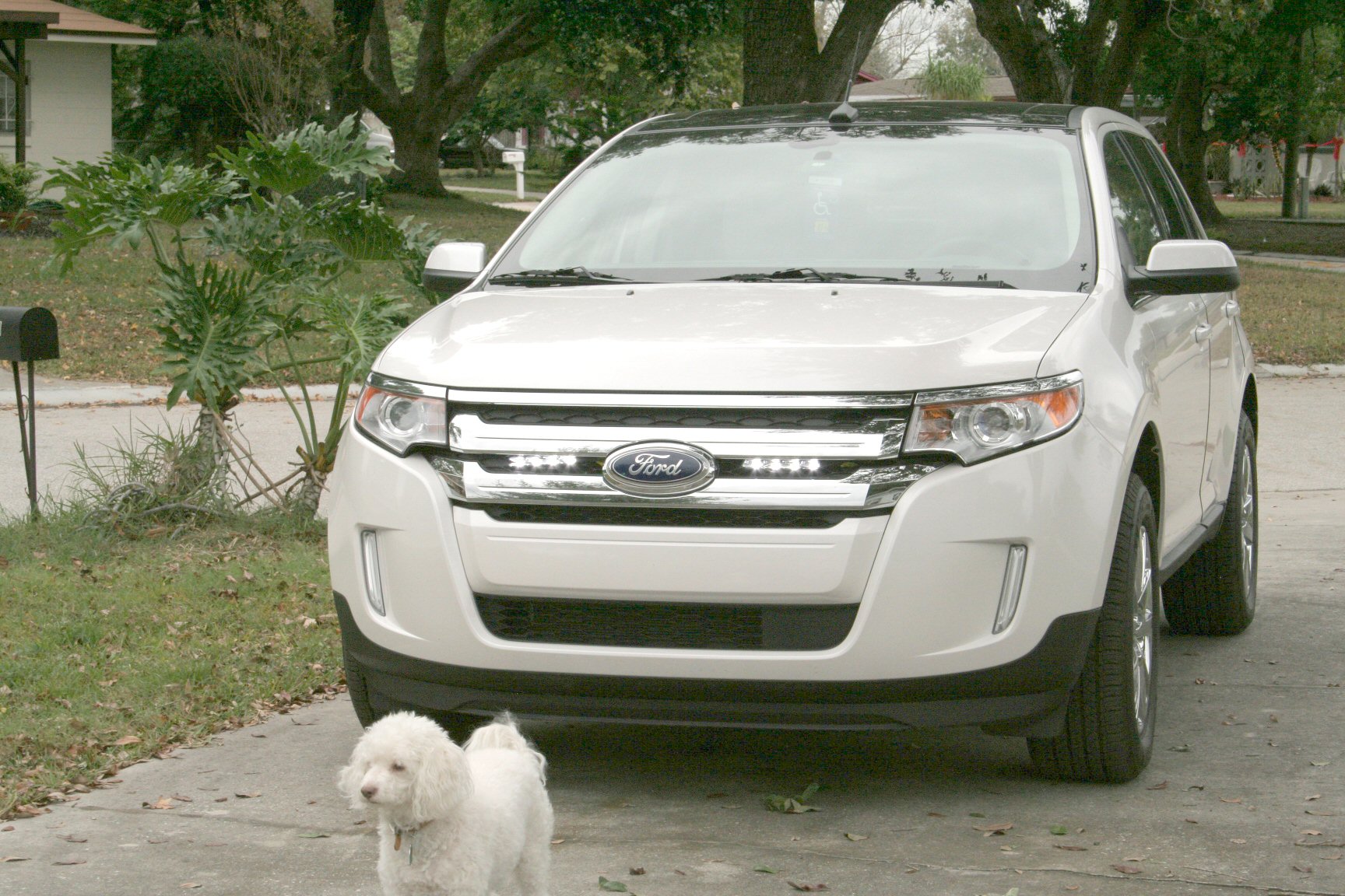

milosm Posted November 28, 2011 Report Share Posted November 28, 2011 On 10/23/2011 at 1:58 AM, wilsons66604 said: I live in the states so I don't get DRLs. From what I've heard, the service tech can choose one of 3 options for the DRLs. Amber parking lamps, Dim headlamps, & one other combination that I think includes the LED lights. I got my 2011 edge limited in july, I live in Florida like you I also dont have any DRL's. I checked into it and found that the led lights are not DRL's , they are front fender markers whatever that is. The only time they and the orange parking lamps come on is only when turn on the parking lights or the headlamps. I went a different way in that i purchased a set of LED-DRL's from www.superbrightled.com part number (DRL-CW5-bm2), I'm having them mounted behind the grill grading next to the FORD emblem they just fit, they will come on bright whenever your driving and will dimm down when ever the headlamps are turned on. the power for the LED's will come from the main electrical buss once the car is started , for dimming I'm going to tap off voltage from the orange parking light which comes on with the head lights. Doug. Quote Link to comment Share on other sites More sharing options...
