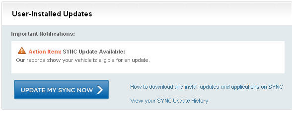

mv-clear Posted September 16, 2011 Report Share Posted September 16, 2011 I visited the SYNC my Ride web site, and for the 1st time in the 11 months since I owned my 2011 Ford Edge LTD, It shows that a update is avaliable. I'm currently on 2.8 and doing the download onto a 4GB flash drive. Maybe this is the user installable 2.11 update? Anyone else find a update available and install it? M. Quote Link to comment Share on other sites More sharing options...
wilsons66604 Posted September 16, 2011 Report Share Posted September 16, 2011 (edited) I visited the SYNC my Ride web site, and for the 1st time in the 11 months since I owned my 2011 Ford Edge LTD, It shows that a update is avaliable. I'm currently on 2.8 and doing the download onto a 4GB flash drive. Maybe this is the user installable 2.11 update? Anyone else find a update available and install it? M. WOOT! I think I will rush home and try it out Edited September 16, 2011 by wilsons66604 Quote Link to comment Share on other sites More sharing options...
mv-clear Posted September 16, 2011 Author Report Share Posted September 16, 2011 WOOT! I think I will rush home and try it out I downloaded it to my USB key, 300+MB (they recommend a 1 GB key for larger, mine is 4 GB) according to the instructions it can take 45 mins to install and you should keep the engine running while doing the update. Since I'm at work, I will wait til tonight(when I get home) to install it, but I'm glad it a self install. Would be nice to hear of some successful installs before I try it on mine.. lol M. Quote Link to comment Share on other sites More sharing options...
