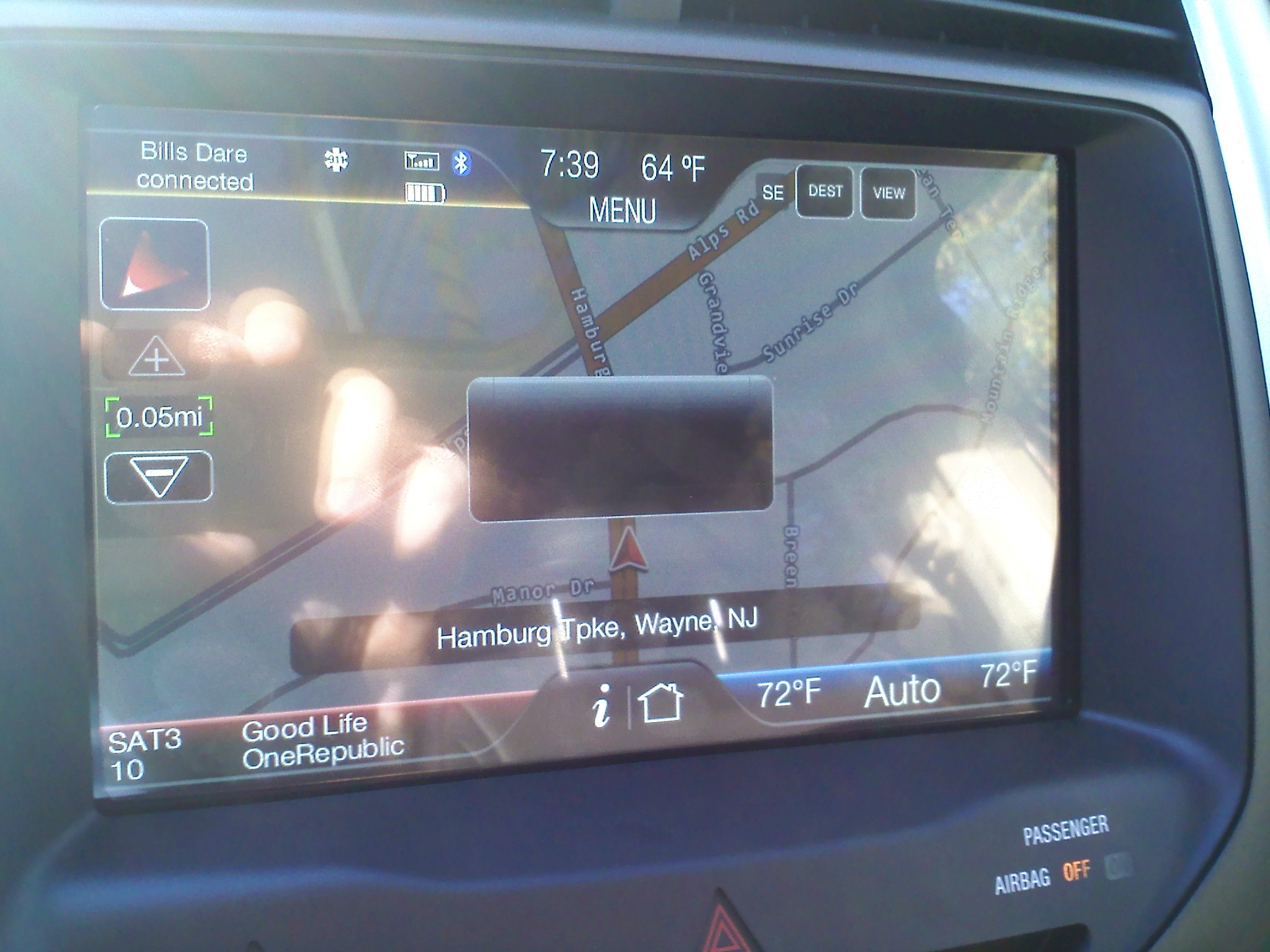

wlepse Posted August 31, 2011 Report Share Posted August 31, 2011 So this morning I had my first glitch in the MFT. Everything was working great until I got a call, after teh call ended there remained a blank dialog box on the screen. No matter what screen you went to it was still there, but only the navigation screen was grayed out. I tried shutting the car off, opening/closing the door and restarting but nothing. I did find a way to get it to go away, I picked a new destination in the GPS and it was normal again. Any ideas what this was? I am still at 2.7 but haven't wanted to go to the dealer until I had an actual issue since it seems like some updates fix certain this but mess with others. I'll try to post up a pic later, my work machine won't let me use BT. Quote Link to comment Share on other sites More sharing options...
dr.edge Posted August 31, 2011 Report Share Posted August 31, 2011 So this morning I had my first glitch in the MFT. Everything was working great until I got a call, after teh call ended there remained a blank dialog box on the screen. No matter what screen you went to it was still there, but only the navigation screen was grayed out. I tried shutting the car off, opening/closing the door and restarting but nothing. I did find a way to get it to go away, I picked a new destination in the GPS and it was normal again. Any ideas what this was? I am still at 2.7 but haven't wanted to go to the dealer until I had an actual issue since it seems like some updates fix certain this but mess with others. I'll try to post up a pic later, my work machine won't let me use BT. Don't worry about it, just get v2.11 installed. There were numerous bugs fixed and the overall reliability improved. Until then, just pull fuse 29 if you need to reset the MFT system (no different than rebooting a PC). Quote Link to comment Share on other sites More sharing options...

wlepse Posted September 2, 2011 Author Report Share Posted September 2, 2011 Here is what the screen looked like. Quote Link to comment Share on other sites More sharing options...
