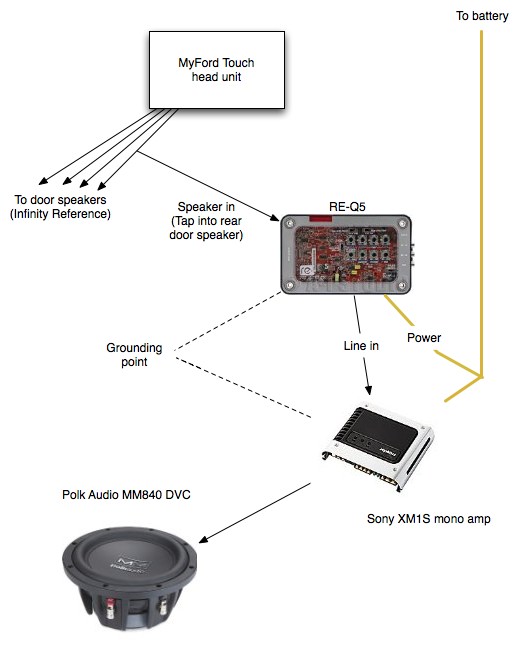

rogersmj Posted August 4, 2011 Author Report Share Posted August 4, 2011 Yeah, based on my research I think that's the case as well. Thanks. So, here's my current plan...have I accounted for everything here? Am I missing any wiring, or is anything I've marked incorrect? Quote Link to comment Share on other sites More sharing options...
NatG Posted August 4, 2011 Report Share Posted August 4, 2011 I'd install some filters on the interiors to cut off the lows. I do not have personal experience with the RE-Q5, but you can intercept the signal prior to where you install the filter. Quote Link to comment Share on other sites More sharing options...
rogersmj Posted August 5, 2011 Author Report Share Posted August 5, 2011 OK thanks for the tip...something like these? Quote Link to comment Share on other sites More sharing options...
baum Posted August 5, 2011 Report Share Posted August 5, 2011 yes like those. keep in mind your stock radio is also only plays about 7 to 15 watts at rms (continuous level). what stereo manufacturers mislead people with is they state the max power (most factory radios are made by major manufactures).. 50 watts blahh blaahh... a radio will never hit this level. the best way if funds provide would be to amp those and get a sub... however if you only add a sub amp i personally would not do the re-q5. you can achieve the same with just a line output converter (LOC). Quote Link to comment Share on other sites More sharing options...
rogersmj Posted August 5, 2011 Author Report Share Posted August 5, 2011 Yeah I know adding an amp for the main speakers would be ideal, and I may do that at some point, but not right now. As for the RE-Q5, I am including it because of all I've read about the stock head unit killing the bass signal as you turn the volume up. Most notably, another member did the same thing in his SEL recently, and he said it didn't sound right until he added the RE-Q5. Using the RE-Q5 also gives me an upgrade path to add that other amp for the mains later on. So I think I'm going to go ahead and order all this stuff...I think the biggest challenge now is going to be building the box behind the right rear cargo trim panel. One last question: the Sony amp says that 4GA wire is "recommended" for power and ground. That's a hella big wire to fish all the way from the back to the front of the car. What do I risk by using an 8GA install kit instead? Quote Link to comment Share on other sites More sharing options...
NatG Posted August 6, 2011 Report Share Posted August 6, 2011 (edited) Rogersmj, go with a 4 gauge wire. It won't be that bad to run it to the back. Ford typically leaves enough room in the wiring channels for aftermarket power kits (since your SEL doesn't have the Sony system, you should have plenty of space). With the 4, you can potentially (key word is potentially) power 2 amps, for if / when you upgrade to utilized an interior amplifier, too. Edited August 6, 2011 by NatG Quote Link to comment Share on other sites More sharing options...
