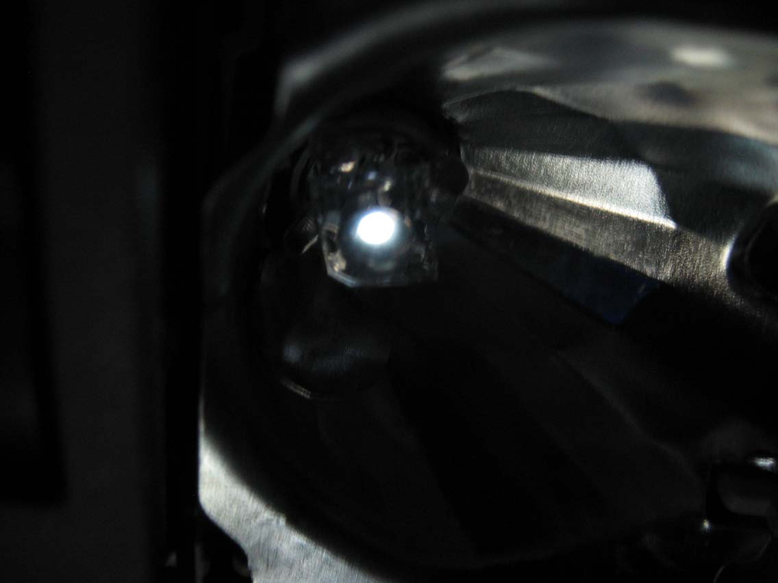

KMAN Posted June 25, 2009 Report Share Posted June 25, 2009 (edited) Put the leds Front Map Lamps: 2825 (W5W ford) had a few extra and found out that they fit in my License Plate ...Now that I did all the nice color leds my wife wants me to change the puddle lights. But I wanted to buy some new replacements just in case I mess up . I called a local ford dealer and they said $300 for the whole mirror and I could not get they separate.. !! Edited June 25, 2009 by KMAN Quote Link to comment Share on other sites More sharing options...
dadrett Posted June 25, 2009 Report Share Posted June 25, 2009 (edited) Put the leds Front Map Lamps: 2825 (W5W ford) had a few extra and found out that they fit in my License Plate ...Now that I did all the nice color leds my wife wants me to change the puddle lights. But I wanted to buy some new replacements just in case I mess up . I called a local ford dealer and they said $300 for the whole mirror and I could not get they separate.. !! Buying whole mirror is unnecessary. In this forum (Pg 3) find my thread "LED Puddle Lamps?, Less $ Than U Thought". Lamp units are $26.12 + S&H from Tasca Ford. U might try U'r dealer's parts guy & see if he'll price match. Edited June 25, 2009 by dadrett Quote Link to comment Share on other sites More sharing options...
