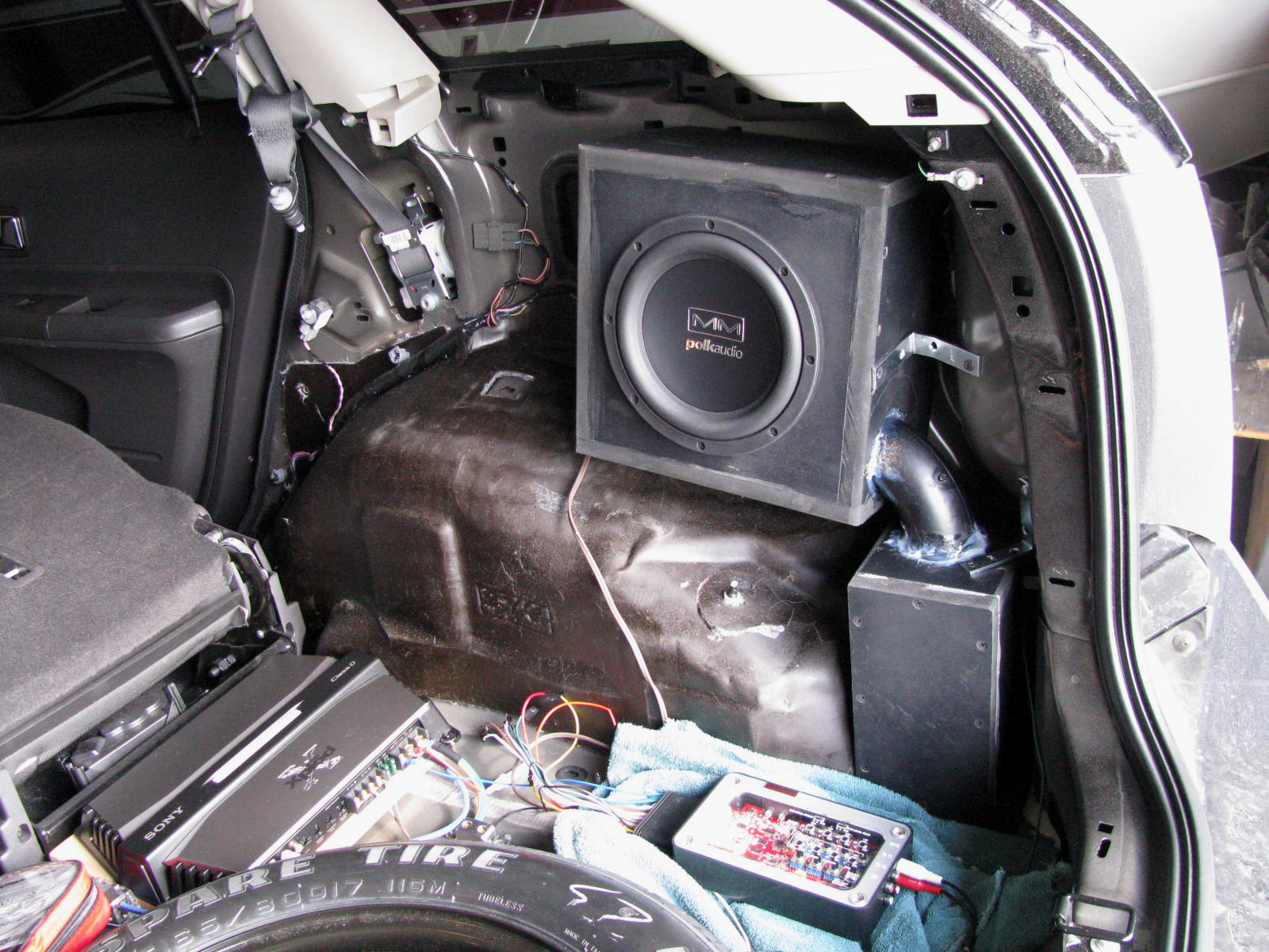

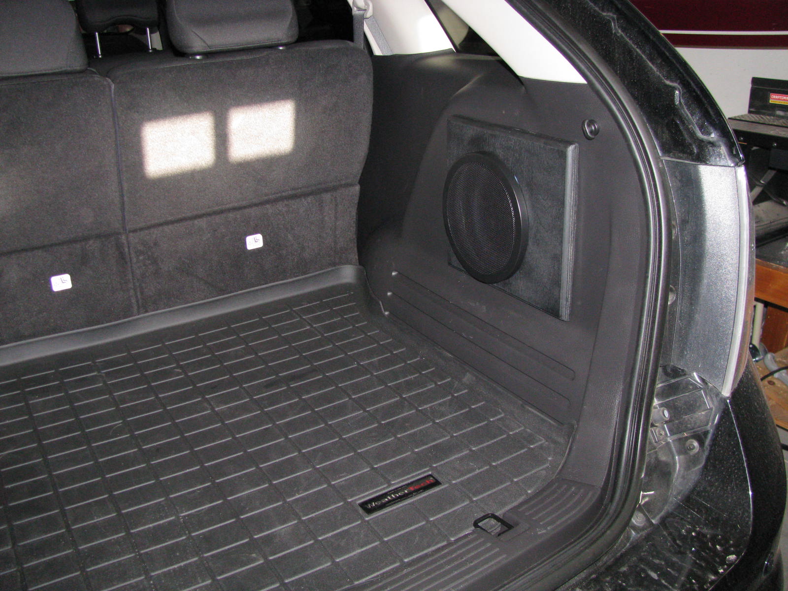

Linty Posted July 14, 2011 Report Share Posted July 14, 2011 Here are a couple of pix of my recent subwoofer project. My 2010 Edge came with the stock audio system and sounded rather weak. I replaced the door speakers with Polks (big improvement). I wanted to add the JL stealth sub, but it was over my budget, and I haven't heard very good news about the Ford OEM sub. I liked the stealth idea, but that meant the cabinet would be small. Decent low extension is more important to me than way high dB levels. I decided to add a Polk MM840 with a Sony XM-ZZR3301 amp. I added the small enclosure to the right of the main cabinet to gain some interior volume. The two cabinets are connected with a 2.5 inch 90 degree ABS elbow, glued in with epoxy. The cabinets are attached to the body in several places with brackets. It sounded pretty good, but not quite balanced the way I wanted with the door speaker level (especially since the bass content decreases as the volume is increased with the stock head unit). I added an RE-Q5 processor and it fixed the balance and decreasing bass problem (highly recommended if you want to keep the stock head unit and add amps). The amp is just behind the back seat, I cut the foam block to fit. (no heat probem) I am still thinking about adding an amp for the door speakers. Linty Quote Link to comment Share on other sites More sharing options...

mrdave Posted July 14, 2011 Report Share Posted July 14, 2011 Very nice! The 90deg elbow is a great idea to add a little more volume to the enclosure. I'd like to do something similar once I actually have some time. The factory sub is just OK on my 2011 Limited. Once you turn up the volume a little bit, the low end completely falls flat. Quote Link to comment Share on other sites More sharing options...
cal3thousand Posted July 14, 2011 Report Share Posted July 14, 2011 Here are a couple of pix of my recent subwoofer project. My 2010 Edge came with the stock audio system and sounded rather weak. I replaced the door speakers with Polks (big improvement). I wanted to add the JL stealth sub, but it was over my budget, and I haven't heard very good news about the Ford OEM sub. I liked the stealth idea, but that meant the cabinet would be small. Decent low extension is more important to me than way high dB levels. I decided to add a Polk MM840 with a Sony XM-ZZR3301 amp. I added the small enclosure to the right of the main cabinet to gain some interior volume. The two cabinets are connected with a 2.5 inch 90 degree ABS elbow, glued in with epoxy. The cabinets are attached to the body in several places with brackets. It sounded pretty good, but not quite balanced the way I wanted with the door speaker level (especially since the bass content decreases as the volume is increased with the stock head unit). I added an RE-Q5 processor and it fixed the balance and decreasing bass problem (highly recommended if you want to keep the stock head unit and add amps). The amp is just behind the back seat, I cut the foam block to fit. (no heat probem) I am still thinking about adding an amp for the door speakers. Linty Nice install! What are the boxes filled with? Anything? Quote Link to comment Share on other sites More sharing options...
Linty Posted July 15, 2011 Author Report Share Posted July 15, 2011 Nice work. I'm disappointed in our 2011 SEL's audio system too. It's my wife's car and she doesn't notice how bad it is, but I still may upgrade it at some point. Which Polk speakers exactly did you buy, and do you know if they could be used on the 2011? I'm a big fan of Polk stuff usually. Roger - I installed Polk DXi570s in all doors (except for the Ford connector, they are a drop-in replacement) - not the top of the line, but a great value - the OEM speakers had harsh upper mids and flabby bass - the Polks would sound even better if I added a bass blocker cap or an amp with a HPF - I will get to that step later this summer - Linty Quote Link to comment Share on other sites More sharing options...
Linty Posted July 15, 2011 Author Report Share Posted July 15, 2011 Nice install! What are the boxes filled with? Anything? The boxes are sealed and total about .45 qft - I stapled some 1" convoluted open cell foam to about half the interior walls - after some testing I decided that combination sounded pretty good, so I stopped there. The suggested box design from Polk didn't say to fill it, so I didn't (I don't like taking the speaker in and out unless I have to). btw - I also added some Dynamat around the inside of the plastic cargo area cover (behind the grill mount) just in case I created a rattle. thanks Linty 1 Quote Link to comment Share on other sites More sharing options...
cal3thousand Posted July 15, 2011 Report Share Posted July 15, 2011 The boxes are sealed and total about .45 qft - I stapled some 1" convoluted open cell foam to about half the interior walls - after some testing I decided that combination sounded pretty good, so I stopped there. The suggested box design from Polk didn't say to fill it, so I didn't (I don't like taking the speaker in and out unless I have to). btw - I also added some Dynamat around the inside of the plastic cargo area cover (behind the grill mount) just in case I created a rattle. thanks Linty Cool. Here's a +1 for a sweet thread. Quote Link to comment Share on other sites More sharing options...

baum Posted July 27, 2011 Report Share Posted July 27, 2011 IMO you should have used some polyfill (they stuffing in pillows). being that you are about .1 cu ft small (it really makes a difference on how efficient the sub is). With polyfill in the box it "tricks" the sub into playing like its a much larger box. I had to do the same thing when i built custom boxes that go around the spare tire. i have 2 12" jl subs and the airspace i had was only like 1 cu ft and i needed a little more so stuffing came into play. 1 Quote Link to comment Share on other sites More sharing options...
NatG Posted July 27, 2011 Report Share Posted July 27, 2011 Baum's advice on the polyfill is excellent. My friend setup my old system in my Impala/Xterra, and he recommended it. And that system sounded awesome. Plus 1 for you, Baum. Quote Link to comment Share on other sites More sharing options...
