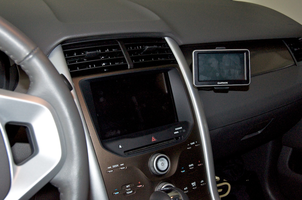

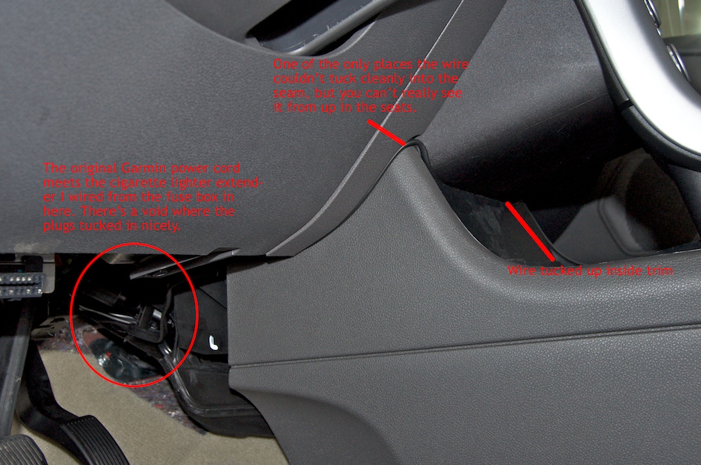

Success! Thank you all for your help. I got a mini fuse tap from the local auto parts store, plugged that into #35, and cut off the end of the cigarette extension cord I bought and connected the red wire to that. Then ran the ground to the ground terminal just a few inches away from the fuse box, under the driver's door trim piece, and connected it with a ring terminal. Most of the wire running up to the GPS unit itself easily tucked into seams in the plastic trim, so it's a pretty clean look. I did leave the FM receiver box (high on the power cord, near the GPS unit itself) outside the dash instead of trying to tuck it inside, because it is kind of large to get in there without taking any panels off and I didn't know how much that would affect reception.
I snapped a few pics of the finished product.
