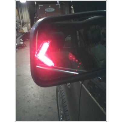

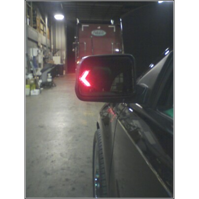

SALEENS7 Posted July 2, 2007 Report Share Posted July 2, 2007 (edited) Just installed LED turn signal indicators into the driver and pass. mirrors of my edge...took me about 2 hrs each side as i had to snake the wires thru the engine/firewall/ and remove the mirrors to insure a pro. install. If anyone decides to do this, twist the turn signal bulb connector away from its housing in each of the headlight housings, look for the BLACK ground wire(there are 3 wires), take your hot lead wire from your new led signal, and splice it into the wire at the opposite end of the where the black wire is. (not the middle wire) Each signal housing has a different color hot wire for that turn signal, so that is why i do not specify a color. I took the ground wire and connected it to the mirror housing bolts which bolt directly to the edges metal bodywork. Edited July 3, 2007 by SALEENS7 Quote Link to comment Share on other sites More sharing options...
xplorgee Posted July 3, 2007 Report Share Posted July 3, 2007 Lets see some pics Quote Link to comment Share on other sites More sharing options...
SALEENS7 Posted July 3, 2007 Author Report Share Posted July 3, 2007 Lets see some picsSorry xpolrgee...was having problems uploading pics yesterday...they are up now. I can send pics of the wiring install along with removing the mirrors and installation of the wiring their also if anyone needs them. Quote Link to comment Share on other sites More sharing options...
