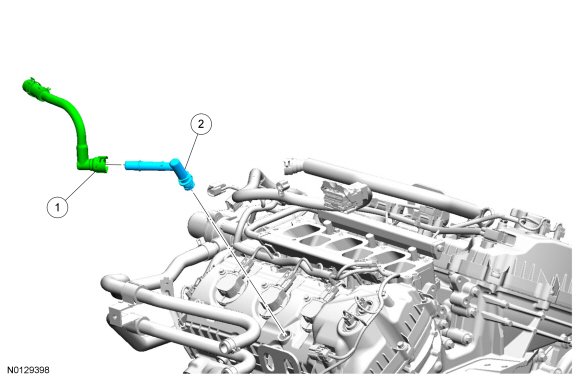

rqb2001 Posted May 27, 2017 Report Share Posted May 27, 2017 Here is location 2 Quote Link to comment Share on other sites More sharing options...
macbwt Posted May 27, 2017 Report Share Posted May 27, 2017 Here is location Thank you that was a big help. 1 Quote Link to comment Share on other sites More sharing options...
chefduane Posted May 28, 2017 Report Share Posted May 28, 2017 Ditto. That diagram becomes part of my Spark Plug changeout project. Plugs, PCV, upper plenum gaskets, and purge valve are on the agenda. The diagram will help a lot. Tnx. 1 Quote Link to comment Share on other sites More sharing options...
