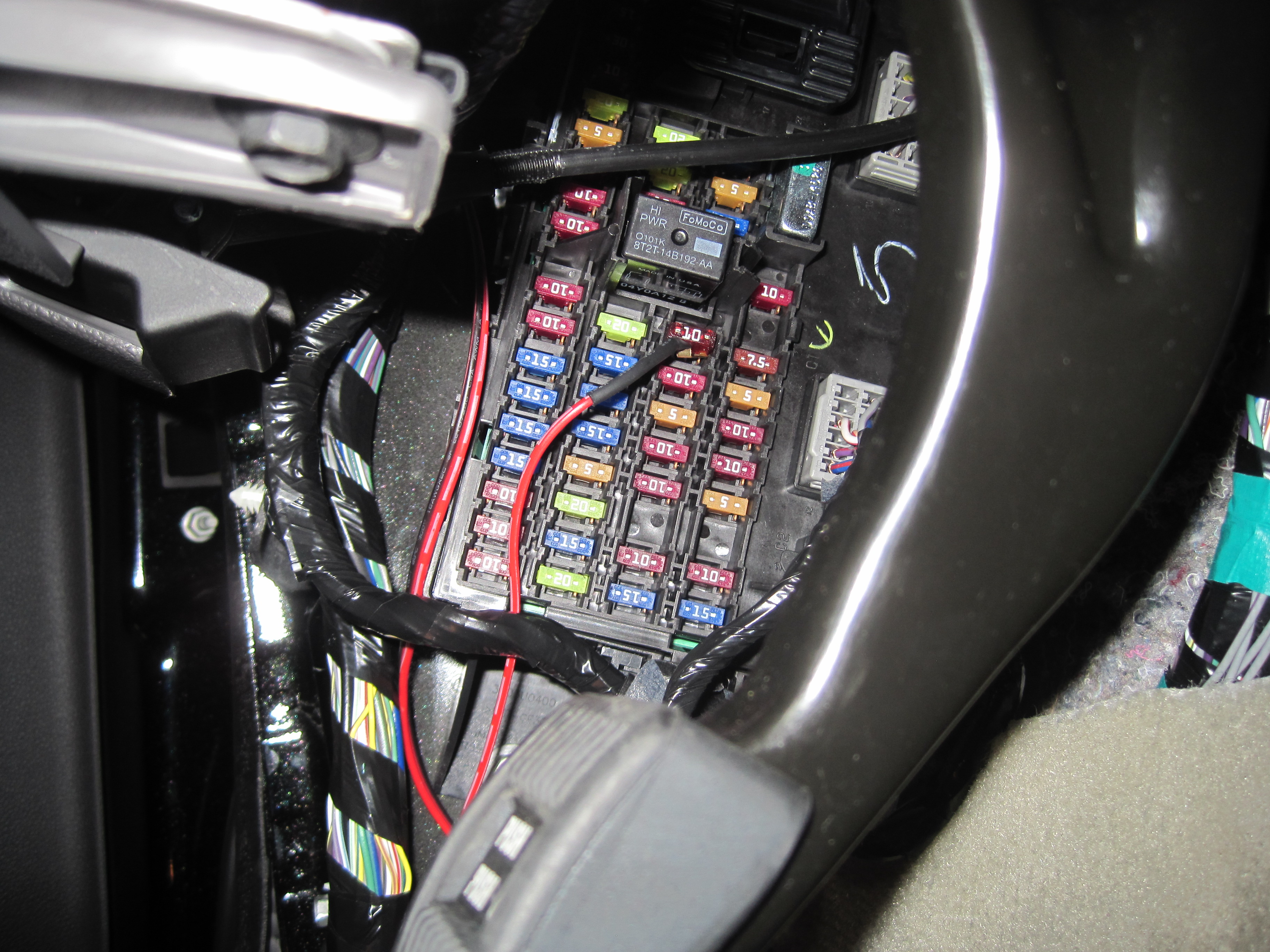

Tiger_Steve Posted July 15, 2011 Author Report Share Posted July 15, 2011 Tiger Steve, Did you ever get you Audi lights for your Edge? If, so what kind did you get and also do you have any pics? Thanks! I did buy the set from iJDMtoy,com "LED_Audi_Style_Strip_20 inch pair for about $26. Now listed at $16.99. Looks good. Unfortunately, it is very difficult to find the "power" connection. I want the LED lights on whenever the motor is running, and off when it isn't. I have the references for connectors to connect to the correct fuse. http://store.ijdmtoy.com/Audi-Style-Headlight-Fog-Light-LED-Strip-Lighting-p/led_audi_style_strip_sku59.htm I was told that these fuses are on a distribution box, under the dashboard, driver's side. It is not easy to get to the box for THREE reasons: 1) It is, apparently, under the drivers side dash, on the firewall, 2) It may be behind the firewall carpet 3) I may have trouble, with my arthritis, bending my back/neck to work in this area. Maybe I can get my son (or one of my grandson's sons) to get in there! Tiger_Steve Quote Link to comment Share on other sites More sharing options...
hughes Posted August 22, 2011 Report Share Posted August 22, 2011 I did buy the set from iJDMtoy,com "LED_Audi_Style_Strip_20 inch pair for about $26. Now listed at $16.99. Looks good. Unfortunately, it is very difficult to find the "power" connection. I want the LED lights on whenever the motor is running, and off when it isn't. I have the references for connectors to connect to the correct fuse. http://store.ijdmtoy.com/Audi-Style-Headlight-Fog-Light-LED-Strip-Lighting-p/led_audi_style_strip_sku59.htm I was told that these fuses are on a distribution box, under the dashboard, driver's side. It is not easy to get to the box for THREE reasons: 1) It is, apparently, under the drivers side dash, on the firewall, 2) It may be behind the firewall carpet 3) I may have trouble, with my arthritis, bending my back/neck to work in this area. Maybe I can get my son (or one of my grandson's sons) to get in there! Tiger_Steve Tiger Steve, Do you have pictures or instructions on how they are to be installed in the Ford Edge? Also, can you please supply the instructions for connectors to connect to the correct fuse? Thanks! Quote Link to comment Share on other sites More sharing options...

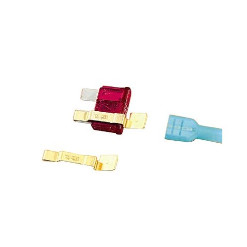

Tiger_Steve Posted August 30, 2011 Author Report Share Posted August 30, 2011 I tried, a few days ago, to send pictures - but the list would not accept them ????? Here is the data from Langstrum's Foundry - however their fuse box is on the left, and ours are under the dash (from interior, under some plastic removable cover to get to the fuses. Lanstrum's version is st: http://www.landstrom...h-foglights.php Here is a small electriical connector from Amazon: and here are the JDM Toy.com ad or the strip, 2 18 inch strips: $25.99 http://store.ijdmtoy...strip_sku59.htm Hope all the attachments get through. Quote Link to comment Share on other sites More sharing options...
Tiger_Steve Posted September 2, 2011 Author Report Share Posted September 2, 2011 I tried, a few days ago, to send pictures - but the list would not accept them ????? Here is a small electrical connector from Amazon: Hope all the attachments get through. Here is the direct Amazon Link to the Amazon fuse taps: http://www.amazon.co..._ecc_rvi_cart_3 (it may not a hot link) Anyway, it may be connected through my own browsing, but close. Search Amazon for "Wirthco", if this link doesn't work. Tiger_Steve Quote Link to comment Share on other sites More sharing options...
