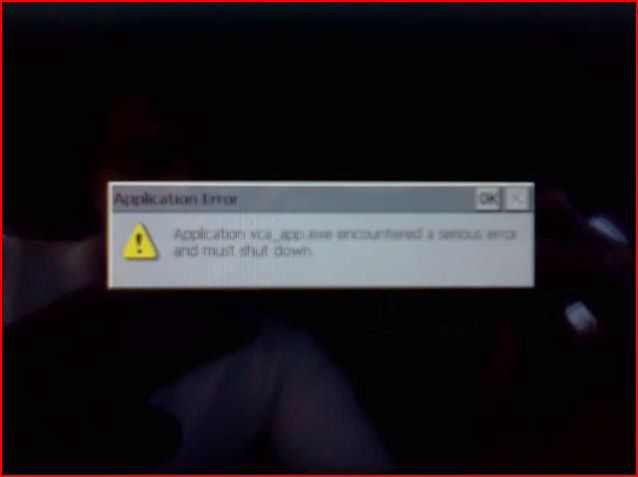

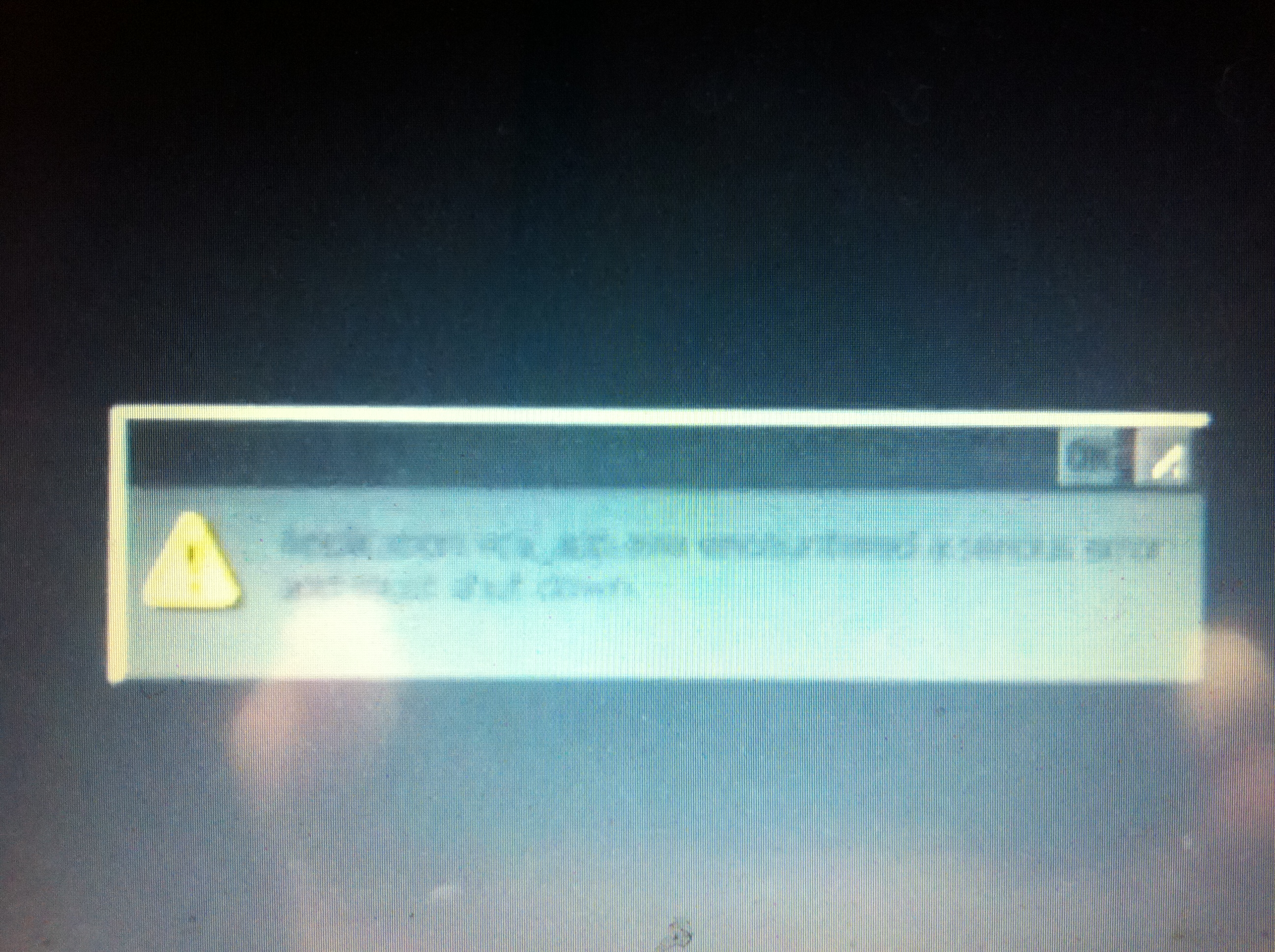

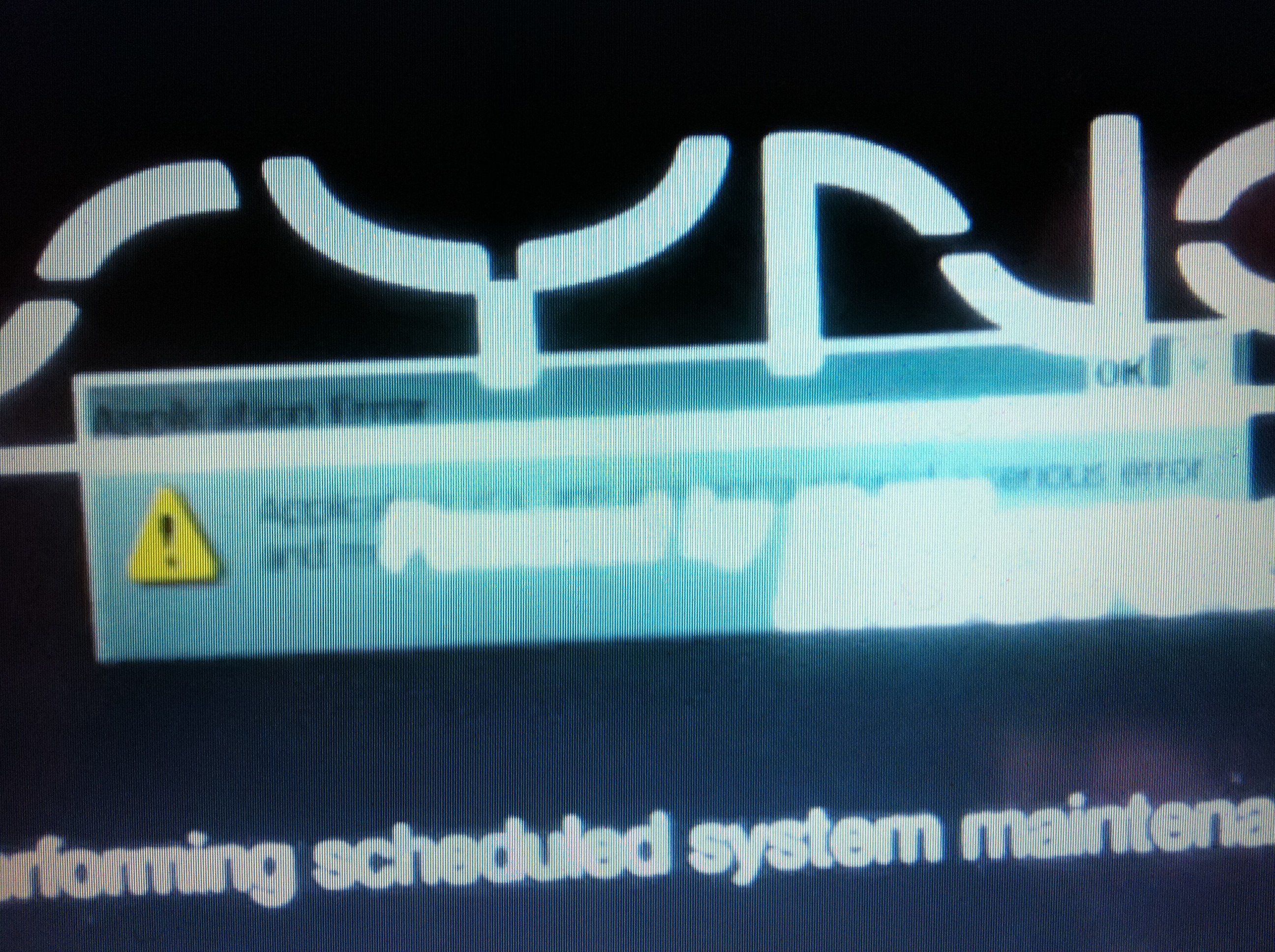

Skimco Posted April 25, 2011 Author Report Share Posted April 25, 2011 This is exactly what happened to my wife's brand new Explorer. Fuse 29 is no good for this. We brought it back to the dealer and they had to re-flash MFT. It was done in an hour and a half. No issues since. thnkx edgie im gonna try and take it tommorow....It also throws an error message up unbelievably fast but i did catch a few shots of it it says "application error" and something about it has encountered a serious error and has to shut down...ill try and attach them Quote Link to comment Share on other sites More sharing options...

wilsons66604 Posted May 5, 2011 Report Share Posted May 5, 2011 thnkx edgie im gonna try and take it tommorow....It also throws an error message up unbelievably fast but i did catch a few shots of it it says "application error" and something about it has encountered a serious error and has to shut down...ill try and attach them WOW!! Those are great shots of the windows errors. I don't think they have ever been captured before Quote Link to comment Share on other sites More sharing options...
Surge9609 Posted May 30, 2011 Report Share Posted May 30, 2011 WOW!! Those are great shots of the windows errors. I don't think they have ever been captured before I took a shot also. The continuous reboot starting happening after 2 months (2000 miles). Dealer will have to replace APIM module (week to get the part) I think it says "Application vca_app.exe encountered a serious error and must shut down." Quote Link to comment Share on other sites More sharing options...
