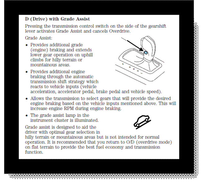

akirby Posted March 2, 2011 Report Share Posted March 2, 2011 Akirby there is no O/D switch on a 2011 Edge. There is according to the 2011 Edge owner's manual. Quote Link to comment Share on other sites More sharing options...

nextime Posted March 2, 2011 Report Share Posted March 2, 2011 Like I said there is no O/D switch on a 2011 Edge, that is a grade assist button and your picture clearly states that. What that does is cancel Overdrive and puts the transmission into a different mode that alows it to brake when the vehicle meets certain conditions. Please read the picture that you attached so you can understand it is not a O/D button and so you can actually find out what the transmission does when you activate the grade assist feature. I cant find anywhere in the Manual where it says there is an O/D button on a 2011 Edge. Now on older vehicles there is a O/D switch and it does turn off O/D and that is all it does, on a 2011 Edge that switch does much more that the old school term you are using. Quote Link to comment Share on other sites More sharing options...
akirby Posted March 2, 2011 Report Share Posted March 2, 2011 Like I said there is no O/D switch on a 2011 Edge, that is a grade assist button and your picture clearly states that. What that does is cancel Overdrive and puts the transmission into a different mode that alows it to brake when the vehicle meets certain conditions. Please read the picture that you attached so you can understand it is not a O/D button and so you can actually find out what the transmission does when you activate the grade assist feature. I cant find anywhere in the Manual where it says there is an O/D button on a 2011 Edge. Now on older vehicles there is a O/D switch and it does turn off O/D and that is all it does, on a 2011 Edge that switch does much more that the old school term you are using. Ok, there is a "Transmission Control" switch that you can press that turns off overdrive and if you press it again it turns overdrive back on. It also enables and disables Grade Assist. On my 2008 the button works exactly the same way (including Grade Assist) but is labeled O/D. I don't know if the 2011 button is also labeled O/D. Quote Link to comment Share on other sites More sharing options...

11Edge Posted June 1, 2011 Report Share Posted June 1, 2011 Like I said there is no O/D switch on a 2011 Edge, that is a grade assist button and your picture clearly states that. What that does is cancel Overdrive and puts the transmission into a different mode that alows it to brake when the vehicle meets certain conditions. Please read the picture that you attached so you can understand it is not a O/D button and so you can actually find out what the transmission does when you activate the grade assist feature. I cant find anywhere in the Manual where it says there is an O/D button on a 2011 Edge. Now on older vehicles there is a O/D switch and it does turn off O/D and that is all it does, on a 2011 Edge that switch does much more that the old school term you are using. First sentence of the picture says "Pressing the transmission control switch on the side of the gearshift lever activates Grade Assist and cancels Overdrive". Last sentence says "It is recommended that you return to O/D (overdrive mode) on flat terrain to provide the best fuel economy and transmissio function". The Grade Assist button is a dual function button. Turns on Grade Assist and turns off O/D. Press it a second time and it turns off Grade Assist and turns on O/D. At least that is how I read it. My Edge has manual mode and the button on the side of the shift lever is for manual shifting, so I will have to read about Grade Assist for my car. Quote Link to comment Share on other sites More sharing options...
cal3thousand Posted June 1, 2011 Report Share Posted June 1, 2011 First sentence of the picture says "Pressing the transmission control switch on the side of the gearshift lever activates Grade Assist and cancels Overdrive". Last sentence says "It is recommended that you return to O/D (overdrive mode) on flat terrain to provide the best fuel economy and transmissio function". The Grade Assist button is a dual function button. Turns on Grade Assist and turns off O/D. Press it a second time and it turns off Grade Assist and turns on O/D. At least that is how I read it. My Edge has manual mode and the button on the side of the shift lever is for manual shifting, so I will have to read about Grade Assist for my car. I've been trying to figure this one out myself. But from observation, it seems that the engine will kick down the transmission if going down a grade and I feather the brake. Could be in my head, but I'll continue to test it. If I really need the engine braking, I will throw it in Manual and downshift on my own. Quote Link to comment Share on other sites More sharing options...
