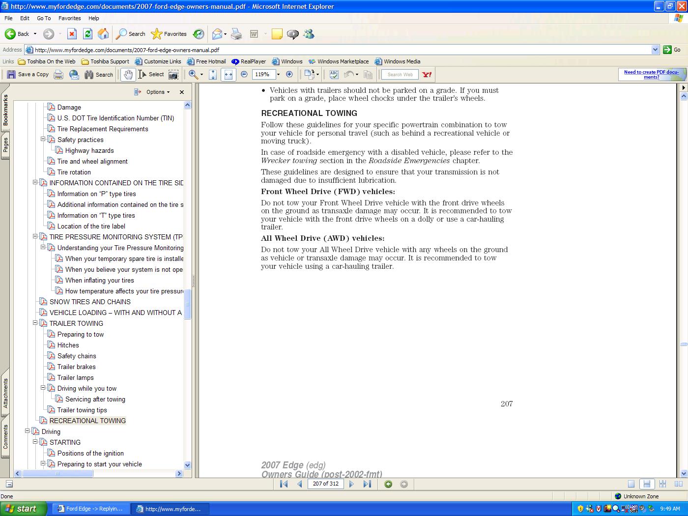

I've been looking at the owners manual online, and from what I can see, it looks like you aren't supposed to tow an AWD unit with the wheels on the ground. The manual I have been looking at is posted on myfordedge.com and here is what it says:
According to the owners manual on pg. 210 you must tow your AWD with either all 4 wheels on the ground, or all 4 wheels off the ground, no dollies you put only under 2 wheels. This is for towing behind recreational vehicles only.

I'm a little confused. It sounds as though some of you are towing the edge? The book cleary states you cannot do that on the AWD with any whell down or the FWD with the front wheels down. Am I not understanding?
Respectfully, you are reading the manual wrong or have the wrong manual. The book says you can't tow it on a "dolly" where the front is off the pavement and the rear is on the pavement.
The book says:

Before I bought the car I confirmed that it was towable. I used the owners manual, an RV sales guide that Ford prints for their dealer sales reps, an RV users net forum on the Internet and a Ford customer support line.

I have towed my 2007 SEL Plus FWD for more than 2500 miles without problems.
It is important to read the directions in the manual.... maybe a few times.
Without looking at my manual, it is the AWD that cannot be towed with front wheels on a tow dolly. But, check that out in your manual.
This has also been discussed a few times so a search should reveal the other discussion.

The 2007 owner's manual is a little vague in its wording but it says the AWD version is towable with all four wheels on the ground. After you have it fully attached to the motorhome with a Roadmaster or Blue-Ox towbar you release the parking brake, put the transmission in neutral and turn the key counterclowise as far as it will go. If you stop for fuel or at a rest stop consider running the engine for a few minutes.
