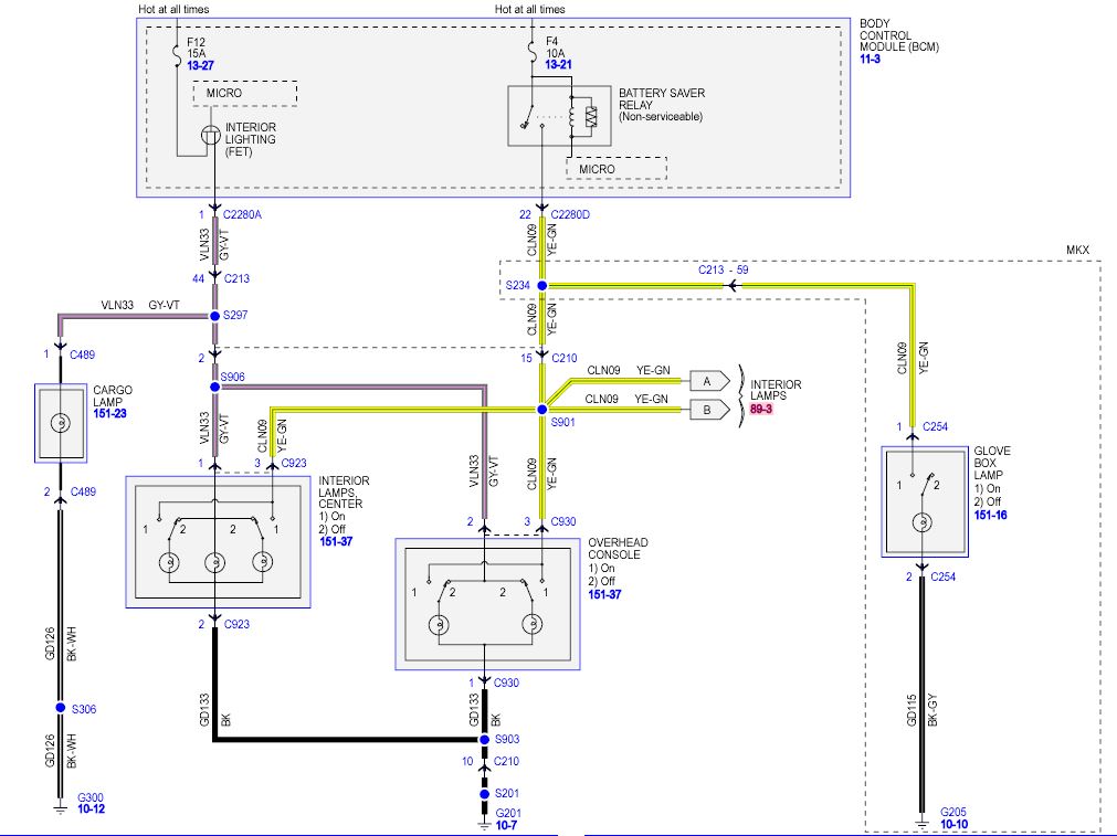

tarponbeach Posted February 1, 2011 Report Share Posted February 1, 2011 Very odd, but last night the front, rear & cargo dome lights stopped working. Map lights work when switched on manually, but neither opening a door or pushing the dome light switch next to the headlight switch will turn on the dome lights. Does anyone know if there is a separate fuse for the dome light circuit? Could not identify one from the diagram in the manual. Quote Link to comment Share on other sites More sharing options...

chipworkz Posted October 25, 2014 Report Share Posted October 25, 2014 This is an old thread but to address the original question, yes there are two fuses. One for the dome lights (F12) and one for the on demand or switched (switch at the light) lights (F4). The switch on the dash activates the F12 circuit so it is the same as opening the door. See the attached diagram. 1 Quote Link to comment Share on other sites More sharing options...
