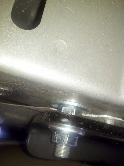

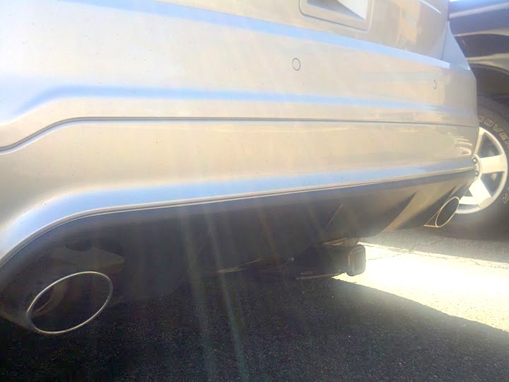

Daniel Churco Posted March 7, 2011 Report Share Posted March 7, 2011 (edited) Pics as well, I'd like to see this myself as I am interested in installing one on my 2011 Sport I also installed the hitch, and did it slightly different. I did not cut the bumper. I used longer bolts, and spaced the hitch down with an extra nut between the car and the hitch. I did need to grind the hitch a little as the mufflers were not even from below, but once I did that, it all fit perfectly. (the muffler slightly touched the hitch and was vibrating). now there is no noise, and did not have to cut anything on the car. I can post a picture of my install later today if you want. Edited March 7, 2011 by _12121 Quote Link to comment Share on other sites More sharing options...
Daniel Churco Posted March 7, 2011 Report Share Posted March 7, 2011 Here are some pictures I just took. The first to are how it looks. the last is the method that I used to lower it by about 1/2-3/4" -Dan Quote Link to comment Share on other sites More sharing options...
Sford56 Posted March 15, 2011 Report Share Posted March 15, 2011 Here are some pictures I just took. The first to are how it looks. the last is the method that I used to lower it by about 1/2-3/4" -Dan Thanks for the pics, which hitch is that? It's a class II, and not the Class III Curt 13067 mentioned at the top of this thread. Probably good to keep track of which hitches work, and how. Scott '11 KB Edge Sport Quote Link to comment Share on other sites More sharing options...
Edgieguy Posted March 15, 2011 Report Share Posted March 15, 2011 I have a class III hitch, maybe from hidden hitch? Anyway, I had planned on mounting this in the same manner (by dropping it 3/4 of and inch down), only I was making a plate from aluminium in order to allow the hitch to contact the unit body of the edge completely and not just by the surface area of the nuts. Since we just purchased an explorer with a tow package I no longer need to do this. But as i stated in a different thread, 3/4" will bring you under the rear bumper valance. Quote Link to comment Share on other sites More sharing options...
Daniel Churco Posted March 17, 2011 Report Share Posted March 17, 2011 Thanks for the pics, which hitch is that? It's a class II, and not the Class III Curt 13067 mentioned at the top of this thread. Probably good to keep track of which hitches work, and how. Scott '11 KB Edge Sport This is the CURT Part Number: C12036. It is a 1-1/4" Receiver. I only do some occasional Light Duty Towing, so I had no need for the 2". I would do a Full extension plate if I was going with the 2" as was stated by Edgieguy, but for the smaller hitch, only 350lbs max tongue weight, and I'm only towing about 1250 lbs, I was comfortable with this setup. Quote Link to comment Share on other sites More sharing options...

rmcline Posted July 24, 2011 Report Share Posted July 24, 2011 Here are some pictures I just took. The first to are how it looks. the last is the method that I used to lower it by about 1/2-3/4" -Dan Dan, Is this install still working for you. That seems a tad unsafe since you are trusting the strength of the bolts alone since the entrire hiflange is not in contact with the frame. I am about to do this install and wanted to lower mine as well to get under the lower bumper fascia. Thanks! Marty Quote Link to comment Share on other sites More sharing options...
bender Posted October 2, 2011 Report Share Posted October 2, 2011 Dan, Is this install still working for you. That seems a tad unsafe since you are trusting the strength of the bolts alone since the entrire hiflange is not in contact with the frame. I am about to do this install and wanted to lower mine as well to get under the lower bumper fascia. Thanks! Marty I would ditch the grade 2 washers and nut for a spacer and get a plate in there as soon as possible. The frame on the edge is like litmus paper and I wouldn't want to be putting loads from towing into concentrated areas of the frame, you can see your washers are bent from tightening the fasteners already. Quote Link to comment Share on other sites More sharing options...
