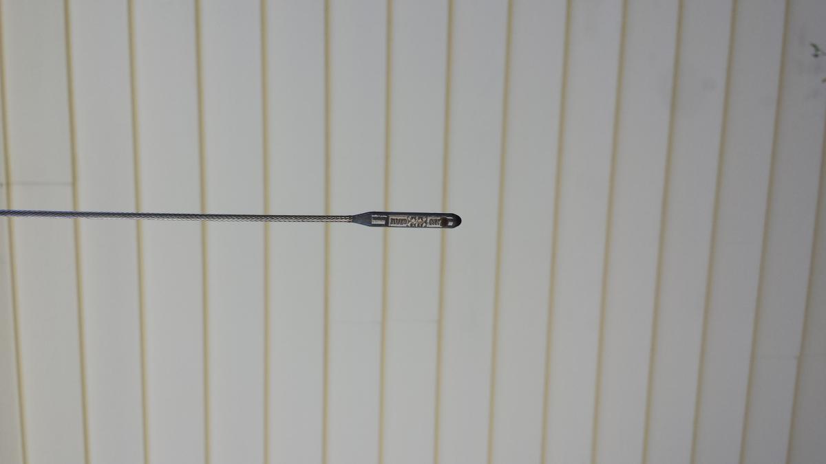

mcali6301 Posted June 24, 2014 Report Share Posted June 24, 2014 How do you re-calibrate the stick? I just checked my tranny fluid, drove home from work 18 miles, turned the car off but then on again, shifted in to each gear then checked. Maybe I'm unsure how to read the dipstick when holding it vertical the fluid sits below the Min mark but there IS some fluid covering the regular mark (x's). I attached a picture of the dipstick (the picture was taken while holdng the distick vertical). the middle (normal level) DOES have fluid on it but the bulk of the fluid is below the MIN mark. If the dipstick should be read horizontal then that might explain the false negative but I am not sure. I don't think the manual does a great job explaining. Quote Link to comment Share on other sites More sharing options...
Mirage52 Posted June 24, 2014 Report Share Posted June 24, 2014 Sounds like you may want to add some more fluid and recheck. If it looks too high when you check again, just drain some fluid out. I did this all the time on my Mariner, haven't on the Edge yet, and it was pretty easy to read the fluid level so you may be overthinking it. Quote Link to comment Share on other sites More sharing options...
akirby Posted June 24, 2014 Report Share Posted June 24, 2014 The vehicle must be on level ground. Make sure you leave the dipstick in place for a little bit so that it gets coated well. Quote Link to comment Share on other sites More sharing options...
mcali6301 Posted June 24, 2014 Report Share Posted June 24, 2014 The vehicle is on level ground. I'm thinking perhaps the dipstick should be checked horizontally. Will try again today when I come home from work. Quote Link to comment Share on other sites More sharing options...
