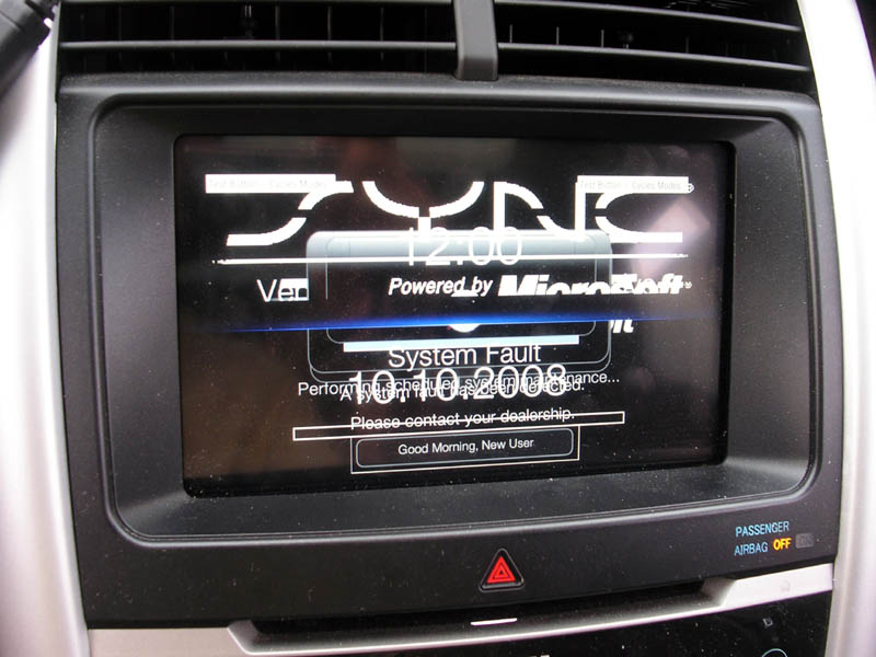

phlatlander Posted September 8, 2011 Report Share Posted September 8, 2011 Thanks for the info Spooki11. Here is our situation, our '11 Edge will be at the dealer's next week. A couple of days ago the sound system (playing an usb/sd card) would simply quit and then resume all by itself. It did this 3 or four times and then yesterday I got the system message "Microsoft performing system maintenance". This morning the sound failed twice and one more "Microsoft" message. This afternoon, I started the car and the screen went blank and then the following message appeared "System Fault 10.10.2008". The touch screen was dead as was the phone, navigation system, backup camera, radio volume, basically anything controlled by the touchscreen. I could still get the radio to play using the steering wheel controls, but only one station on either FM1 and FM2. The cd player worked but you could not forward/reverse to another song After 10 minutes or so the screen came back on and eventually the phone re-connected. We arrived at our 2nd shopping stop and upon restarting, the same screen as above and no screen functionality. I sent the above to Ford, no reply yet. Check out the black screen of death! Quote Link to comment Share on other sites More sharing options...

phlatlander Posted September 13, 2011 Report Share Posted September 13, 2011 Contents of an email I received from Ford regarding the "black screen of death". Hopefully usb problems will be cured by this update. "I apologize for the issue that you are having with the My Ford Touch system in your vehicle. I have done the research and show that you have a very outdated version of the SYNC system installed. The most current version would be Gen2 2.11, and you are running Gen2 2.3. There has been an update released to your local dealership to correct the problems that you are having. I would highly suggest that you contact your dealership to set up an appointment to have Gen2 2.11 installed." Quote Link to comment Share on other sites More sharing options...
