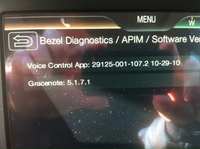

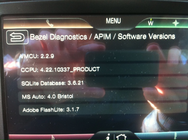

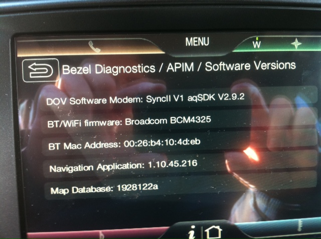

Shaky Posted January 6, 2011 Report Share Posted January 6, 2011 just updated at the dealer within the last hour. Syncmyride indicated that the second generation version needed to be done by the dealer and below that indicated another update that I could have done via USB. This is what is shown on the syncmyride page after the update by the dealer. (Mississauga, Ontario, Canada) BT4T-14D546-AD BT4T-14D546-AG BT4T-14F496-AD BT4T-14F496-AL BT4T-14F496-BJ BT4T-14F497-AD BT4T-14F497-AG SYNC compatible software SYNC compatible software BT4T-14F603-AD BT4T-14F603-AG Link to comment Share on other sites More sharing options...
cirockets Posted January 6, 2011 Report Share Posted January 6, 2011 On 1/6/2011 at 8:04 PM, Shaky said: just updated at the dealer within the last hour. Syncmyride indicated that the second generation version needed to be done by the dealer and below that indicated another update that I could have done via USB. This is what is shown on the syncmyride page after the update by the dealer. (Mississauga, Ontario, Canada) BT4T-14D546-AD BT4T-14D546-AG BT4T-14F496-AD BT4T-14F496-AL BT4T-14F496-BJ BT4T-14F497-AD BT4T-14F497-AG SYNC compatible software SYNC compatible software BT4T-14F603-AD BT4T-14F603-AG I am fairly technically inclined but I am confused about some of those updates/upgrades. For example in the Sync compatible software you have AD then AG. Is AD the previous and AG is after the update? (In other words are they showing the before & after). Mine is showing BT4T-14F603-AG only. Sorry if this post sounds confusing, it is because I am confused!!! Link to comment Share on other sites More sharing options...
wilsons66604 Posted January 6, 2011 Report Share Posted January 6, 2011 On 1/6/2011 at 8:04 PM, Shaky said: just updated at the dealer within the last hour. Syncmyride indicated that the second generation version needed to be done by the dealer and below that indicated another update that I could have done via USB. This is what is shown on the syncmyride page after the update by the dealer. (Mississauga, Ontario, Canada) BT4T-14D546-AD BT4T-14D546-AG BT4T-14F496-AD BT4T-14F496-AL BT4T-14F496-BJ BT4T-14F497-AD BT4T-14F497-AG SYNC compatible software SYNC compatible software BT4T-14F603-AD BT4T-14F603-AG Looks like you chopped off the last portions of the lines where it says the BE at the end of the SYNC compatible software. 1 Link to comment Share on other sites More sharing options...
wilsons66604 Posted January 6, 2011 Report Share Posted January 6, 2011 On 1/6/2011 at 8:16 PM, cirockets said: I am fairly technically inclined but I am confused about some of those updates/upgrades. For example in the Sync compatible software you have AD then AG. Is AD the previous and AG is after the update? (In other words are they showing the before & after). Mine is showing BT4T-14F603-AG only. Sorry if this post sounds confusing, it is because I am confused!!! This is pretty confusing. No idea what it all means but I have been able to see the changes when the update was installed. Check out the screenshot I attached in the previous post and you'll see the BE version 1 Link to comment Share on other sites More sharing options...

Shaky Posted January 7, 2011 Report Share Posted January 7, 2011 (edited) On 1/6/2011 at 8:21 PM, wilsons66604 said: Looks like you chopped off the last portions of the lines where it says the BE at the end of the SYNC compatible software. Nope, just copied and pasted off the syncmyride site?? Edited January 7, 2011 by Shaky Link to comment Share on other sites More sharing options...
samskudd Posted January 7, 2011 Report Share Posted January 7, 2011 On 1/6/2011 at 8:16 PM, cirockets said: I am fairly technically inclined but I am confused about some of those updates/upgrades. For example in the Sync compatible software you have AD then AG. Is AD the previous and AG is after the update? (In other words are they showing the before & after). Mine is showing BT4T-14F603-AG only. Sorry if this post sounds confusing, it is because I am confused!!! Ford part numbers show (Year vehicle) - base part number - revision B stands to 2011 the T4T must be the edge, the base part number, then revision Link to comment Share on other sites More sharing options...
cirockets Posted January 7, 2011 Report Share Posted January 7, 2011 On 1/7/2011 at 5:31 PM, samskudd said: Ford part numbers show (Year vehicle) - base part number - revision B stands to 2011 the T4T must be the edge, the base part number, then revision Thanks for the explanation. Link to comment Share on other sites More sharing options...
