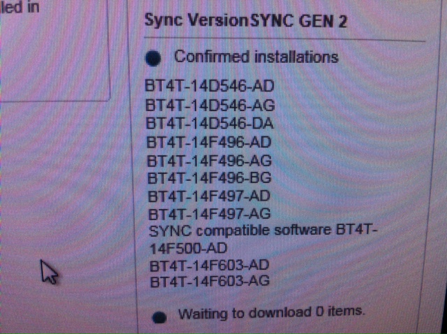

fdlarsen Posted December 30, 2010 Report Share Posted December 30, 2010 just guessing, but what may have happened is that when your "latest" version was loaded, they did not pass the successful update back to syncmyride site. If you have done an update from Sync there are 3 steps, download the update to thumb drive, load update in car, then come back to sync sight with USB plugged into computer and acknowledge the update was successful, I think when you click the update status button , the usb drive you used passes the status back to sync. I did all those steps before and did them again today when I got the Edge back. Without knowing the software they use, I don't know enough to walk in and argue with them. Is there a ford support number besides a dealer? Link to comment Share on other sites More sharing options...
wilsons66604 Posted December 30, 2010 Report Share Posted December 30, 2010 I did all those steps before and did them again today when I got the Edge back. Without knowing the software they use, I don't know enough to walk in and argue with them. Is there a ford support number besides a dealer? If you are registered at www.syncmyride.com, go to this link It will show you when and what version has been installed. Also, if you don't have the latest software installed, the website will tell you that you need an update. 1 Link to comment Share on other sites More sharing options...

fdlarsen Posted December 30, 2010 Report Share Posted December 30, 2010 If you are registered at www.syncmyride.com, go to this link It will show you when and what version has been installed. Also, if you don't have the latest software installed, the website will tell you that you need an update. Yes I am, and I uploaded a fresh version check once I returned. Based on the issues I have being minor, I think I may just wait a month for my oil change considering I am pretty certain my dealer hasn't updated MFT on any other Edge's yet. I don't want to be the first. Link to comment Share on other sites More sharing options...

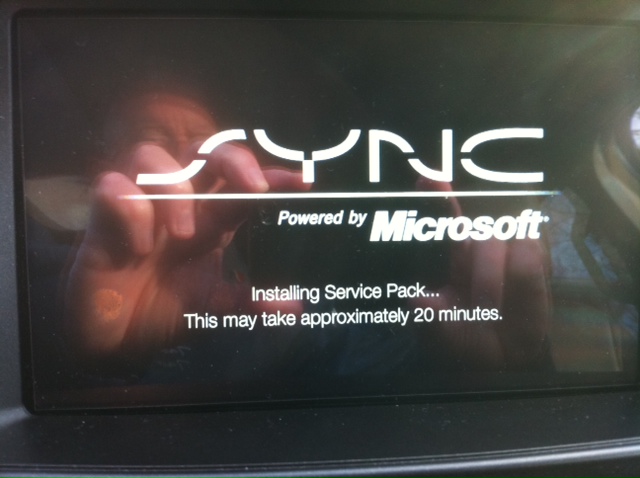

Neil McLaughlin Posted January 4, 2011 Report Share Posted January 4, 2011 Finally, here is some good news to share based upon my experience after the Sync Upgrade today. I am in Canada and the dealer applied the SYNC Gen 2 update BT4T-14D544-BD. It took about 2 hours including testing. They had downloaded the update previously and had it on a USB stick according to the service rep. I have had this 2011 Edge Limited AWD for about two months and have driven about 5,000 kms. The Sync had rebooted itself 2 times and I had pulled the #29 fuse another 5 times or so over this period. I had found that the main reason for a system freeze or reboot was related to multiple phones or iPod connections. When I was just connecting Bluetooth to my Blackberry 9700, there would be no issues and all ran fine for several weeks after I discovered the iPod issue was causing the problems. However, at Christmas, family members who received new iPod's and an iPhone 4(all running latest OS 4.2) wanted to use them in the Edge understandably. Same issues resulted with fuse pulls and reboots. After reading many posts of other frustrated MyFordTouch owners, especially those who lost their vehicles for weeks or had more issues after the upgrade, I was quite concerned about the upgrade. However, the service rep told me they had completed several successful installs. So I took the risk hoping that I can also get some new functionality that had not worked yet for me or most others such as Mobile Internet and simultaneous Bluetooth pairing. I am a fairly technical user and have tried every function of the system including many attempts at the internet connectivity via all means and types of phones/USB connections available to me. MyFordTouch system version after update: CCPU SW Ver 4.22.10308_PRODUCT. Although, I am not sure if this changed as a result of the update. Fortunately, none of the issues others had posted were repeated in my case. Everything works the same or better and a couple of items now work for the first time after the update. Improvements after the upgrade: - successfully pair with iPhone 4, iPods(3G and 4G) and Blackberry 9700 simultaneously - could use either BB or iPhone on Bluetooth connection to BT Stereo audio by switching between units in BT settings - could use either BB or iPhone on Bluetooth connection for phone by switching favourite phone - could have either BB or iPhone as system phone while using other for BT Stereo audio - iPods(3G and 4G) did not crash system. Although, song and artist titles still do not appear. Just the device name(same with iPhone BT audio). New functionality after the upgrade: - Mobile Internet!!! Yes, it really does work. - while I am still unsure what Ford intends to do with a wi-fi connection to my home network, there is great benefit to having internet connectivity while on the road. - there was only one post on the forums that I read that indicated someone was successful. However, they included no details and I know others were looking for help. - also, it makes no sense to me that a user would have to buy a USB stick just to use with their MyFordTouch when Blackberry's, iPhones and lots of other phones support internet tethering via USB or better yet, Bluetooth. However, this is what the manuals and marketing tell you to do. Fortunately, there is a better way!!! - I will briefly describe the process to get this operational and I trust that Ford will publish a much more detailed set up process than what is available in the manual or on the SyncMyRide website. - also, Ford should regularly post the list of tested/approved(or at least capable) phones/USB devices that support this capability. - first of all, to be sure that I really was connecting to the internet over the cell network and all devices in the Edge were connecting only to the Edge wi-fi and not the house wi-fi, I drove to a secluded spot to ensure a controlled test. One might also assume that driving down the highway would yield the same result. Although, I am sure Ford was smart enough(I hope) to shut down the set up process if the vehicle was in motion. I was alone so I could not try to do this while driving. - just a note, I could have chosen the Sync wi-fi network vs the house but still, I wanted to be free of other network noise. Will try it in driveway later. - second, I had to have a phone that would support PAN networking with Internet Tethering. The BB 9700 does not have this capability. However, my partner's shiny new iPhone 4 certainly does support that via Bluetooth or USB. So, having all the required hardware, I was able to move ahead past MFT menu options that were previously blank or showed "no suitable device detected". - third, ensuring that the iPhone was in "Internet Tethering" mode, 3G was enabled, data was enabled and Bluetooth was connected to MFT, I entered the Wi-Fi configuration screens and configured as follows: - Turn on Wi-Fi, choose Bluetooth Internet Data Connection, PAN networking connection must be chosen, Client must be chosen, Internet Gateway must be enabled and configured with desired security(I used WPA2 which worked fine). - finally, the rest was typical wi-fi hotspot connection requirements for devices to connect to the MFT. From the device(I tried a ThinkPad, 2 different iPods, my Blackberry 9700 and an Apple MacBook Pro). All worked fine. Just like connecting to any protected wi-fi zone. Need to enter the security key configured on the MFT by default or as entered manually. Security method is optional(WEP, WPA, WPA2) on the MFT. - I did an internet speed check and it was certainly not that fast. After several checks, the max download speed averaged around 320 kbps and upload just slightly less. These are not 3G speeds so I am not sure if that is a MFT issue or Sync or maybe the iPhone. I was definitely at high strength and in a 3G zone, so I hope that can be rectified. I will do more tests in other places and see if I get varied and hopefully better results. - interesting to note, not sure if this is as designed or just a fluke but if I switch from the iPhone to the Blackberry 9700 as Favourite phone, the internet connection does not get dropped. Therefore, conceivably, one could be talking on Blackberry via Sync connection and another person in vehicle surfing the net via the iPhone. More tests needed here. Existing issues: - receiving text message on iPhone with Notification as Text to Speech caused the system to lock up and reboot. Successive attempts also failed. the iPhone 4 is supposed to support this feature so I am not sure why it crashed the MFT. I will try again another day. Would be interested to hear if others are successful. - text display options under Media options remains blank. Same as before. I have no idea what this function is intended to do - phone device information under Bluetooth settings is not refreshed when phone is changed(unless vehicle is restarted) New Update Available: - interestingly, I just checked the SyncMyRide site and the following new update is available for user installation BT4T-14D544-BE Version SYNC GEN 2 BT4T-14D544-BE BT4T-14D544-BE - maybe I will try that next week after I review some other posts related to that one. I feel that I have benefitted from being a late adopter on the Sync Gen 2 upgrade. Best of luck to others on this Sync Gen 2 update. I hope your results will be as surprisingly positive as mine. Link to comment Share on other sites More sharing options...
