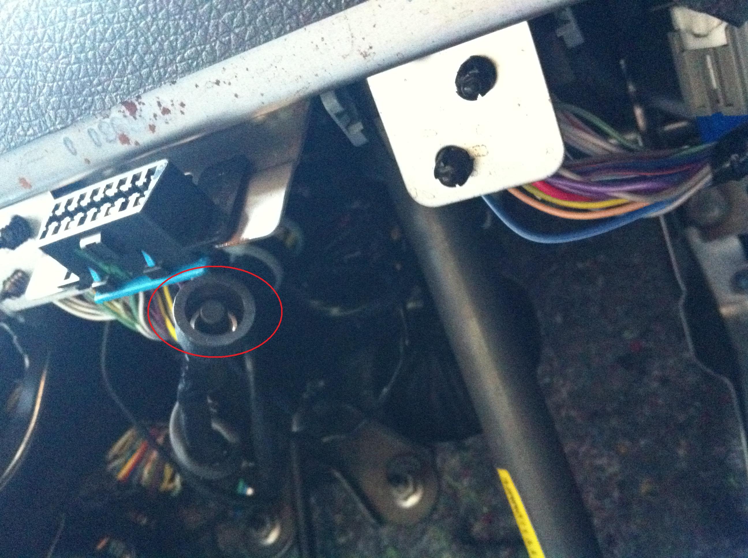

rvallely Posted March 20, 2011 Report Share Posted March 20, 2011 On 3/20/2011 at 7:07 PM, wil said: When trying to enter programming mode are u hitting the dark blue button or the black one? The long black wire with a boulbous end and black button seems to me the button u should be pushing to enter programming. I know the button I push is black. I've attached a picture of it for you. I didn't see any other buttons on it. Quote Link to comment Share on other sites More sharing options...
wil Posted March 24, 2011 Author Report Share Posted March 24, 2011 On 3/20/2011 at 7:37 PM, rvallely said: I've attached a picture of it for you. I didn't see any other buttons on it. Sorry for the late reply - just saw your pic. I don't have that located under my steering column - nor am I aware I have that piece altogether. If I do - it's tucked up under my dash. I'm begining to think we have different remote starters. In doing research about turning off this feature - I remember reading that some dealers could have installed a different car starter unit but still used the Ford 1 button key fob (not sureif this is even possible - I just remember reading it). That might be your scenario. My unit was not "factory" installed but it does behave like the steps that are described in the programming - so I'm left to believe it's an OEM unit. Sorry I couldn't be of anymore help - I'm not super familiar with different types of car starters - I had just came across the documentation that is used for OEM Ford starters and wanted to share it. Good luck with trying to turn off that feature - it's really annoying!!! wil Quote Link to comment Share on other sites More sharing options...
rvallely Posted March 25, 2011 Report Share Posted March 25, 2011 On 3/24/2011 at 10:00 PM, wil said: Sorry for the late reply - just saw your pic. I don't have that located under my steering column - nor am I aware I have that piece altogether. If I do - it's tucked up under my dash. I'm begining to think we have different remote starters. In doing research about turning off this feature - I remember reading that some dealers could have installed a different car starter unit but still used the Ford 1 button key fob (not sureif this is even possible - I just remember reading it). That might be your scenario. My unit was not "factory" installed but it does behave like the steps that are described in the programming - so I'm left to believe it's an OEM unit. Sorry I couldn't be of anymore help - I'm not super familiar with different types of car starters - I had just came across the documentation that is used for OEM Ford starters and wanted to share it. Good luck with trying to turn off that feature - it's really annoying!!! wil That's ok. I appreciate your trying to help. I'm going to the dealership for an appointment on Friday to have them reprogram it...and to turn on my DRL's. I'll let you know if they were able to fix it. They say they can. Quote Link to comment Share on other sites More sharing options...
rvallely Posted March 27, 2011 Report Share Posted March 27, 2011 On 3/25/2011 at 5:03 AM, rvallely said: That's ok. I appreciate your trying to help. I'm going to the dealership for an appointment on Friday to have them reprogram it...and to turn on my DRL's. I'll let you know if they were able to fix it. They say they can. Ok...went to the dealership Friday, and they reprogrammed the remote start and the daytime running lights - at no charge. So, I'm good to go. Thank you for all your input. I appreciate your taking the time out to respond. For those who are curious...the dealer was Marshall Ford, in O'Fallon, Missouri. Quote Link to comment Share on other sites More sharing options...

archer11ca Posted August 6, 2011 Report Share Posted August 6, 2011 Wow this was really helpful, it took a while to find the programming/overide button. Mine was tucked in and tiewrappered with a bundle of wires. tried to do the programming without the LED and was that ever a mistake lol. Took a while to find it as well and had to use a mirror to see it while doing the programming. Once I did that I was able to make the switch no problem at all and fix what I had messed up. To answer why one would make this change, it's for two reasons. 1. less wear and tear on the starter motor and two just the convenience factor. Mty Girlfriend always laughed at me that the engine shut off because I opened her door first. Well thanks again, the internet has proven very usefull once again. DS Quote Link to comment Share on other sites More sharing options...

beefcake Posted December 20, 2011 Report Share Posted December 20, 2011 well, i've been looking under the dash on my expedition and i can't find it. i called a tech at the ford dealership, he said if the vehicle is equipped with sync, that it has a different module that goes through the CAN system or something like that, and it does not have a programming button do any of you that have been successful have sync? Quote Link to comment Share on other sites More sharing options...
beefcake Posted December 20, 2011 Report Share Posted December 20, 2011 my tech guy at the ford dealership said on "sync" equipped vehicles, their is no button to put the vehicle in programming mode. i have a 2011 expedition that has the extra "single" button in addition to the regular key. does anyone have this same setup, factory 4 button key with the single remote fob, and has sync that has done this. i cannot find a button anywhere under the dash Quote Link to comment Share on other sites More sharing options...
wil Posted December 20, 2011 Author Report Share Posted December 20, 2011 My 2010 edge has sync+Nav and is not a push button start. I've posted a pic of what my button looks like earlier - hope that helps. I also have a single button RMST button in addition to my 4 button key/remote. Quote Link to comment Share on other sites More sharing options...
