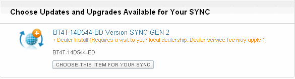

wilsons66604 Posted December 7, 2010 Author Report Share Posted December 7, 2010 This showed up on the SyncMyRide site today BT4T-14D544-BD Version SYNC GEN 2 BT4T-14D544-BD BT4T-14D544-BD Quote Link to comment Share on other sites More sharing options...
Sundedo Posted December 7, 2010 Report Share Posted December 7, 2010 This showed up on the SyncMyRide site today BT4T-14D544-BD Version SYNC GEN 2 BT4T-14D544-BD BT4T-14D544-BD What do you show as the confirmed installations? I show this on my syncmyride for: Sync VersionSYNC GEN 2 Confirmed installations BT4T-14D546-AG BT4T-14F496-AG BT4T-14F497-AG Quote Link to comment Share on other sites More sharing options...
wilsons66604 Posted December 7, 2010 Author Report Share Posted December 7, 2010 (edited) Here is what mine is now before any updates Sync Version1.3 Update availableConfirmed installationsBT4T-14D545-BA BT4T-14D546-AD BT4T-14F496-AD BT4T-14F497-AD SYNC compatible software BT4T-14F500-AD BT4T-14F603-AD Edited December 7, 2010 by wilsons66604 Quote Link to comment Share on other sites More sharing options...
