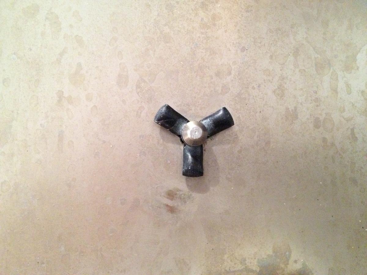

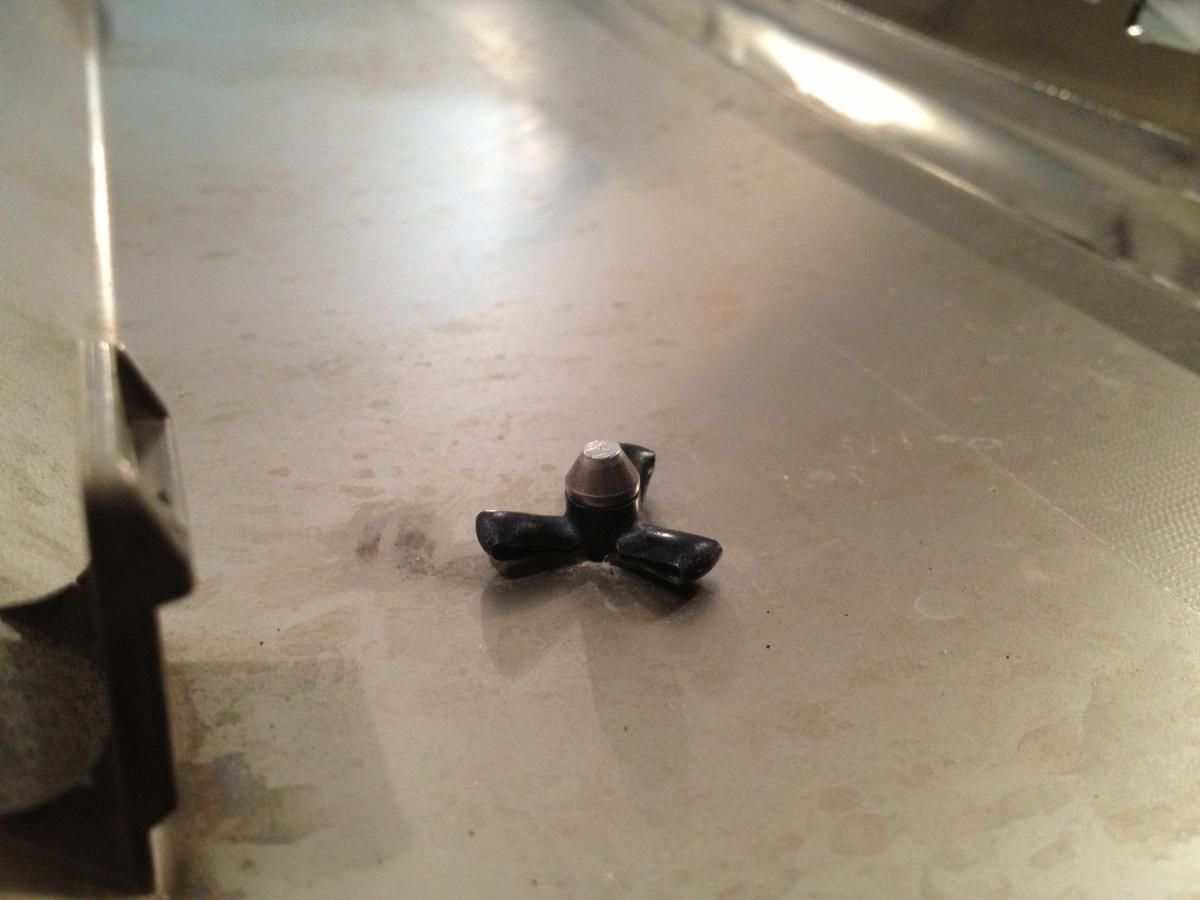

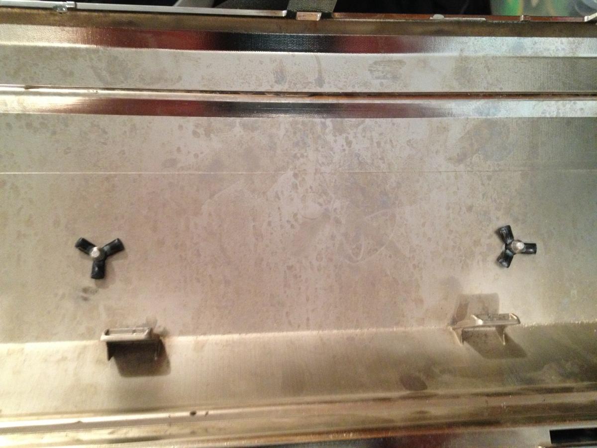

candurin Posted August 18, 2013 Report Share Posted August 18, 2013 I don't know if it helps you all or not. But since I just replaced my grilles, I went and took a few photos of the rear of the license plate bracket so that you could see what you are dealing with. Actually, it took me less than 20 minutes to remove and replace my bumper. May be worth it to those of you having trouble drilling out the rivets. Quote Link to comment Share on other sites More sharing options...
