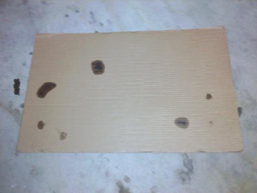

mtbalser Posted December 8, 2011 Report Share Posted December 8, 2011 Where under the vehicle is this puddle and what does the fluid look like for reference please? I just took my 2012 Edge AWD to dealership for a leak under engine. They just called and suspect leaking PTU. No specific area, under front of vehicle, sort of all over in dime to fifty cent size drops. Fluid is much more viscus then engine oil. 1,300 hundred miles and touch/sync, power liftgate and PTU are having issues, not a good sign. I guss I should have bought the Lexus RX350. Quote Link to comment Share on other sites More sharing options...
