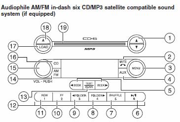

carbonedge+ Posted November 18, 2010 Report Share Posted November 18, 2010 Just picked up a used 2007 edge sel plus. I noticed on the way home the backlight on the radio didn't work. Then I tried the steering wheel audio controls and they didn't work. I also couldn't find the satellite radio button on the radio either, even though there is an antenna. I am guessing whoever had it before sold the upgraded radio and replaced it with the standard one before trading it in? Can anyone help comfirm this? Thanks! I have an '07 SEL+. Your buttons on the radio should look like the diagram below. Also, you toggle through the AUX button for LINE IN, SAT1, SAT2, and SAT3 (if equipped). Quote Link to comment Share on other sites More sharing options...
2007selplusedge Posted November 18, 2010 Author Report Share Posted November 18, 2010 I have an '07 SEL+. Your buttons on the radio should look like the diagram below. Also, you toggle through the AUX button for LINE IN, SAT1, SAT2, and SAT3 (if equipped). Its not a 6 disc changer but looks identical other than that. Quote Link to comment Share on other sites More sharing options...
carbonedge+ Posted November 18, 2010 Report Share Posted November 18, 2010 (edited) Okay, that means you have the single disc unit which (for all else) functions just the same (if properly equipped). You might try checking fuses if you haven't already. Oh, and as for the satellite radio, I'm guessing the subscription has probably lapsed, but if you press the AUX button to SAT1 (or 2 or 3), it will give you a screen message to call SIRIUS and display a phone number as well. You just have to watch a few seconds for it to display everything. Edited November 18, 2010 by carbonedge+ Quote Link to comment Share on other sites More sharing options...
