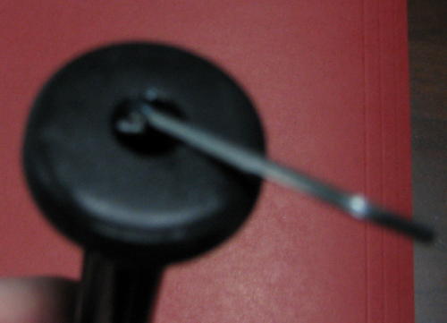

Dreamss Posted November 20, 2010 Report Share Posted November 20, 2010 I figured it out!!! I had the same problem as everyone today and looked it over and saw how to properly remove them!!!! On iPhone now, will post info tonight Quote Link to comment Share on other sites More sharing options...
brigrib Posted November 21, 2010 Author Report Share Posted November 21, 2010 I figured it out!!! I had the same problem as everyone today and looked it over and saw how to properly remove them!!!! On iPhone now, will post info tonight I'd read the manual as had the dealer who had no more luck than I had. We found both buttons although the inboard one is well hidden. The problem remains: The inboard post will not release. Let me know if you actually get them out. Thanks Quote Link to comment Share on other sites More sharing options...

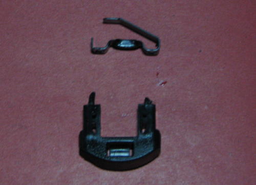

Dreamss Posted November 21, 2010 Report Share Posted November 21, 2010 Actually, I've owned my Edge for about 2 weeks now and haven't even had the chance to open a manual or any other booklet that came with the car lol, I'm winging it for now and so far so good! I wound up selling an old pair or speakers that I owned to a friend and knew I had no choice but to lower the rear seats if I was going to be able to fit them in the car at all. I also remember reading this posting and knew I may be in for some trouble so I was going in prepared for a fight! I started with the seats completely upright to see what the release latch setup was like. I was used to other cars which had a release "push button" on each pole of the headrest but when I looked closely, it seemed like the pole closest to the window had the button sticking out (meaning you can push it in) whereas the other pole had the same exact button but it looked like it was already pushed in?? I found that so odd??? Anyhow, I pushed the button closest to the window in and tried pulling out the headrest. Like everyone else, mine got stuck at the last notch and I could not get it out any further. I tried messing around with the button that already seemed push in and still nothing. I yanked a little and tugged but at this point I knew it wasn't coming off. I looked carefully at the poles and noticed that the side closest to the window was not "stuck", meaning, if I wanted to, this pole could be ripped out, it was loose and it wanted to get out. I then noticed that the other side was not as loose and that it seemed locked. Right away I knew I had to look more carefully at this side and figure out why it was still locked. I was convinced that the push button was broken inside and should have been popped out but with everyone having the same problem, I ruled that out right away. There is something we are just not seeing and I didn't trust to even look at the manual as most of you already have with no luck. I then thought to myself, this car is all about touch and cool tech, maybe that's what I need to mess with the get it out? I started rubbing and caressing the head rest and I heard a latch "pop!! The headrest had actually popped out! I was shocked! I pushed it back in just to make sure I wasn't crazy and tried again...I put the headrest all the way down and swiped my hands across the headrest and poof, it popped again! The headrest it actually touch activated!!! You just need to open your fingers when you swipe to make sure you get the right spot dead on..... . . . . Ok, just kidding lol, the release for the headrest is actually in the MFT menu. On your home page, touch menu, setting, vehicle, and then press "headrest release". It's one of those undocumented features . . . Ok ok....I’ll be serious now!!!! After carefully examining the inside button on the pole that seemed locked, I noticed a hole. This instantly peaked my curiosity so I grabbed an Allen key from my tool box just beside me, the smallest key in the pack, and poked it inside. After doing so, I felt like a little "bump" if you want to call it that and pulled on the headrest and it came right out, very easily and seamless I did try it 2 or 3 times to make sure this was indeed the right way to do it and yes it is, it worked each and every time. I think this is retarded, if I was actually out somewhere and needed to fold down my seats last minute, I would have been screwed. Who carried a tiny little pin or whatever on them at all times and it's stupid that I would need that to release the headrest, to me, this makes no sense at all. I'm lucky I was at home playing around with it, I would have been furious if I needed it down while I was out and I couldn't do it. Also, the rear seat needs to be about 1/2 way down to remove the headrest, if it’s all the way up, you will hit the roof before it's completely out. Here are some picks I just took from my garage 5 minutes ago. Sorry, they are dark but it's just to give you an idea. Please try this out and let me know if it works for everyone Quote Link to comment Share on other sites More sharing options...
Trisha07.07.07 Posted November 22, 2010 Report Share Posted November 22, 2010 You are so clever Dreamss (funny too). That was quite an interesting read. I'm not sure I will ever want to take this headrest out but now I know I can if I need to. You have probably made life easier for a lot of folks! Kudos!!! :party2: Quote Link to comment Share on other sites More sharing options...
wilsons66604 Posted November 22, 2010 Report Share Posted November 22, 2010 Great work Dreamss! I noticed that hole but g wiz, I made the mistake of reading the manual Quote Link to comment Share on other sites More sharing options...
brigrib Posted November 24, 2010 Author Report Share Posted November 24, 2010 Many thanks for solving my rear headrest issue. In fact I took the car to my dealer who had pronounced them "fixed and not capeable of being removed'. I showed his trim guy your pics and out they came. I like my Edge but Ford needs to step up and report to owners and dealers about issues and errors in the manual. I shouldn't have to rely on other owners to solve issues. Quote Link to comment Share on other sites More sharing options...
richy Posted November 25, 2010 Report Share Posted November 25, 2010 Dreamss, you just reinforced why belonging to forums is so damned important! Kudos to you bud. Thanks for taking the time to photograph the hole in the adjuster too so it is crystal clear to anyone reading the post. (Like your sense of humour too!) Now to remember to stick a small allen key in the glovebox if and when I ever get mine. Quote Link to comment Share on other sites More sharing options...
HotLap Posted December 18, 2010 Report Share Posted December 18, 2010 Nice write up Dreams....everyone should practice removing thier headrest then put the removal tool (allen wrench or whatever) in the glovebox or under the rear cargo floor...there's GREAT storage under there!!! Quote Link to comment Share on other sites More sharing options...
tjbron Posted February 24, 2011 Report Share Posted February 24, 2011 Thanks so much for figuring this out. I read the manual (like an idiot) and was trying to push that non-button. When I noticed that the front seats had actual buttons on both posts, I quit. My next step was going to be trying to pop out the little non-button with something like an allen key in that hole. Maybe I would have figured it out, but more likely, I would have messed up the plastic and been cussing. Why couldn't they make them the same as the fronts??? Especially when that is what the manual states. Quote Link to comment Share on other sites More sharing options...

flightplannerjim Posted April 12, 2011 Report Share Posted April 12, 2011 Has anyone with a recent build (mine was a March 2011 build) successfully removed the rear headrests? I've tried removing mine according to what I've read on here but cannot do it. The buttons on my headrest adjustments do not have any little holes to poke an allen wrench or any other tool into. Could it be that Ford has closed that "loophole" on newer builds? Appreciate any new info. Thanks in advance. Quote Link to comment Share on other sites More sharing options...
flightplannerjim Posted April 13, 2011 Report Share Posted April 13, 2011 Many thanks guys. One of these days I'm going to learn to read what is written instead of what I THINK is written. I was looking for the little hole IN THE ADJUSTMENT BUTTON instead of the "collar" around the other headrest post. Of course it isn't in the button. My headrests are now packed away in a plastic bag in my garage. Have a super day to all. Quote Link to comment Share on other sites More sharing options...
