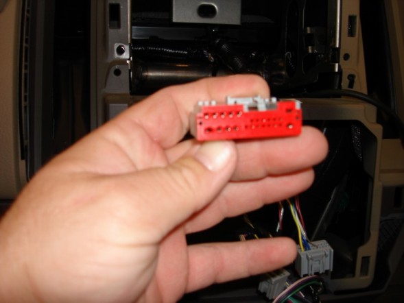

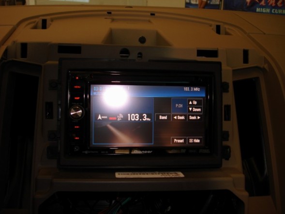

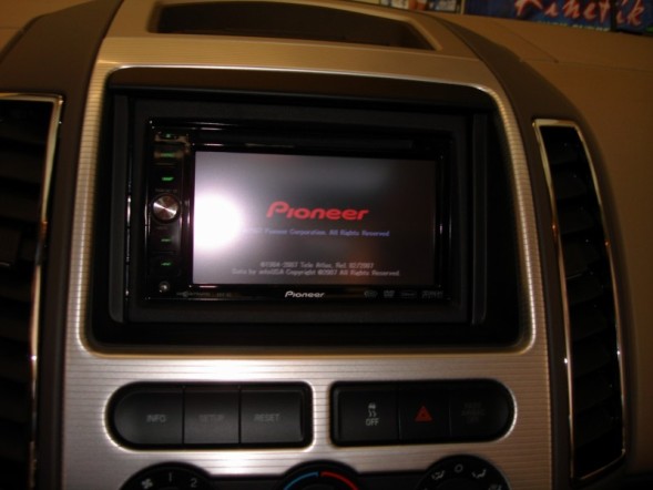

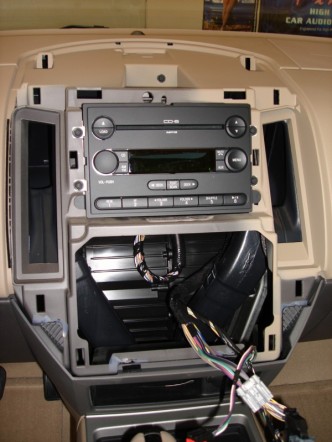

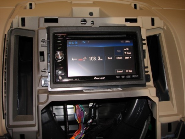

securinu Posted May 9, 2007 Report Share Posted May 9, 2007 This is an install from start to finish 1 Quote Link to comment Share on other sites More sharing options...

RayoVac Posted May 10, 2007 Report Share Posted May 10, 2007 Yes way less expensive with way more oprions. They take about 2 hours to do Yes you retain the steering wheel control If you already have the audiophile system with sub woofer, can you easily utilize the factory sub? What about amps, do you know if the Audiophile uses any kind of external amp for the sub, or is it all in the head? And if so, how hard is it to get output from one of the Pioneers to the sub? Thanks in advance, Rayo Quote Link to comment Share on other sites More sharing options...
securinu Posted May 10, 2007 Author Report Share Posted May 10, 2007 If you already have the audiophile system with sub woofer, can you easily utilize the factory sub? What about amps, do you know if the Audiophile uses any kind of external amp for the sub, or is it all in the head? And if so, how hard is it to get output from one of the Pioneers to the sub? Thanks in advance, Rayo It has a seperate amp and there is an adapter to plug in to that harness on the back of the radio. Quote Link to comment Share on other sites More sharing options...

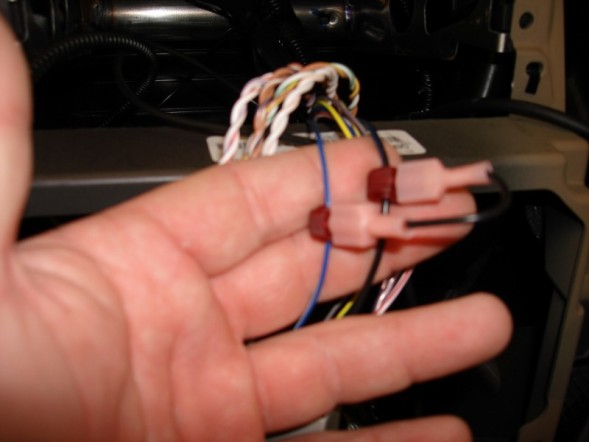

securinu Posted May 16, 2007 Author Report Share Posted May 16, 2007 Well we have sold a one to someone i here i think . He bought a Avic D3 ipod cable and xm navtraffic with steering wheel control. You also need a dash kit a wire harness and antenna adapter . We can wire it all except for the park brake and vss if you want to do something like that and also install the deck into the kit we do that all the time for other customers then all you need to do is pop off the dash and tap 2 wires . Quote Link to comment Share on other sites More sharing options...
ike Posted May 16, 2007 Report Share Posted May 16, 2007 We can wire it all except for the park brake and vss if you want to do something like that and also install the deck into the kit we do that all the time for other customers then all you need to do is pop off the dash and tap 2 wires . I assume VSS = Vehicle Speed Sensor ? Can you tell us how to find this wire to tap ? This apparently makes the Pioneer AVIC D3 much more accurate for navigation. Quote Link to comment Share on other sites More sharing options...

ike Posted May 18, 2007 Report Share Posted May 18, 2007 ...and find out how to bypass the nav/dvd deal while the car is mooving. Its not for me, but for the passenger rider. I would think all you need to do is put a switch in for the parking brake wire (instead of connecting it to the parking brake) from the Navigation unit. When the switch was "on", it would think you are stopped and it would allow you to input whatever you wanted. When you're done, hit the switch again and it'll think you're moving. Quote Link to comment Share on other sites More sharing options...
xplorgee Posted May 19, 2007 Report Share Posted May 19, 2007 I found out on the AVIC-D3, you move the yellow wire on the white connector from the bottom to the top. You then ground the light green wire on the black harness and the yellow wire you just moved. Thats about it. I head it works from AVIC411.com. How hard is it to remove the front panel of the stereo? How is it done. I think its one piece. Where should I start pulling from? Quote Link to comment Share on other sites More sharing options...

firewolff Posted May 25, 2007 Report Share Posted May 25, 2007 Also, where is the stock sirus wire run? Is it on the driver side or passenger bottom rail? The complete sirius unit is located in the back of the vehicle open the hatsch pull the plastic entrance plate off and look down its mounted on the drivers side undo the two bolts unplug it your ready to upgrade to an aftermarket. the plastic cover on the antenna can be removed to use with your unit although my reception is not as strong as it was with actual pioneer ant. but I didnt want extra stuff all over the roof. Quote Link to comment Share on other sites More sharing options...
