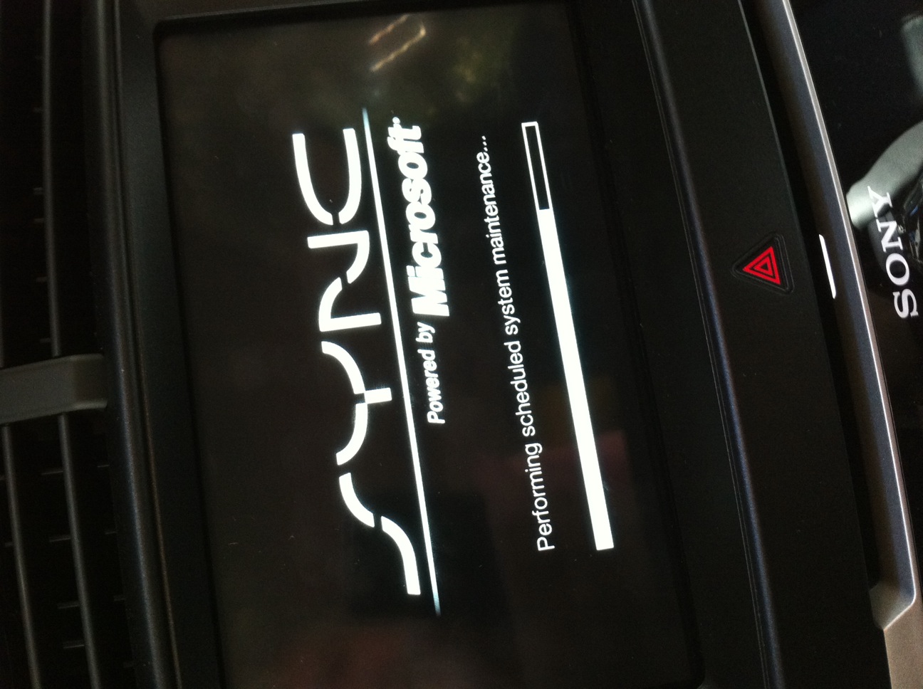

wilsons66604 Posted September 24, 2010 Report Share Posted September 24, 2010 I had my iPhone 4 paired and working with Bluetooth. Today it lost the pairing and I can't get it back. I've deleted the device, turn Bluetooth off on on mytouch. Rebooted phone When I select add device, Ford flashes the pairing code for a split second then says pairing failed. Anyone seen this issue? Quote Link to comment Share on other sites More sharing options...
wilsons66604 Posted September 24, 2010 Report Share Posted September 24, 2010 (edited) On 9/24/2010 at 5:16 PM, wilsons66604 said: I had my iPhone 4 paired and working with Bluetooth. Today it lost the pairing and I can't get it back. I've deleted the device, turn Bluetooth off on on mytouch. Rebooted phone When I select add device, Ford flashes the pairing code for a split second then says pairing failed. Anyone seen this issue? I ended up downloading the Sync update onto a USB drive. It was listed under Dealer-Installed Upgrades and SYNC Tools Plugged it into car Started car Sync rebooted and installed the update I was able to pair phone again. I don't know if it really worked but it did cause a reboot. This is what I think I installed. BT4T-14D546-EA Version SYNC GEN 2 Gen II Interrogator Part BT4T-14D546-EA Edited September 24, 2010 by wilsons66604 Quote Link to comment Share on other sites More sharing options...
carfaninpa Posted September 25, 2010 Report Share Posted September 25, 2010 (edited) I plan to do this update tomorrow. You said you inserted the USB before starting the car. I was going to insert it after starting the car and having the SYNC booted. Is there a preferred sequence? The SYNC site says to use a USB flash drive dedicated only to SYNC updates. Somehow it can keep track of your updates that way so I am buying a fresh USB drive tomorrow. Edited September 25, 2010 by carfaninpa Quote Link to comment Share on other sites More sharing options...
bpattie Posted September 25, 2010 Report Share Posted September 25, 2010 On 9/25/2010 at 12:50 AM, carfaninpa said: I plan to do this update tomorrow. You said you inserted the USB before starting the car. I was going to insert it after starting the car and having the SYNC booted. Is there a preferred sequence? ot really sure nut think I did mine after turning on the car, but I do' t think it would really matter. Quote Link to comment Share on other sites More sharing options...
wilsons66604 Posted September 25, 2010 Report Share Posted September 25, 2010 I tried plugging it in while started last night then I had to pick a update sync from menu. It didn't act the same as when I plugged it before I started car. .today was the first time I saw that sync update screen that I attached earlier Quote Link to comment Share on other sites More sharing options...
lakleeman Posted September 25, 2010 Report Share Posted September 25, 2010 On 9/24/2010 at 6:43 PM, wilsons66604 said: I ended up downloading the Sync update onto a USB drive. It was listed under Dealer-Installed Upgrades and SYNC Tools Plugged it into car Started car Sync rebooted and installed the update I was able to pair phone again. I don't know if it really worked but it did cause a reboot. This is what I think I installed. BT4T-14D546-EA Version SYNC GEN 2 Gen II Interrogator Part BT4T-14D546-EA Wilsons, did you bring the USB back to your desktop after the update -- so the syncmyride website knows your car has been updated? I tried this a couple weeks ago, and the website kept giving me an error. I contacted Ford and they said my car never needed the update (that you mention) - although apparently my car accepted it. They still didn't solve the problem for me of updating the syncmyride website. (Syncmyride is supposed to track the updates you've done - so it will know when you need a new update.) Quote Link to comment Share on other sites More sharing options...
wilsons66604 Posted September 25, 2010 Report Share Posted September 25, 2010 On 9/25/2010 at 2:26 PM, lakleeman said: Wilsons, did you bring the USB back to your desktop after the update -- so the syncmyride website knows your car has been updated? I tried this a couple weeks ago, and the website kept giving me an error. I contacted Ford and they said my car never needed the update (that you mention) - although apparently my car accepted it. They still didn't solve the problem for me of updating the syncmyride website. (Syncmyride is supposed to track the updates you've done - so it will know when you need a new update.) I tried to update the website but didn't work. I'm not sure anything updated on the car but at least I now have a way to reboot sync. Plug the usb in then start the car. Quote Link to comment Share on other sites More sharing options...
