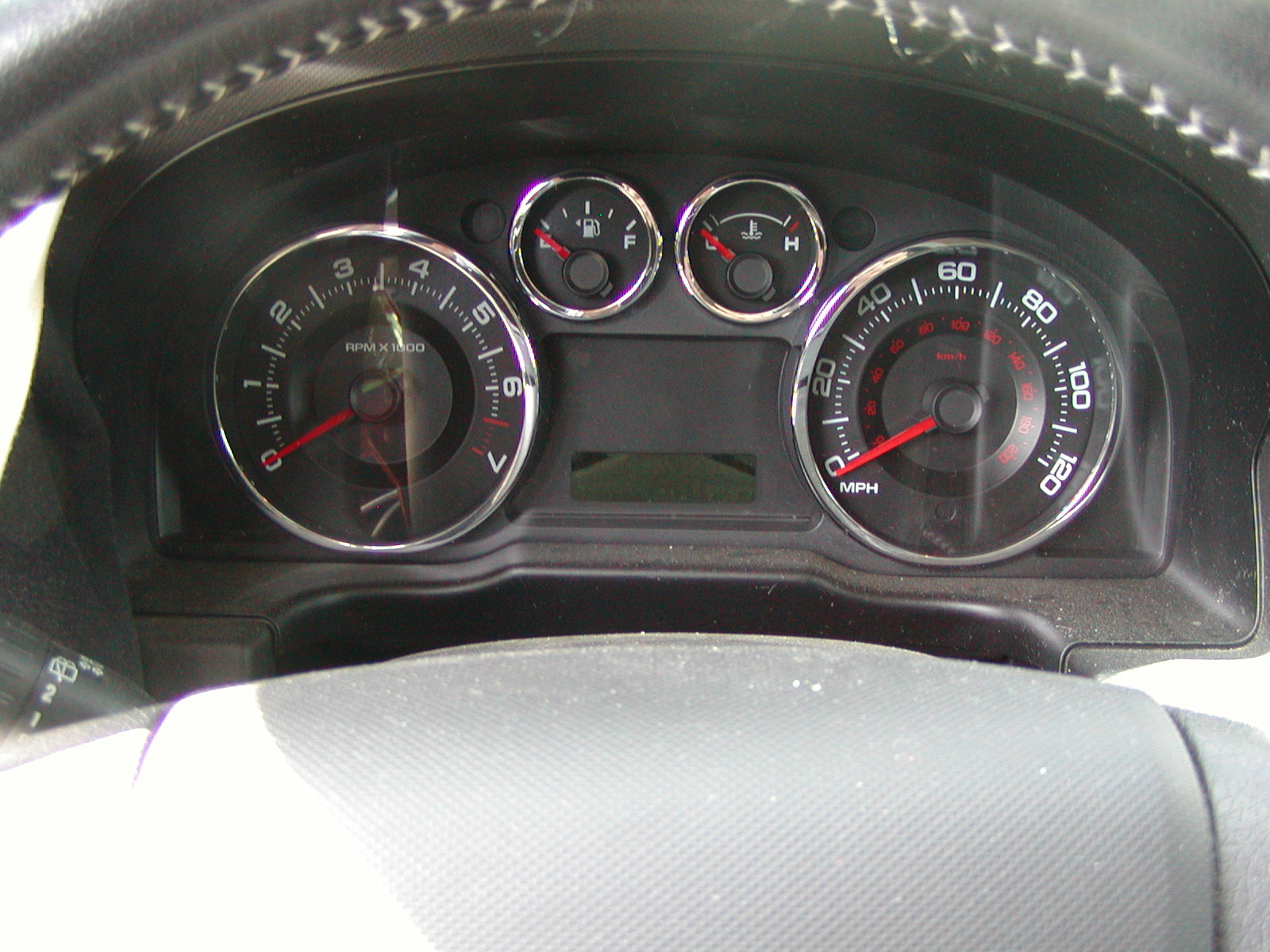

er65nsunny Posted September 6, 2010 Report Share Posted September 6, 2010 Recently changed the silver gauge face to black. They are much easier to see than the silver facees. I think Ford should have done this with all the Edges. Quote Link to comment Share on other sites More sharing options...
Lex Talionis Posted September 6, 2010 Report Share Posted September 6, 2010 can you expand on this? where did you get, how much, install difficulty? oh.. and clean up that dust Quote Link to comment Share on other sites More sharing options...
livinonthedge Posted September 7, 2010 Report Share Posted September 7, 2010 Recently changed the silver gauge face to black. They are much easier to see than the silver facees. I think Ford should have done this with all the Edges. Very nice indeed. As mentioned above, can you provide details on this? Quote Link to comment Share on other sites More sharing options...
er65nsunny Posted September 7, 2010 Author Report Share Posted September 7, 2010 (edited) I found a used Edge SE cluster and a Ford Fusion cluster. You have to reuse the original cluster otherwise you would have to reprogram a different cluster. I carefully removed the needles and reremoved the silver face, I then took the SEL face for the gauges, since the SEL doesn't have information center I used the Fusion center part. With the dash lights that has the signals, check engine light etc. and the information center. I could have used the original cluster center but did not want to cut it up. The only thing I wish I could have covered up better is where the SEL has the stem hole for the trip reset under the speedo gauge. But I don't think is to noticeable. But it really does make a difference and now the dash seems to have a better flow since all switches are black and white. I really didn't notice the dust until you pointed it out Lex and I did clean it off. Thanks Ed Edited September 10, 2010 by er65nsunny Quote Link to comment Share on other sites More sharing options...
rwbronco Posted September 8, 2010 Report Share Posted September 8, 2010 didn't even notice the stem hole - you did a great job congrats! Quote Link to comment Share on other sites More sharing options...

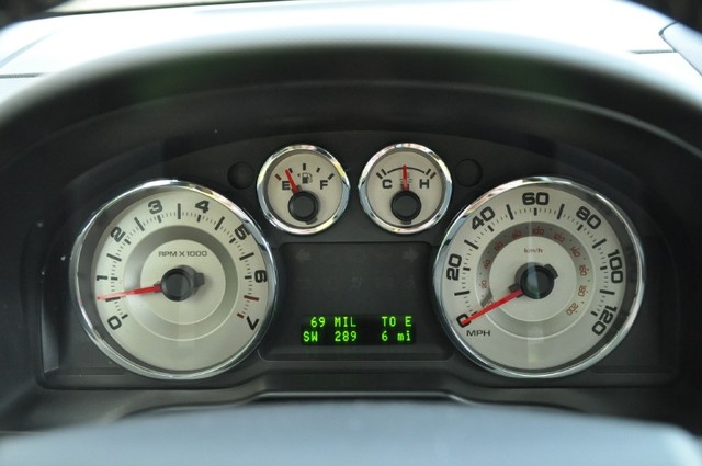

Franklee Posted September 9, 2010 Report Share Posted September 9, 2010 (edited) Do you have a before picture? I have the black gauges in my '10 and do not like them at all. There have been several complaints to the NHTSA regarding difficulty viewing the gauges. Edited September 9, 2010 by Franklee Quote Link to comment Share on other sites More sharing options...
er65nsunny Posted September 9, 2010 Author Report Share Posted September 9, 2010 (edited) The silver gauge face is extremely difficult to see in certain lighting conditions, where the black is much easier to see. Edited September 9, 2010 by er65nsunny Quote Link to comment Share on other sites More sharing options...
