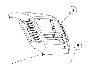

erock9174 Posted September 21, 2010 Report Share Posted September 21, 2010 (edited) However to do a sat radio install the large bezel in the center of the dash just pops off. it may be a little tough if its never been removed before. all the wires needed are right behind the radio. 3 questions: 1) The large bezel you mention....I assume this is the panel we are talking about (see attached) ? 2) Do you have to remove any other panels first before this panel comes off ? I had all Honda's before my Edge and in order to get to the radio it always required removing nearly half the dash to get the radio panel off. What a pain they were to work on. I just need to hide to some wires behind the radio panel and was hoping this was the only thing that needed to be removed. 3) Any tips on removing this panel (i.e. where to grab it from...or should I use a trim removal tool and where to stick it first) ? Edited September 21, 2010 by erock9174 Quote Link to comment Share on other sites More sharing options...
GrantA Posted September 21, 2010 Report Share Posted September 21, 2010 erock9174- the center panel pops off without taking anything else loose. The first time I did it I used a plastic prybar along the edges but now I can just grab the lower edges and yank back on it. I find it best to pop the bottom loose first and work up the sides. Set the parking brake and pull the shifter back to give yourself some extra room to rest the panel once it's loose (since wires will still be hooked up to the back side). Quote Link to comment Share on other sites More sharing options...
