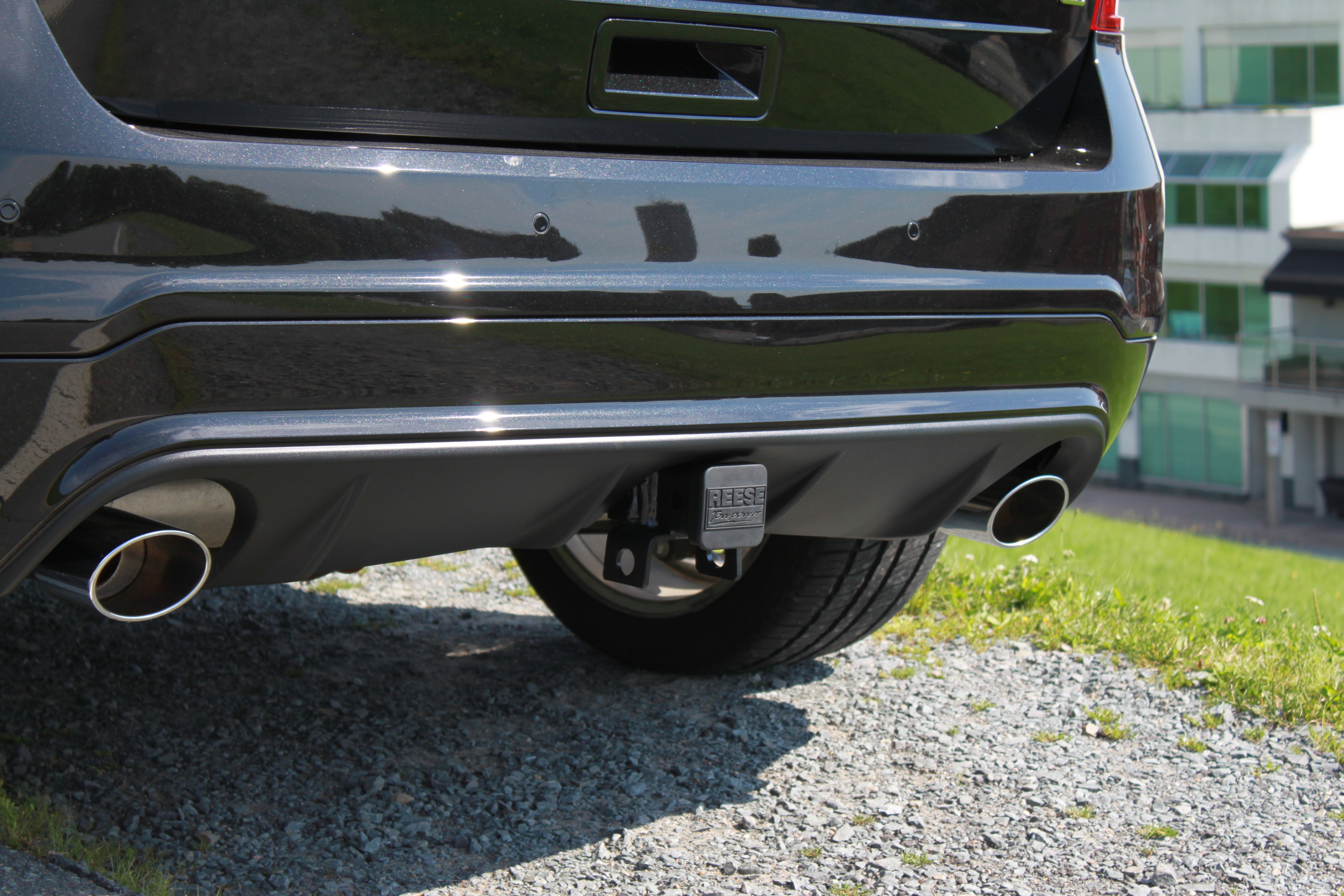

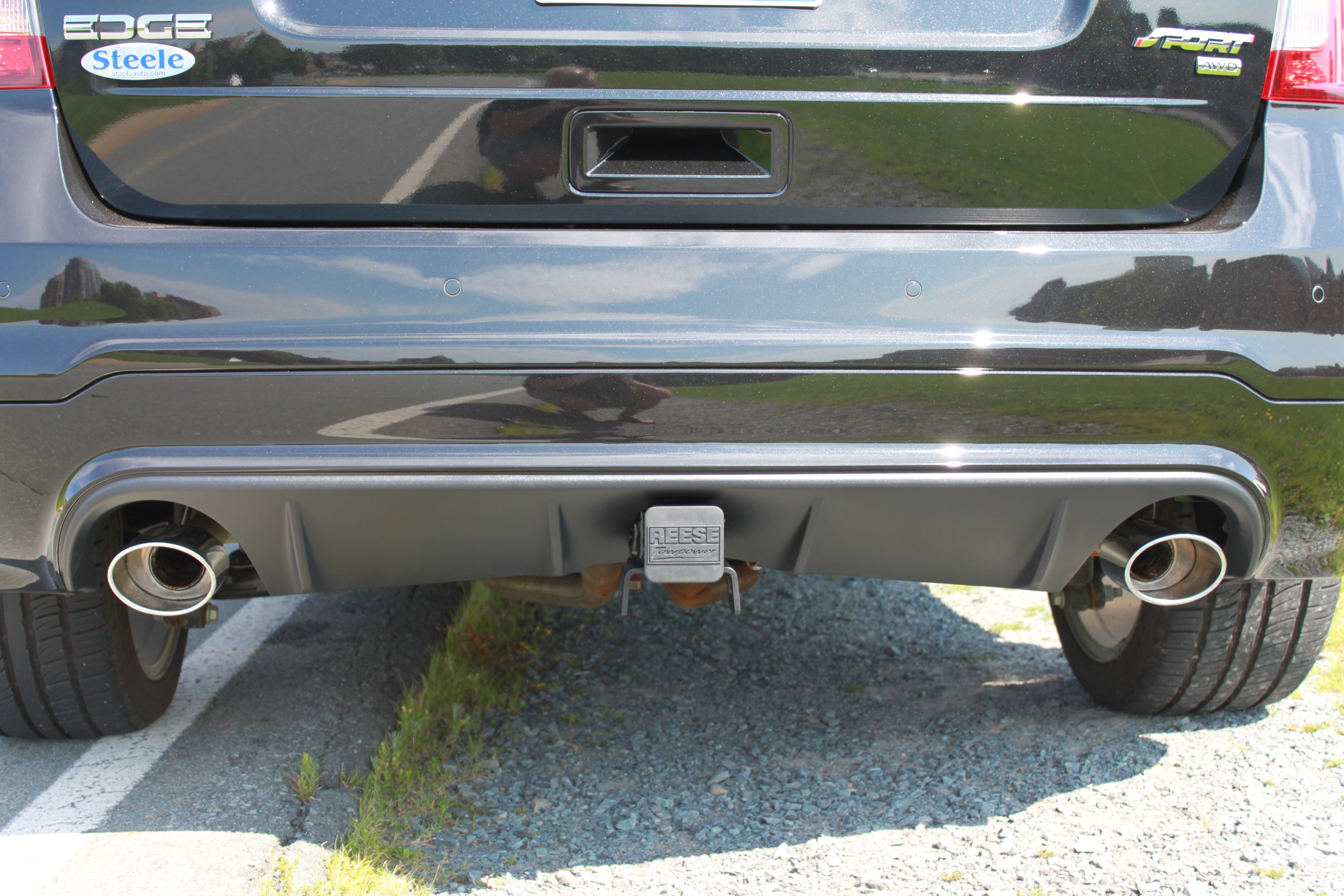

Naverino Posted March 22, 2011 Report Share Posted March 22, 2011 (edited) Hey guys, I found these pics on google that someone posted. This person has the 2011 Sport with a hitch on it and it looks amazing! (mind you looks like there was some cutting involved but can't fully be sure in the pics) If this is anyones ride on the forum please lets us know where to get this hitch! Edited March 22, 2011 by Naverino Quote Link to comment Share on other sites More sharing options...
wilsons66604 Posted March 23, 2011 Report Share Posted March 23, 2011 I don't care for this. If you look in the first picture, you can see the cutout for the wings on the hitch. (Where the safety chains would hook up) I want something that looks cleaner. I am still searching for a resolution without cutting or welding. Jeez. Go to U-Haul and get a strap on model. or, do like I did. I opted for the Limited with factory tow package Quote Link to comment Share on other sites More sharing options...

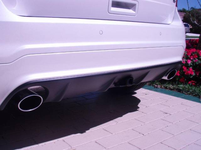

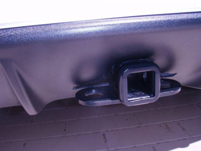

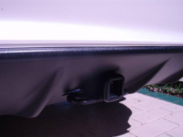

My Toy 2011 Edge Sport Posted August 15, 2011 Report Share Posted August 15, 2011 Just had my hitch installed. I had included as part of the purchase price (purchased my Sport in Nov/10, dealer just installed last week). Looks great.... some pic's attached. Ford parts and installed. Part BT4Z-19D520-A and &T4Z-15A416-B Hitch/Harness Quote Link to comment Share on other sites More sharing options...
