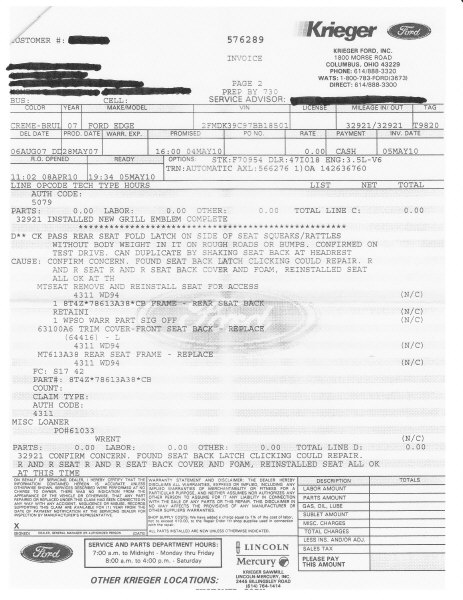

Lowell Posted July 23, 2010 Report Share Posted July 23, 2010 (edited) I have a 09 Limited AWD Edge. Has anyone else had a problem with a loud rattling/clicking noise coming from the backseat area? It's coming from the left side of the backseat and tends to occur most often while going over bumps or when braking. Some days it's loud and other days it's nonexistent. On the days it can be heard, I can actually reproduce the sound (less audible version) by grabbing the top of the backseat and shaking it back and forth. I've taken it to my local dealer twice already and they haven't been able to figure it out. It's driving me crazy. Any suggestions or ideas? Thanks Please let me know if you receive this attachment Service Order written for similiar problem on right rear (psgr side). This certainly corrected the problem.No more rattle thanks for a great dealer service dept. correction to attachment -------------------------------------------------------------------------------- -------------------------------------------------------------------------------- Edited July 23, 2010 by Lowell Quote Link to comment Share on other sites More sharing options...
