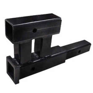

Lex Talionis Posted June 12, 2010 Report Share Posted June 12, 2010 (edited) install the after market hitch, like a Curt (tons of threads on that here with photos, part #, how to's), and then look into something like this IF it even comes close to bottoming out, which I would not likely bet. a dual hitch extension to lift it up Edited June 12, 2010 by Lex Talionis Quote Link to comment Share on other sites More sharing options...
