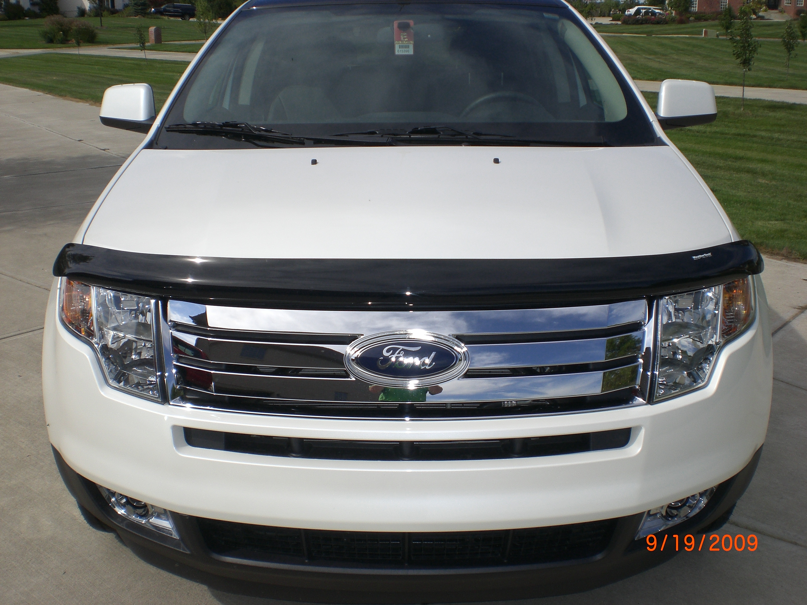

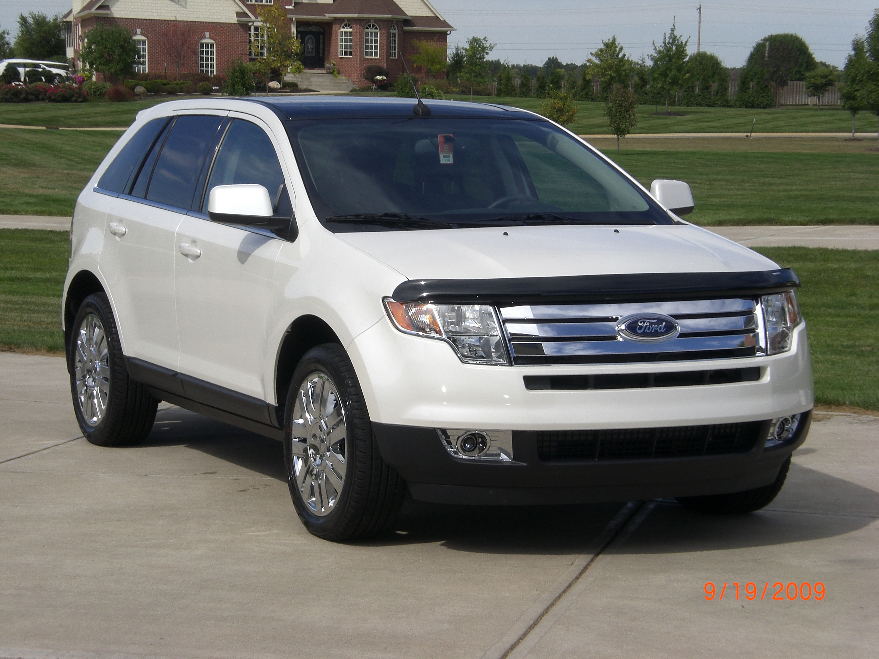

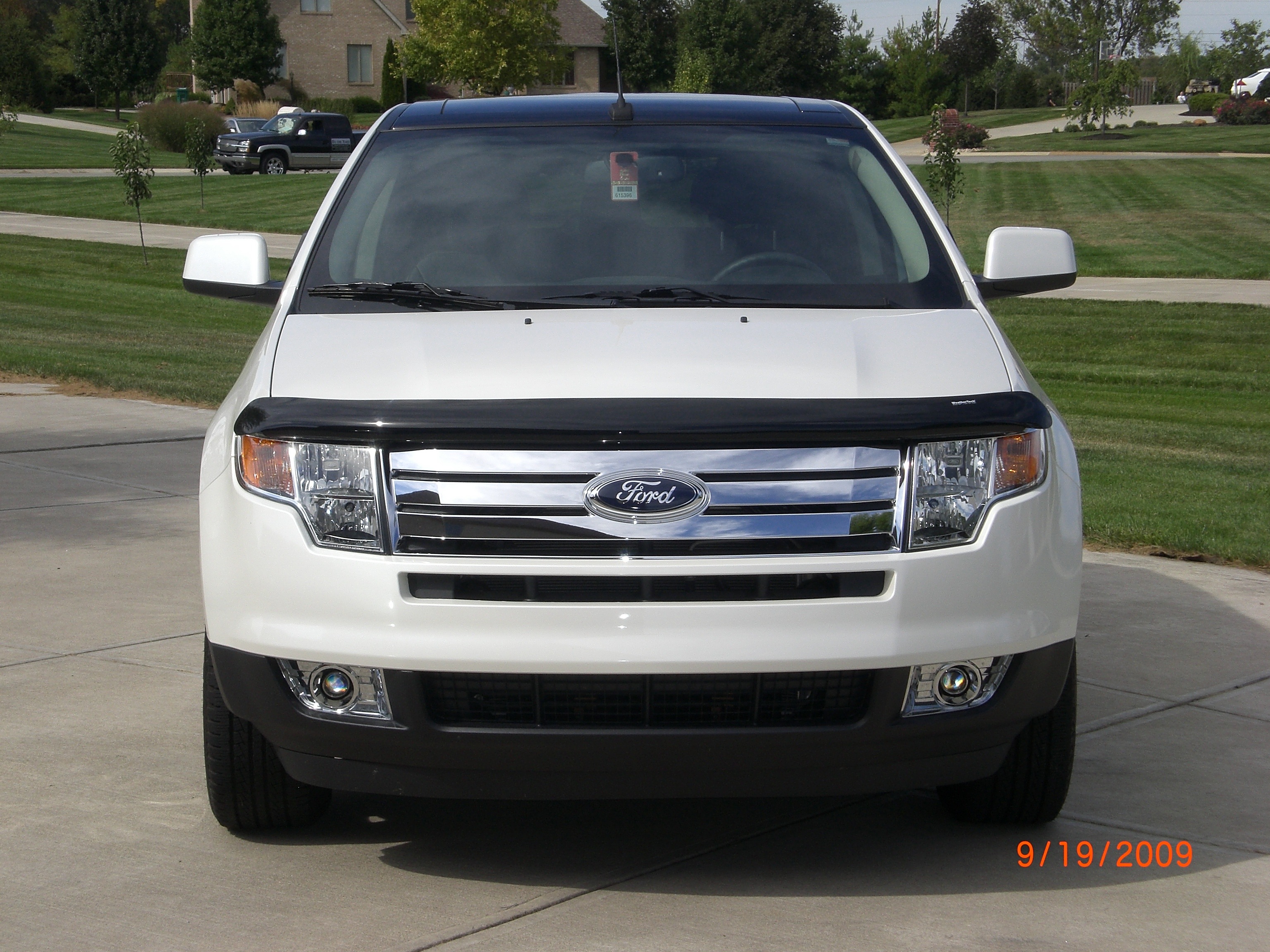

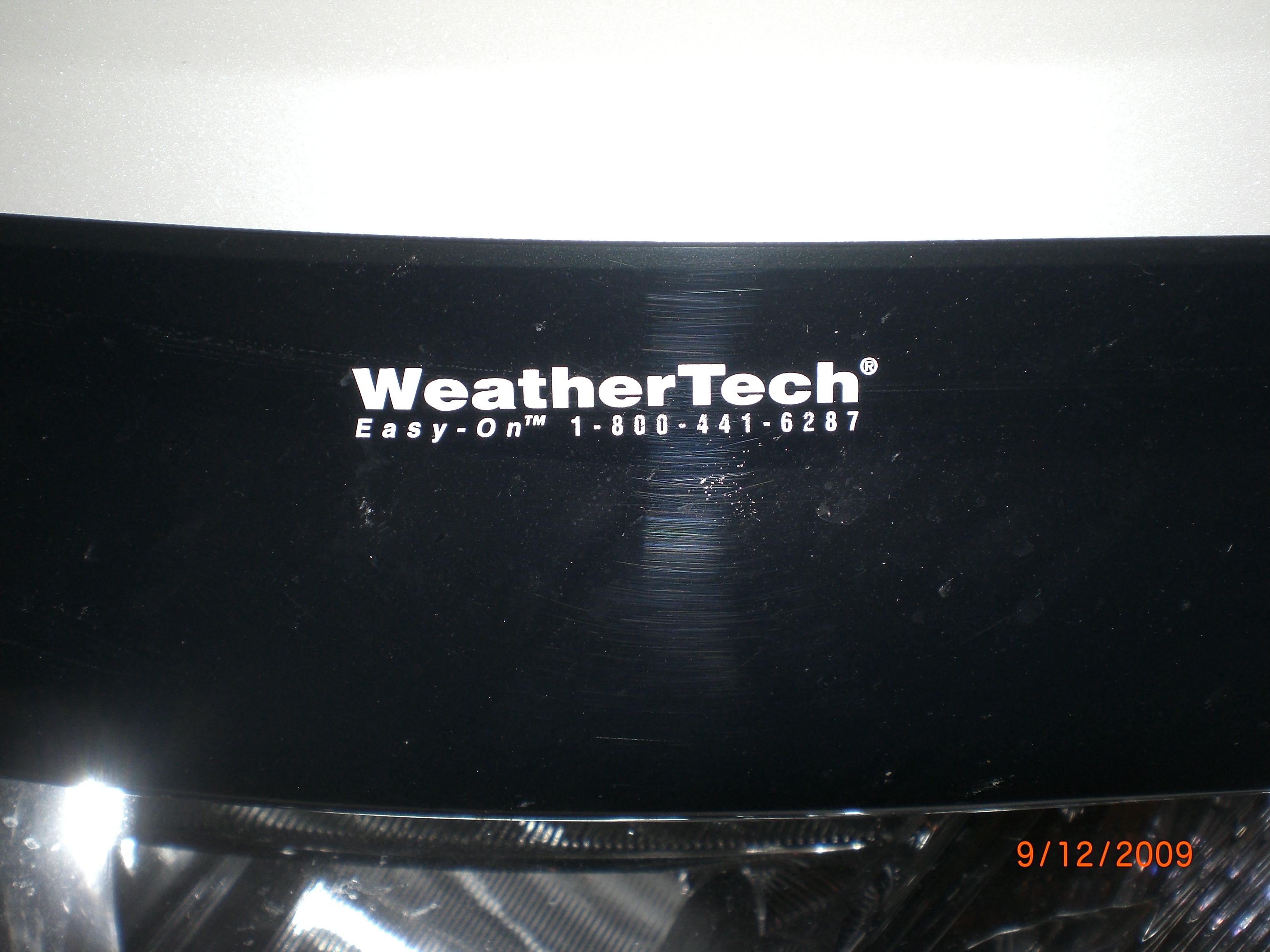

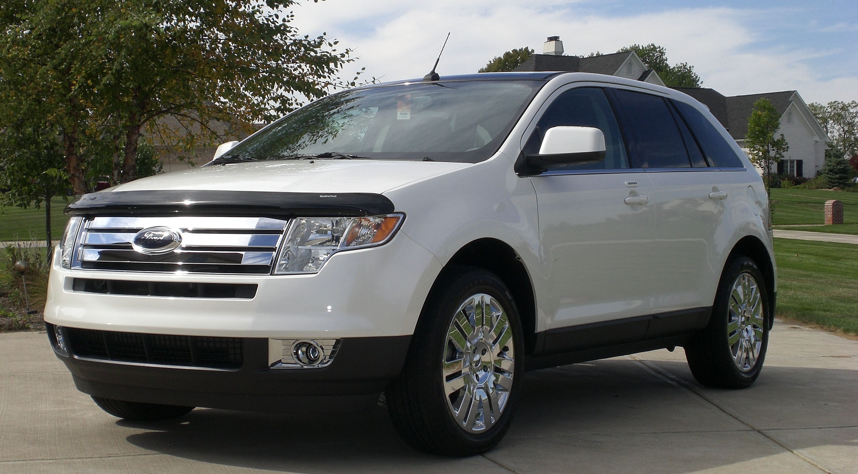

Goldy Posted June 12, 2010 Report Share Posted June 12, 2010 Has anybody installed a hood bug-stone deflector? If so do you get any wind noise from it or any other issues with it. http://www.weathertech.ca/store/mvproduct.aspx?ItemGroupId=5 Thanks Yes...I've installed the Weatherteck deflector on my wife' 2009 Edge, as well as my daughters 2010 Escape. Of all the deflector's I've installed thus far (5 or so), the Weathertech are the highest quality in my opinion...they fit perfectly...easy to center (have a notch/mark on the underside which matches a notch/mark on the hood) and are more pliable than the others (which to me, translates into lasting longer). Here are some pics: Good luck... Quote Link to comment Share on other sites More sharing options...
PW_SuperDude Posted July 20, 2010 Report Share Posted July 20, 2010 Yes...I've installed the Weatherteck deflector on my wife' 2009 Edge, as well as my daughters 2010 Escape. Of all the deflector's I've installed thus far (5 or so), the Weathertech are the highest quality in my opinion...they fit perfectly...easy to center (have a notch/mark on the underside which matches a notch/mark on the hood) and are more pliable than the others (which to me, translates into lasting longer). Here are some pics: Good luck... That looks really sharp! Question: When I looked into this product in the Weathertech catalogue (came in the box when I bought the laser-fit trunk liner for both vehicles - awesome products!), it said in the description that no drilling was necessary as it used the factory holes. In the instructions, however, it said to use self-tapping screws to pierce the underside of the hood assembly. Which is it? Do you need to make new holes or no? How hard was it to install? Quote Link to comment Share on other sites More sharing options...

Goldy Posted July 26, 2010 Report Share Posted July 26, 2010 That looks really sharp! Question: When I looked into this product in the Weathertech catalogue (came in the box when I bought the laser-fit trunk liner for both vehicles - awesome products!), it said in the description that no drilling was necessary as it used the factory holes. In the instructions, however, it said to use self-tapping screws to pierce the underside of the hood assembly. Which is it? Do you need to make new holes or no? How hard was it to install? Hi PW... I read the same thing, and I interpreted the instructions to mean you didn't have to use the screws; you could only use the two sided tape to hold the bug shield in place. (I didn't like that idea). I may have read the instructions wrong...it's been a while. In any event, drilling the pilot holes for the screws was not a big deal...very easy to do. I'd offer to use a 'punch' (if I'm referring to it correctly) to mark the spot to drill...this will also keep the drill bit from 'walking'. Be sure to use a drill bit which is somewhat smaller than the screw...you can always make the hole bigger, but can't make it smaller. I'd also offer to put a stop on the drill bit to make certain the bit doesn't go too far in...to deep...when drilling. I used a piece of old hose I had laying around...I cut it to a length that when placed over the drill bit, it only allowed for a small portion of the bit (1/4 inch or so) to be exposed. Hope this makes sense... Good luck. Quote Link to comment Share on other sites More sharing options...
