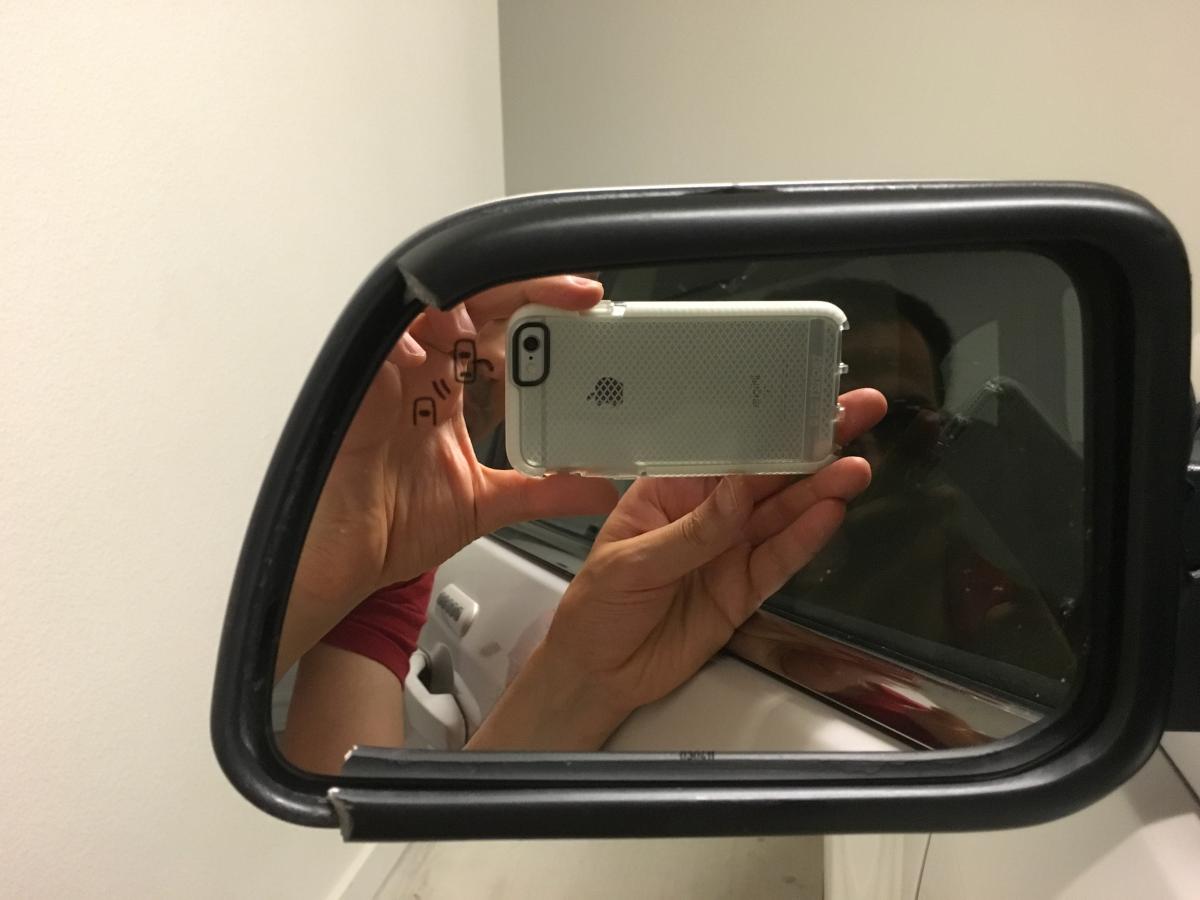

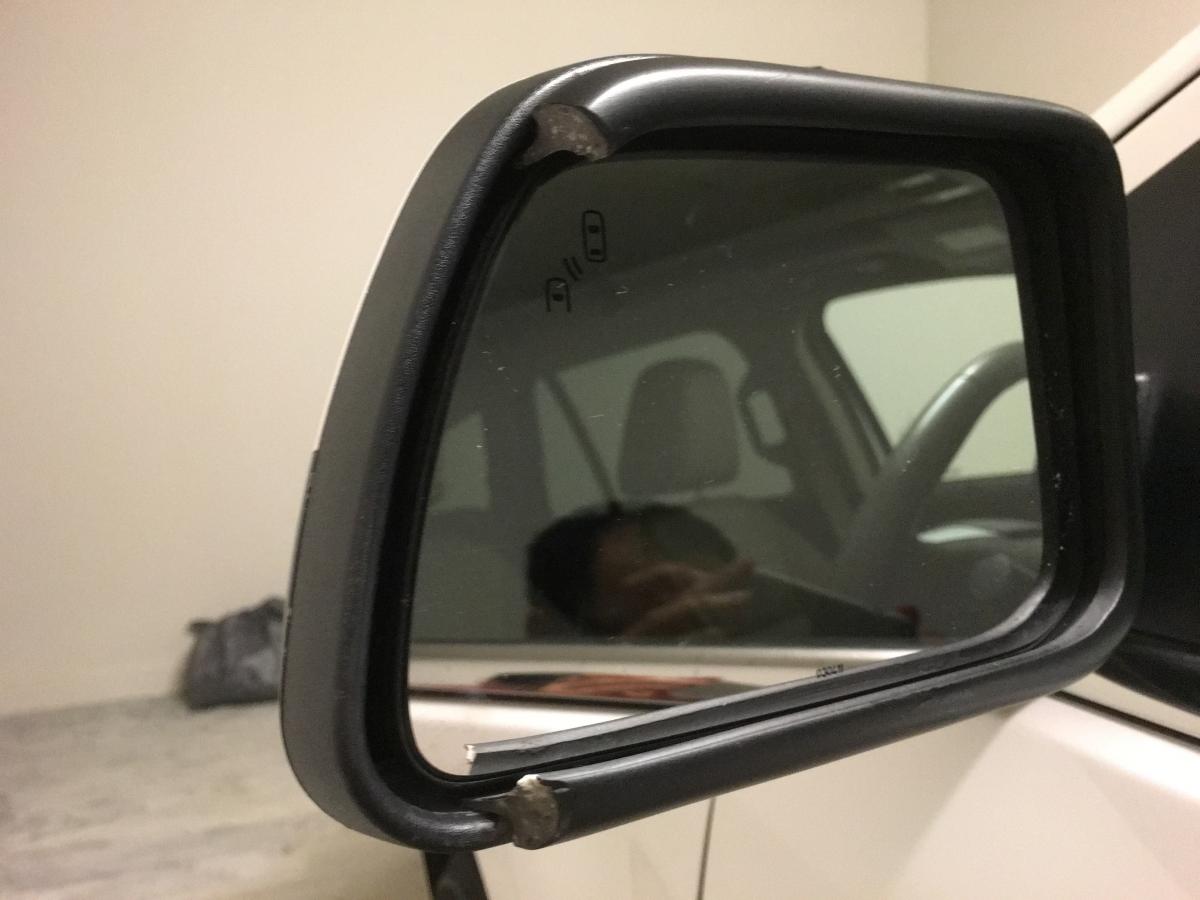

Dborg1956 Posted April 14, 2016 Report Share Posted April 14, 2016 I looking for a video to replace the drivers side mirror and the trim around it on my 2013 Edge SEL. I have searched thru the post but do not see a detailed video for doing this repair. In particular how to remove the mirror. Please see attached pic. Thx Quote Link to comment Share on other sites More sharing options...
tpm419419 Posted April 14, 2016 Report Share Posted April 14, 2016 I think that trim piece is actually part of the entire cover. There is another posting in detail as how to remove the glass. Actually very simple. But you need to search for the remove mirror glass posting as it will have pictures. The glass sits on a round motorized base with 4 prongs. Each prong is a double prong so eight. Get a medium or narrow flat head screwdriver between those two prongs that sit about 1/4" apart and twist the screwdriver to pop up the glass. Will need to do it in 3 places Hope it helps Quote Link to comment Share on other sites More sharing options...
tpm419419 Posted April 14, 2016 Report Share Posted April 14, 2016 The screwdriver needs to be between the mirror glass and motor platform. Like I said. Search for the pictures Quote Link to comment Share on other sites More sharing options...

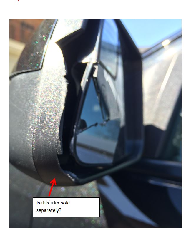

Jim70Houston Posted May 19, 2016 Report Share Posted May 19, 2016 My break isn't nearly as bad a Dborg1956, but I have a similar problem. I need just the piece that appears to be a separate trim piece. The dealer says I have to buy a complete mirror assembly for $400+. If it is not available, I'm wondering about gently removing the rest of the trim. The edge of the mirror casing is nicely finished. I'm not sure the purpose of these glued on trim pieces. Quote Link to comment Share on other sites More sharing options...
tpm419419 Posted May 19, 2016 Report Share Posted May 19, 2016 Try a salvage yard and experiment on the old one first Quote Link to comment Share on other sites More sharing options...
