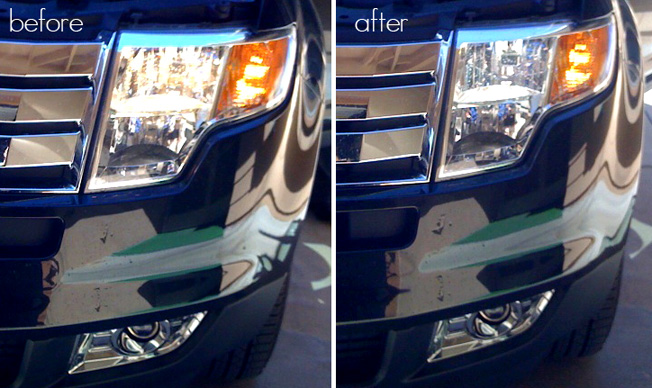

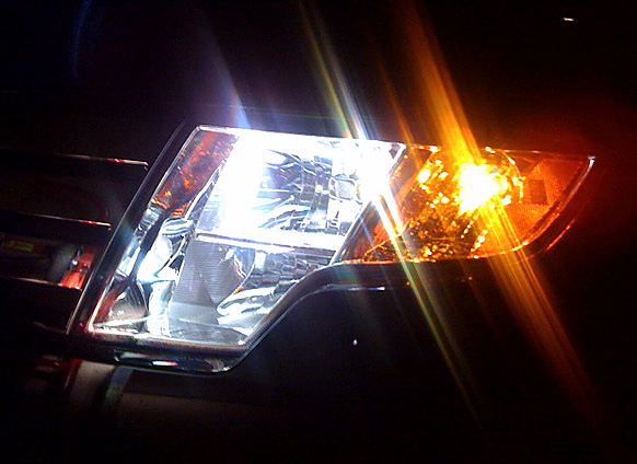

sirteman Posted May 4, 2010 Report Share Posted May 4, 2010 On 3/16/2010 at 8:07 PM, chloe13 said: Thank you drgnhurt! Much appreciated. Feel kind of dumb now, that is one very small yet important step my book failed to mention needed to be done first. Trying to undo both clips on the harness with one hand is kind of tricky huh? I was able to get my driver's side done in less than 5 minutes, we'll see how long the passenger side takes... Hi, Just curious on what type and make you got for the bulbs you used, it looks great on the photos you posted. Have you replaced your fog lights too and it would be nice to see them too. Great job.. Quote Link to comment Share on other sites More sharing options...

chloe13 Posted May 18, 2010 Author Report Share Posted May 18, 2010 (edited) Thank you Picturepro, I agree about the 'stealership' not really being my friend after all! At least not after I already bought the car huh... That day after getting home from the dealer, I ended up changing both of the fogs myself :shades: (This is a big accomplishment coming from a 22 year old female that knows NOTHING about cars) Thank god for teeny hands, I was able to change both the driver side and passenger side fog lights from the hood and didn't need to use a single tool (also good because I don't own any!) sirteman, I used Luminics bulbs in "Titanium white" H11s for my low beams. The website I ordered them from includes a one year warranty on all bulbs (luminicsbulbs.com) I really love them so far, looks a million times better than stock! Had them in for a few months no problems. My dad got the same ones for his 08 Mustang with good results as well. I used the "Ultra Violet" H11s for my fogs and they do look much better than stock bulbs, but they're not really the kind of purple I was hoping for. They suggested I use their Krypton series bulbs for more color if that's what you're looking for. Will take pics tonight of the fogs too. Hope that helps! On 5/15/2010 at 6:06 PM, Picturepro said: I just changed my Driving light bulbs. (silverstar H11) Great change in my wallet for $40, little change in light. When I disconnected the stock bulb BOTH were broken (NOT BY ME) they worked just would have failed sometime soon Access them from the underside of the car. 7/32 socket and 3 screws on each side simple process. If you are not happy with the level of light you might bring it up a couple degrees also done from underside with a torks bit T15 one single screw from the right side If the Stealership wants a $100 they are NOT your friend. Total job start to finish was 25 minutes I drove and adjusted my lights several times, that took the time if anyone is in So Cal (949) I'm Willing to help if needed, buy me Carls Jr dinner. not offing a install service just willing to help people GL Edited May 18, 2010 by chloe13 Quote Link to comment Share on other sites More sharing options...
