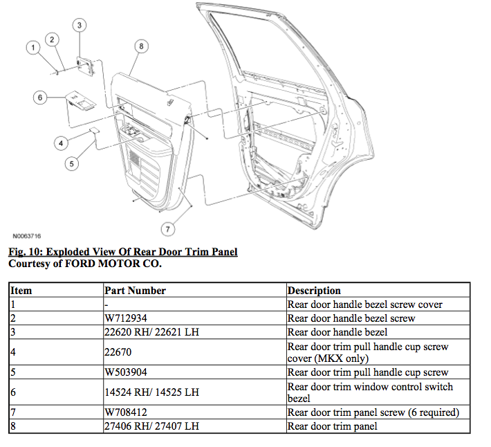

Can someone explain how to remove the rear passenger door panel? I found the 5-6 screws around the outer edge, and I see that it has a few clips that you can pop it out of at the bottom... but I'm not sure what's holding it on at the top and I'm a bit afraid to just pull at this point. Do I need to/should I remove the torax screw under the door handle itself? Are there more clips/screws I need to know about at this point, or is it just a matter of pulling hard enough and/or the right direction?
I just bought the car and it came with a blown speaker... so I just want to get in there to replace it. Any tips?

Hi MKX. :D Don't have the shop manual handy for the 2007 MKX. But off the top of my head I would say that yes, you need to remove the screw under the door handle. And after removing all fasteners, most door panels usually have a top lip that needs to be lifted out of the window channel before pulling outward.

1. To Remove the rear door handle bezel:
  • A. Remove the screw cover.
  • B. Remove the screw.
  • C. Remove the rear door handle bezel.
  • D. Disconnect the electrical connector [if equipped]
2. Remove the screw cover.
3. Remove the screw.
4. Remove the 6 trim panel screws.
5. Disengage the bottom of the door trim panel from the door.
  • A. Pull outward to disengage the push nuts from the retainers.
6. Lift the top of the door trim panel edge upward and out of the beltline molding.
7. Pull the lock rod through the lock rod grommet.
8. Remove the rear door trim panel.
A. Disconnect the electrical connectors.
9. To install, reverse the removal procedure.
Hope this helps

I found the image of an interior MKX door panel on E-Bay which illustrated the side that faced the mechanicals. This was helpful in locating the two grommets on near the lower corners.
One key point not mentioned here is that there is a small hex screw located below a plastic cover located at he bottom of the "grab handle well" used when closing the door. This hex screw must be removed prior to removing the panel.
I also note that the plastic bezel around the door handle (which also houses the small tweeter speaker) is difficult to remove prior to removing the panel. Once the door panel is removed, you should remove this bezel prior to replacing the panel once the door handle repairs have been completed. The reason for this is that the re-attaching of the door panel is difficult if this bezel is not removed, due to the fact that you have to slip the door handle through the hole and it does not leave you enough play to get the top of the door panel over the lip to secure it.
Once the bezel was removed, it was quite easy to attach the panel. After the panel was installed, it is very easy to snap the bezel into place.
