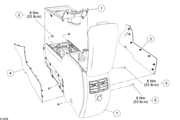

k_m Posted January 19, 2010 Report Share Posted January 19, 2010 Long time, no posting for me! I love my 2008 Edge, it's a great car. I need to pull out the center floor console, I took out a number of bolts and it doesn't move. I would appreciate help on this, as I need it out by tomorrow evening. Thank you to anyone that can help! Here are the procedures I have: 1. Remove the storage bin. 2. Remove the 2 scrivets. 3. Disconnect the power point electrical connector. 4. Remove the 2 floor console front side bolts. 5. Remove the 2 floor console-to-instrument panel bolts. 6. Disconnect the floor console electrical connector from the lower right front wiring harness. 7. Remove the floor console. 8. To install, reverse the removal procedure Also see attached diagram Hope this helps Quote Link to comment Share on other sites More sharing options...

SimplyBao Posted February 15, 2010 Report Share Posted February 15, 2010 My first post!!! I just got my '08 SEL the other day and there is something rattling inside the center console. I wanted to remove the cup holders to see if I could see anything. Can I just pull up on it and it will come loose? In the picture, it's #1....thanks for your help! Quote Link to comment Share on other sites More sharing options...
k_m Posted February 15, 2010 Report Share Posted February 15, 2010 My first post!!! I just got my '08 SEL the other day and there is something rattling inside the center console. I wanted to remove the cup holders to see if I could see anything. Can I just pull up on it and it will come loose? In the picture, it's #1....thanks for your help! I believe so, but not entirely sure. I have never removed it, but by the way it looks its only held into the unit by clip hooks. I would be very gentle and try to ease it out. Good Luck Quote Link to comment Share on other sites More sharing options...
SimplyBao Posted February 17, 2010 Report Share Posted February 17, 2010 I believe so, but not entirely sure. I have never removed it, but by the way it looks its only held into the unit by clip hooks. I would be very gentle and try to ease it out. Good Luck Thanks for the reply. I figured it out. And yes, it does just pull up. Quote Link to comment Share on other sites More sharing options...
